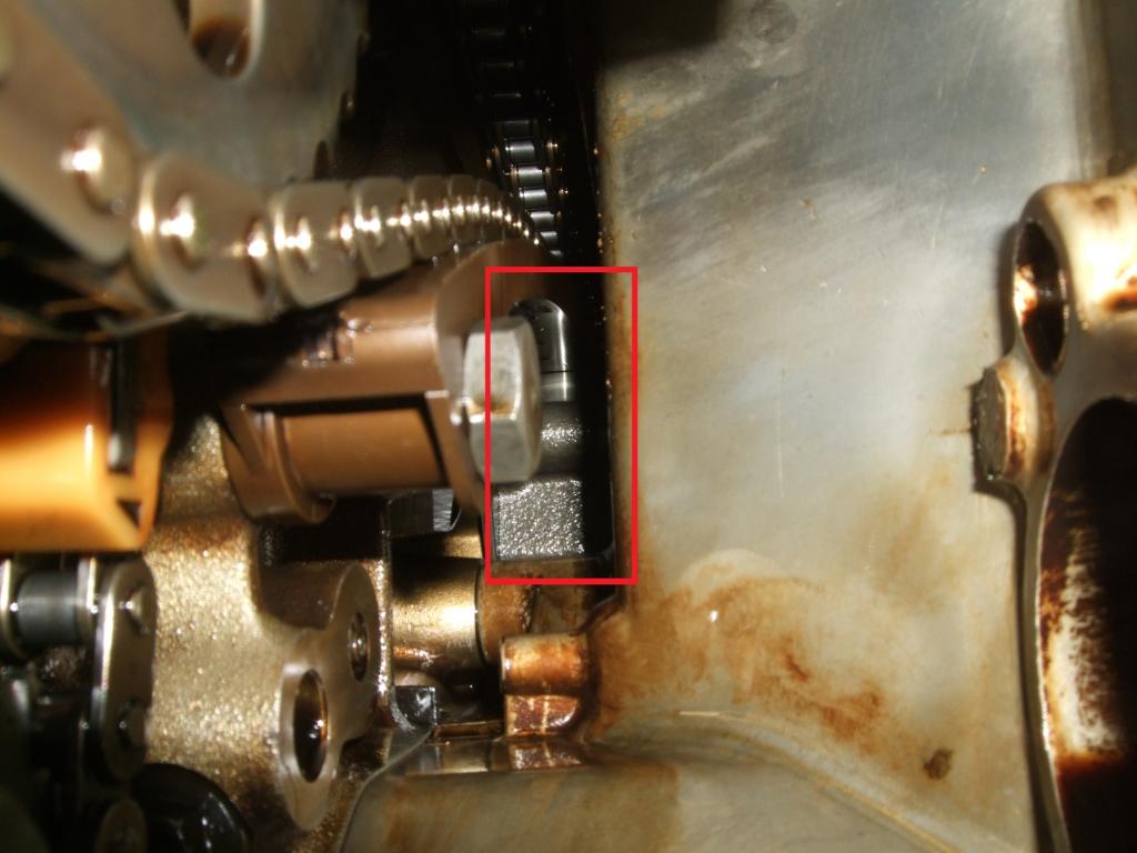

Hi. I recently purchased a 1998 X308 XJR and have some questions regarding the tensioners. I bought the car pretty much unseen and after collecting it I took it for a few local drives to see how it drove etc.
The car has recently ticked over to 102k and came with several stamps in the service book. I noticed a strange ticking noise at startup and when driving and idling a few days into my ownership. I took the car to a local Jag specialist who had a quick look around and a listen with a mechanics stethescope before diagnosing the noise as the secondary tensioners.
I took the right hand cam cover off this morning to find that I have the 3rd gen tensioners -
I have half asleep at the time and looked at the plastic on the tensioner rather than the body and mistook it for an earlier tensioner. Thankfully someone on another car forum I am on spotted my mistake and told me that I had the 3rd gen tensioners. I looked a little closer with a torch and it seems like I have the 2nd gen lower tensioners fitted too (I have highlighted what I think is the lower tensioner) -
The chains all look fine and there is no slack in them (on the right side anyway, not checked the left side yet) however I still seem to have the original primary tensioner blade instead of this later design. This seems a bit odd, if someone went to the trouble of replacing both sets of tensioners then why not change the blades?
Is it possible to replace the blades themselves without removing the primary tensioners or the chain? The upper primary tensioner guide appears to be a metal one.
Also what else is likely to be the culprit for the ticking noise? I've read that someone had a loose spark plug which was causing a similar noise so I'll be checking mine tomorrow morning when I fit the right hand side cam cover back on. Anything else to check?
Thanks
Attached Thumbnails Tensioner Query-2c08cb3b-95b8-42a7-9102-139d2efba9eb-8972-000003c22f3bc47d_zps2dd1ae47.jpg   Tensioner Query-dscf3338_zps428373f3.jpg

Replacing the primary tensioner blades is a big job as they can't just be pulled out from the top. It's hard to second-guess the previous owner's motives for not fitting new primary tensioner blades whilst appearing to have done the primary tensioners-maybe he (or she) thought that they were in good enough condition not to replace.

Welcome to the forum. A cautionary note: there have been reports of cars with only one secondary tensioner replaced.

Thanks for the replies folks. The blade has no signs of cracks etc so looks fine, sent the pics off to a specialist who agrees. Bolted everything back together and fired her up, to me it sounds like the squeaking noise is coming from a belt and not the tensioners. Took the plugs out, well the first 3 on each bank as my tool was too big to access the 4th plug on both sides. There was some oil on a few of the plugs so having the seals changed, and a full service since the car is new to me. Then I can look into replacing the winter tyres for some summer ones and only then can I start to have some fun behind the wheel!
