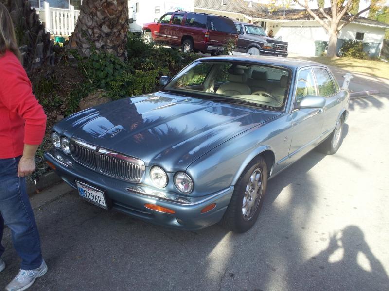

Default Woo hooo , has the upgrades by 3 days
It was made 3 days after the updates started!!
Originally Posted by test point
To add a note to what Sean posted, my 2002 was built in June '01 and had the plastic tensioners, since replaced. I don't know about the XJ series but my XK has a label on the driver door 'B' column with the manufacturer date. As Sean said, if it is after August there is an excellent, but not guaranteed, chance that the tensioners are the later metal ones. If it shows August or you want to be certain you need to ask a Jaguar dealer to determine the engine serial number from the VIN. The serial number encodes the manufacture date of the engine. August 13, 2001 is the conversion date you are looking for. That would produce a serial number of 010813xxxx (YYMMDDHHMM) or later.
Or you could pull a valve cover and visually verify that the metal ones are there.
Sounds like you may have found a jewel! Post pictures.
So this one was manufactured LL010815xxx so it was the 3rd day of the upgrade !! How happy am I?!!
Thank you for the info
. . . and welcome to the forum!

Beautiful car! 36k miles, congratulations!
One other thought; is those are original tires they need to be replaced tread or not. They are now 10.5 years old and you never know when you might drift up to the upper end of the speedometer out of pure pleasure.
