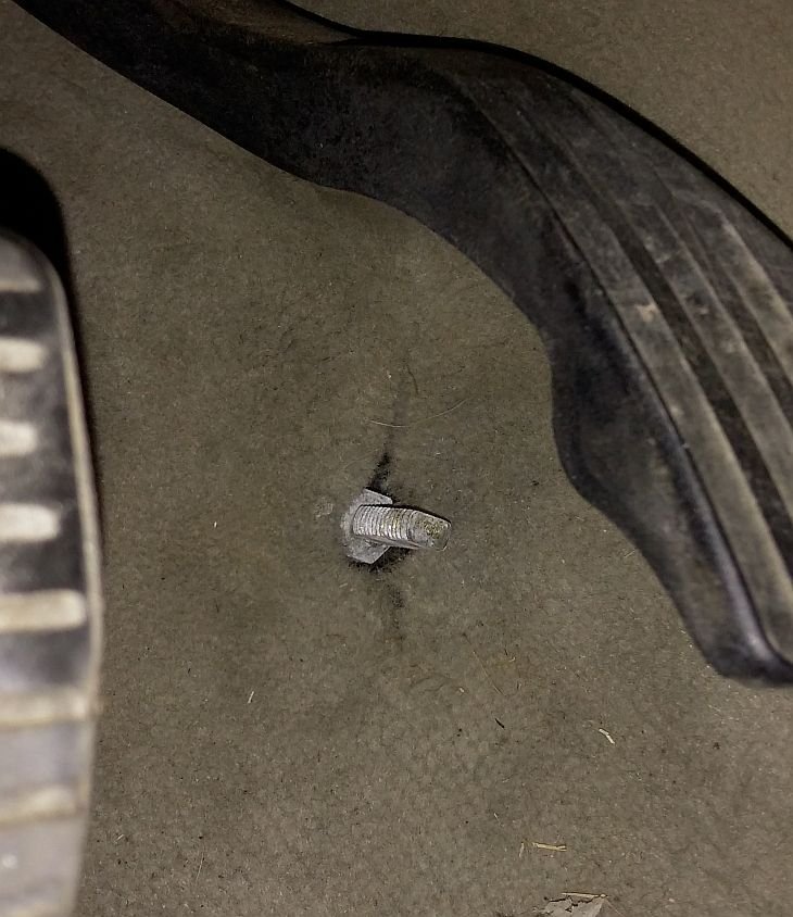

I never noticed anything under the throttle before. I just had a look. There is a flattened, threaded object sticking out from the floorboard, but no switch. I'm gonna go and take a picture of it and post it. Gimme 5 minutes...lol.

so, does this look normal?

Maybe not, the earlier XJ8's were delivered with a stop, not a switch.
From your picture it looks to me you are missing the stop, its not the switch.
I might be wrong here though, you can check if there is a connector hidden under the carpet.
Hey Eric,
What's not the switch? The threaded post? Does your VDP have a switch?
I don't understand. What is the purpose of the "stop"? Did this stop mount on the threaded post that currently exists? If a kickdown switch was not provided in the earlier XJ8's, how did the kickdown function get activated? Did it get activated at all?
I checked the travel of the throttle pedal. It does not go down as far as the threaded post. There is a gap of about 3/4". Also, I pulled the carpet away to look for a connector. There isn't one. Roughly where was the connector located? Perhaps I was looking in the wrong place.
On the parts database, there is a kickdown switch, PN: LJC6570AA, listed for my VIN, from VIN 853936. Also, the parts database does list a "Switch mounting stud" I presume the mounting stud provides the negative terminal of the switch. The wire coming from the switch must connect to the wiring harness somewhere. Activating (closing) the switch must ground a 12V signal line to activate the kickdown. If not for the fact that the switch needs to be adjusted and must engage only at the correct moment, any momentary switch could provide the function; even one mounted on the steering wheel.
Now, even though the switch is listed on the parts database, they are just not available anywhere any longer. Maybe in some junk yard, somewhere...
Anyone got one to sell to me?

Sorry, I was a bit in a hurry in the last post.
What you see is the threaded stud, which is used for adjustment (will get back to that).
On that stud, there is either the kick down switch (with 2 wires), or just a stop (without wires).
There is some confusion on which model years / models have the stop, and which the switch.
I have tried to find this info myself, but even Jaguar instruction manuals are not clear on this.
My guess is 1998 XJ8 models, maybe into 1999 XJ8 models as well.
An other theory might be that the AJ26 engine had the stop, the later AJ27 had the switch.
On the XJR I am even less sure, maybe the same, maybe those were supplied with switches from the beginning.
Again, mostly speculation from my side.
One thing I know for sure though, my 1998 XJ8 VDP has the stop, and does the kick-down as it is supposed to do.
You will have to pull the carpet up around the stud, if you pull it from under the center consul, you can create some leeway, but it remains tight.
The switch has a relative short wire, but of course that cable could be anywhere by now.
Maybe someone with a switch knows where it comes from, I guess from the pedal are but I am not sure.
Then on the adjustment:
The common advice is to adjust the cable at the throttle body, but that is only half of the story.
You actually will first need to give the cable a certain amount of slack.
Then you will need to adjust that stop / switch in such way (turning in or out on the stud), that the TB valve opens 90 percent while the accelerator pedal just touches the stop / switch.
You can check this with any OBD2 software like Torque Pro.
There are some other conditions while doing this, like a cold engine, there is a Jaguar instruction sheet, I will look that up and post later.
So in your case, it might very well be that your cable is far too tight, hence the gap while fully pushed.

This is an extract from the manual, it is for the XJR with a switch, but I used the same procedure for my XJ8 with a stop.
Jaguar Workshop Manuals > XJR (X308) V8-4.0L SC (AJ26) (1998) > Transmission and Drivetrain > Automatic Transmission/Transaxle > Downshift Switch, A/T > Component Information > Adjustments
So first set the cable free play at the TB,
Then measure the TB valve opening with OBD2 software,
Aim for 90% when pushed against the stop / switch.
I did all with a cold engine.
Note: If you will need to use the switch, disconnect the connector every time you need to turn it to adjust.
The wires are very fragile.
