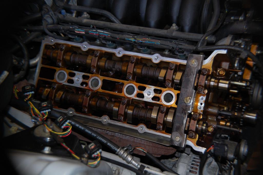

I started pulling down my XJ8 a few weeks ago. Was pretty sure I had tensioner issues, but wanted to get into it before I ordered parts. Ended up I got a full timing kit, waterpump, thermostat, timing chain cover, new plugs, new serpentine belt and new expansion tank hose. I'm waiting on the expansion tank hose now but wanted to post a few pics of the progress. L to R Diving in - In Progress - Wrapping up

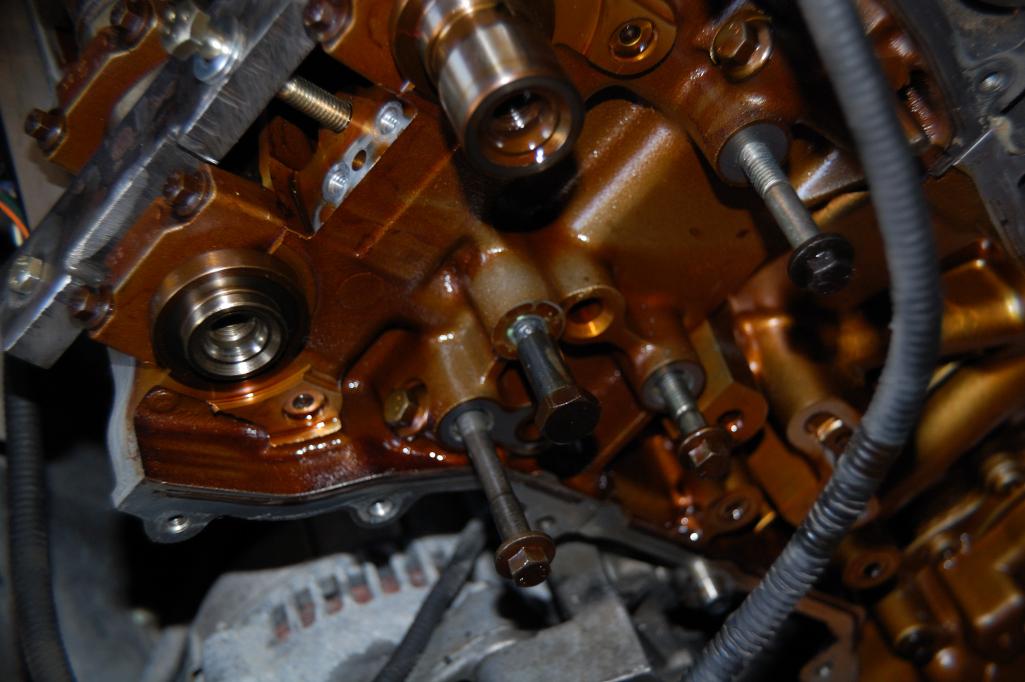

130 k. Thanks for the complements, but most of the credit goes to all the forum members. I found the step by step (Blackonyx) directions searching on here, learned all about the faulty first gen. tensioners, waterpump etc. from forum posts. I did find an outside source for troubleshooting the ABS/TRAC unavailable issue, but have tried to provide as much insight as I could as I've worked my way through getting that fixed. I picked up the XJ8 in October, and she ran like a clock, wife took it on a road trip from TX to VA and back after the first of the year. I noticed the tell tale failing tensioner knock when she got back. I just wish I knew how many miles she drove once they really started to go. I plan on getting some good detail shots of the failures in the tensioners and posting them in a few days. Other than the tensioners, I was amazed how clean the motor was when I got her pulled down.

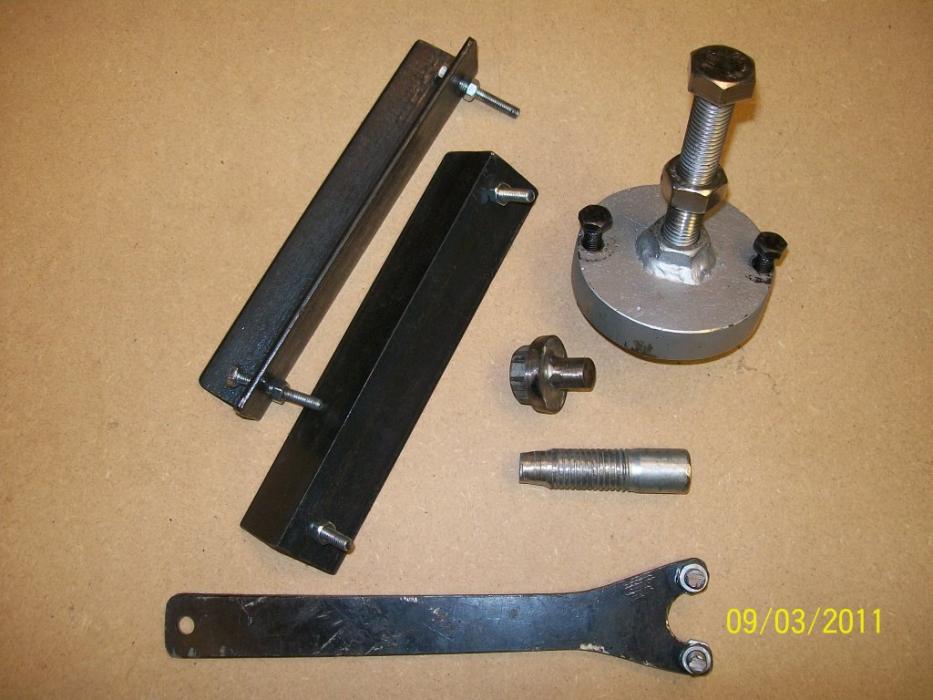

It looks like you used your own make shift cam locking tool. I have access to welding machines and machining tools and kinda hoped to make my own. If you did make it, please let me know how you did it. I would love to know.

@JagScott Pic shows my home made tools I used for my tensioner job
a couple of weeks ago, nothing special needed if you have access to a machine shop, I posted some other pics in Chains,Tensioners and Tools
Yes, a buddy of mine made the tools for me. I gave him specs. for one that I found online but we had to make adjustments to get it to work. Give me a bit and I'll get some specs on what we ended up with posted. We also made a tensioning tool that isn't in any of the pics, that worked great, and I'll get some pics and specs on that as well.
