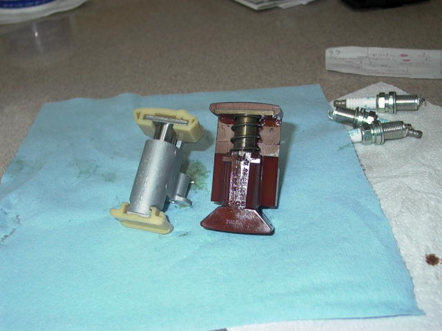

Here's a picture of my old and new secondary tensioners. The old ones are the second generation, they are hydrolic but with a spring. The little push pin keeps the spring compressed so it's easier to get it in there, but don't forget to pull it out.
My bad, your picture is what 98% of the tensioners I've seen researching look like. I finally found the site where I'd seen these. The picture shows something entirely different, but the physical description also looked entirely different as well. They are aftermarket and when I clicked on the item details it took me to a page that indicated the picture was not correct for the item listed. It's no big thing, I did a swap of the drive belt tensioners and pulleys on my BMW back during the summer and researching it, I found that BMW had redesigned the belt tensioner originally installed and changed it from a spring loaded unit to one with a hydraulic cylinder. I also found that BMW at one point had issued a bulletin on it and was automatically swapping out the old units with the new during routine dealer service on the drive belts. I saw this particular item listing and was just wondering if I'd missed something. My understanding is that the current parts available are third generation upgrades to the original all plastic tensioners.
