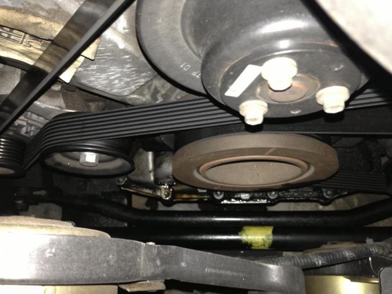

I have an oil leak that I can't track down. I did the valve covers and the oil pan gasket and the oil seems to be coming from above the oil pan gasket, but on the lower front of the engine.
The next move is the timing cover and crank seal, but I noticed the oil looks like it's coming from this little semi-circular thing at the bottom front passenger side of the engine.
Sometimes it'll drip and sometimes it'll leak what looks like a cup worth.
What I want to know is that semi-circular thing something that could leak oil in random spurts? a valve or something? or is it most likely the timing cover gasket?
here's the picture, it's down at the bottom at around 7:00

If I had to hazard a guess (and I do) It looks like your front main seal- it MIGHT be a loose pulley though. You could probably do it insitu with the radiator removed, but may as well do the tensioners and slippers while you are in there. (water pump as well if you are so inclined.)
Check to make sure it the pulley is tightened first, as that is what is sounds like. (lots of oil sometimes, barely a little other times.)

The AJ27 w/ VVT also has a oil temp sender in that vicinity. Both the pressure and temperature switches/senders can leak through the internal seals.
Looking at my engine, it is where the oil cooler pipes go in for a S/C engine- on the NA it is not open, just casting.
Look at this engine for sale- you can see the red plugs blocking the ports:

Thanks dsnyder! Yeah I did in fact get in there with a mirror as well as pull that little plastic piece off the front bumper for a better look before I posted, and it was still hard to tell.

Did you check the tightness of the balancer yet? There is no woodruff key, just a cone washer- so if it starts to get loose, it just keeps getting looser. I had this happen with my XJR.
To check for delamination of the outer ring on the harmonic balancer, make a radial chalk mark across the inner and outer parts. If it moves after driving, it's delaminatated.

You'll get a better view of the front & more space to access things if you take the electric cooling fans & mounting bracket off.
Then completely clean the area around the oil leak with a thin cloth or thick kitchen roll moistened with WD40-work behind the crank pulley as far as you can get to thoroughly clean the oily area.
Then start the engine from cold & let it warm up, and then see if any oil appears as the engine warms up fully & from which direction it's coming from. From your photo it may be the crank seal or the timing cover seal-either way the crank pulley will need to come off.
The engine will be alright to run from cold & warm-up without the electric cooling fans, but watch it doesn't overheat when fully warmed up without the electric fans connected. The X308 temp gauge has a 'dead spot' in the centre where quite a wide variation of engine temp will not cause any change in gauge position-once it does move beyond the centre position then the engine will be hotter than you think, because of this dead-spot in the gauge.
