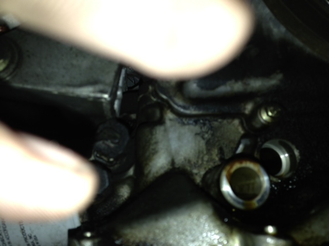

It wasn't the timing cover or balancer. It was the oil cooler block-off plate. There is an oil cooler block off plate on passenger side below the harmonic balancer.
Here is the actual block off peice. There are two little "pipes" held in by this cast piece on the front. This cast piece is held on by a single bolt.
Here is a picture with one "pipe" removed and one installed:

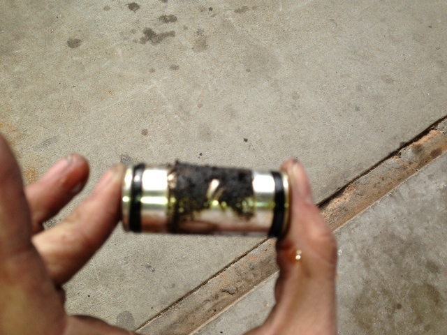

Here is the one of the little pipes - As you can see - the pipe has two O-rings on it. In person, it was clear that they were the source of the leak as the rings were permanently compressed and out of round.
This cost about $8.00 in O-rings and different bolts from a local hardware store. #15 O-rings (4 of them) and a series of different length bolts to basically press the O-rings back into place on the car as they were a very tight fit.
