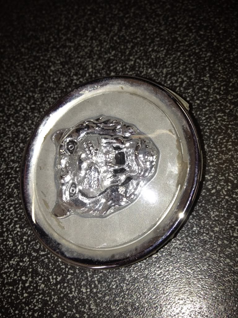

I stopped at a tire shop near my house, told them the front wheels needed balancing and there's a slow leak in the right rear tire. I walked home (three blocks!) and got a call about twenty minutes later telling me that they were done. The right front wheel was off by 1/4 oz, the left front by an ounce and a half, and there was a small screw in the right rear tire. $25 and she now rides as smooth as silk! No need for an alignment and the tires are in good shape. I feel like I won the lottery! LOL
One problem did crop up -- the center cap on the left front wheel was held on with some sticky stuff - looks like one or two (how many should there be?) of the tabs were broken off and the PO stuck it on with some black sticky gooey stuff. I left it off and now want to find a new one or figure out a better way to stick this one back on.

I'm not sure if this is an OEM factory part but I have used this company before: Welsh Enterprises - New Jaguar Parts, Used Jaguar Parts and Accessories - XK120 - XK140 - XK150 - E-Type - MK - XJ6 - XJ8 - XJ - XK8 - XK - XJS - S-Type - X-Type - XF

Thanks! I just placed the order. Will let you know if it works when I get it.

I received the center cap from Welsh - popped right on, looks GREAT! Thanks JaguarsXJR02 for the link to their site.
