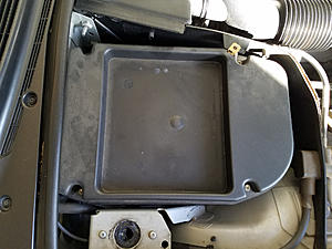

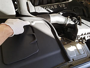

I discovered access is easy. Passenger side engine compartment near windshield. Remove 1 screw (See photo) from plastic engine cover. Pull cover out & up to remove.

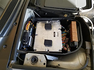

Now see large waterproof box (containing the TCM & ECM)
Remove 4 Torx screws (Mine were fairly loose! But, mechanic had told me he did NOT open box up & look @ TCM) Need T-30 bit. (My top cover stuck as I pulled it up & off.) See photos. TCM is the smaller, vertically mounted box, with the wiring harness on top. The larger ECM is horizontally mounted box. The ECM is just sitting there, in the waterproof outer box, attached by wire harness & easy to rotate up 90 degrees out of the way to access TCM. No need to disconnect ECM wires! In the photo you can see the wiring harness for the TCM with a screw on top. My screw looks partially stripped even though I did not touch it. I am not going to remove my TCM until I have a replacement TCM in hand.
I will post more photos at that time along with any details.

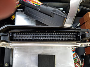

I am not sure exactly how to remove the wiring harness from the TCM. Do I remove that screw? Do I lift up that silver metal bracket? wiggle? pull?
Lady Penelope probably knows. Any tips much appreciated. I dont want to break anything disconnecting the wires.

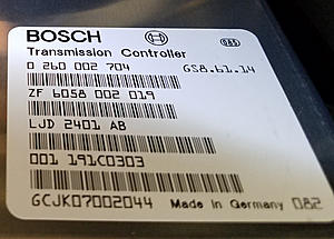

See TCM label in photo.
From my photos:
Small labels:
GCJK3R2E65
0260002704
Large main label:
Bosch D85
Transmission controller GS8.61.14
0 260 002 704
ZF 6058 002 019
LJD 2401 AB
001 191C0303
GCJK07002044
Made in Germany 082
Last 6 digits of my VIN: F14825
Many places to buy a used TCM. I see prices from ~$40-$90.
I know I must get one with the Right numbers. Hopefully, someone can tell me which numbers from my label must match the replacement TCM! I know I cannot use just any TCM from any 2000 XJ8.
Ive read that I will not need to reprogram the replacement TCM. S/B plug & play.

I do need to know what numbers must match.

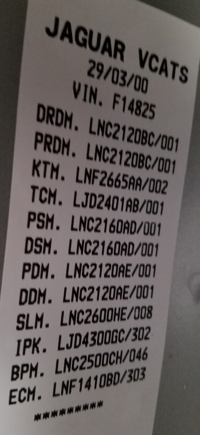

Don't forget to disconnect the battery first.
Find the VCAT list near the spare tire to get the numbers which should be matched for an exact replacement.
You may get a wrong part message and have to take it to a shop with IDS/WDS etc. software.

I looked under the floor in the trunk & I see no VCAT list. I looked all around that area & even in the battery compartment next to it. I see on both R & L sides of the trunk lip the VIN #, That would have been a good place to put this VCAT list. Surely, Jaguar did not place the list UNDERNEATH the actual spare, requiring you to lift the spare, merely to see some numbers? That would just be mean.

Steve the VCATS is on the spare wheel well, you may have to pull carpet to actually see it,
'behind the trunk trim on the left hand side of the spare wheel well'...

I found the VCATS list. (See photos)
Note: when replacing the Left side trunk carpet liner do NOT attempt to put it back inside out! Dont ask me how I know)
Per VCATS: TCM. LJD 2401 AB/001
So, it is the same # listed on the TCM label that I originally posted.
The only difference is the addition of /001
Can I assume that the /001 is not important to finding a suitable replacement?

I found one that is LJD 2401 AB just like mine. Also most of the other numbers on the TCM label is the same as mine.
Mine:
Bosch D85
0 260 002 704
ZF 6058 002 019
LJD 2401 AB
001 191C0303
GCJK07002044
Made in Germany 082
Used one for sale:
Bosch D85
0 260 002 704
ZF 6058 002 019
LJD 2401 AB
001 191C0303
GCJK075001660
Made in Germany 082
Im guessing that last # (GCJK075001660) is the serial #.

So, anyone have answers to my question re removing the wire harness? I wonder if that silver part lifts up like a lever & then maybe you pull?

Mine:
Bosch D85
0 260 002 704
ZF 6058 002 019
LJD 2401 AB
001 191C0303
GCJK07002044
Made in Germany 082
Used one for sale:
Bosch D85
0 260 002 704
ZF 6058 002 019
LJD 2401 AB
001 191C0303
GCJK075001660
Made in Germany 082
My Jag is 18 years old yet, when I opened the waterproof compartment the TCM looked clean & new. The sellers TCM looks dirty, label stained & old. Probably doesnt matter but, I think the location protects the TCM from dirt/grime, etc. Why is that one very dirty?
Seller claims it is tested & works but selling it As is.
I wonder how exactly can it be tested?
Im tempted to go for it.
I will, of course, disconnect the battery b4 I remove & replace the TCM.

Removal is gently lifting the metal cam lever to unlock the connector, I don't think the screw needs removing.

More info on replacement TCM.
Per Jaguar Dealer Parts Dept. TCM for 2000 XJ8 is NLA (No longer available) When it was available, it cost $1,200.00. So, it did NOT cost $2,700 new from Jag dealer, as my Indy claimed! He had offered (If I got the fault again) to sell me a used TCM for $250 & install it for 1 hour labor charge. I asked the parts guy if the #s after the slash were important or if I could ignore them. I explained that I now must buy a used one & I see used TCMs with the same # I have on the TCM label itself but not the additional /001 I see on the VCATS list.
On my TCM label: LJD 2401 AB
On VCATS list: LJD 2401 AB/001
He didnt know & transferred me to Service advisor who also was not sure but asked someone else (A more experienced Jag mechanic?)
He came back & said yes, the /001 is important.
I asked if I bought a used one (LJD 2401 AB) & was not able to know what the #s after the slash were & it didn't work bc it needed programming, will they program it for a 1 hour labor charge?
To my surprise, he said we cant bc we do not have the older machine. He referred me to a different Jaguar Dealer that does.
So, Sean B seems to be correct!
My options are to make calls & emails to every seller of a LJD 2401 AB TCM & ask if they have access to the donor car & can check the VCATS list & maybe send me a photo or at least tell me the complete # after TCM:
If I get someone who says it is /001, buy it, install it & hope for the best.

Note: Had to lift TCM up & out to lever the metal clip up. Then, I wiggled & pulled the wiring harness straight out. It came completely out, except was held by far end (w/o any teeth engaged.) By wiggling I got the harness completely off. See photos.
To reconnect TCM is a bit tricky. There is a hinge on the end & the harness must push back to lock into the hinge with a click & only then can you gently push harness down so, all the many teeth engage. Do not force it! It then looks as if one side (opposite the hinge) is not fully down. That is OK. When you push the metal lever back down, it lowers that end of the harness so it is evenly attached to the TCM. It is also tricky to put the TCM back into place. There are flanged edges on R&L side that must go behind vertical columns in the box. So, the TCM is actually secured into place more securely than I had originally realized.

Lady Penelope,
Did you look @ the VCATS list under the trunk carpet (See my photos) On the TCM itself it would only list: LJD 2401 AB Along with serial #s & many other numbers -see my photos & list.
However, on the VCATS list, It surely had LJD 2401 AB/???
What were the #s after the slash?
(You likely already know all this) I wonder how many different #s after the / are possible for an X308 & especially if it is a TCM with the LJD 2401 AB? IDK if the possibilities are only ; 001 & 002 which would give me a 50:50 chance assuming the seller cannot check the VCAT list. Or: 001,002, 003,004, 005, 006 ,007 & 008, etc. Then it is highly unlikely I can find a LJD 2401 AB/001.

Im looking at my photo of the ECM, next to the TCM, b4 I rotated the ECM out of the way to photograph the TCM label.
It looks like there are 6 white, plastic wire harnesses, plugged into the side of the ECM, facing towards the front bumper.
I dont know where the 3 solenoids for the ECM are located. Must I disconnect the battery, disconnect & remove the ECM, open up the ECM in order to do this test?
I hope I can learn how & do this test & one of my solenoids is bad!
