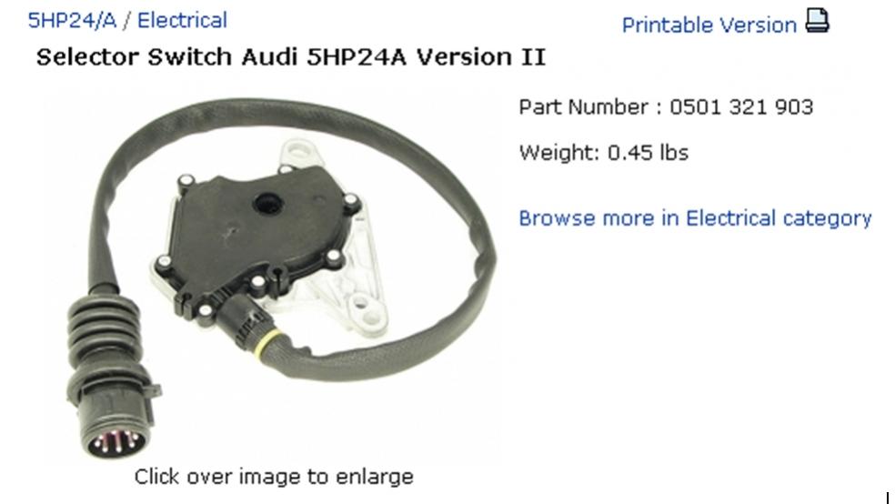

Old Nov 5, 2012 | 10:49 PM
fredd60's Avatar
Posts: 534
Likes: 89
From: australia
Hi, RIXJ8, couldn't find how to adjust it, but did find this picture. Problem may be that the connector needs cleaning, or take switch apart and clean it.
good luck
