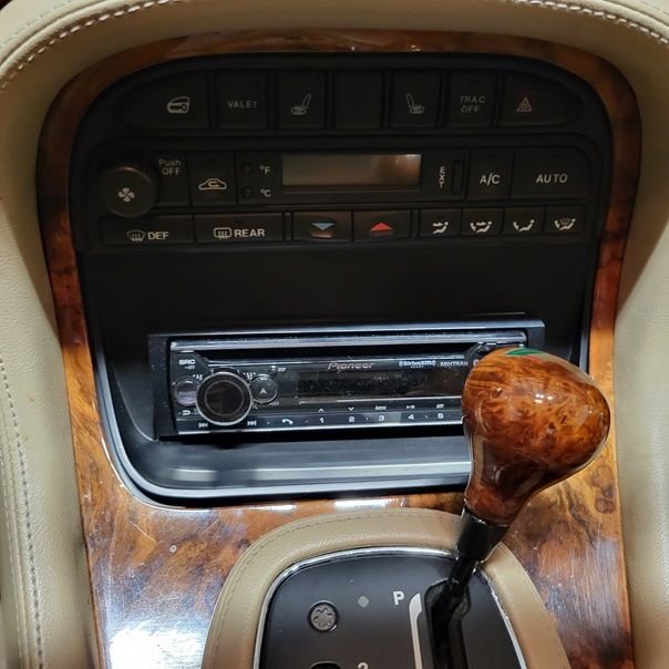

1) I'd like to install a modern single din head unit. Does anyone have suggestions for kits?

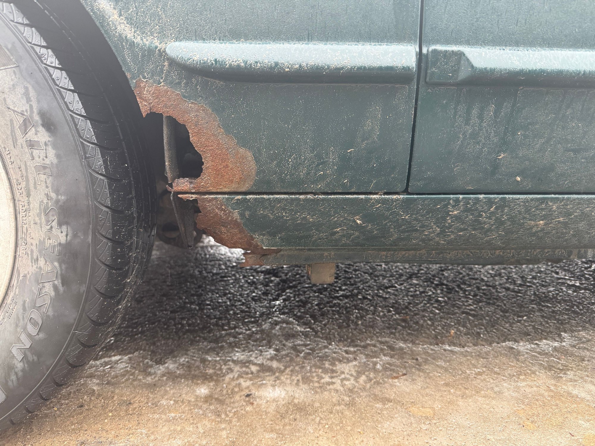

4) Also have some body work that needs attending this summer, any advice as to who/where would have the pieces I need to fix this right, would be great.

Here's a link to the single DIN fascia I found a few years back and still use today. https://www.jaguarforums.com/forum/x...5/#post1491946 The Clarion pop out screen has recently been discarded for a sweet Pioneer DEH-S6220BS. I love Pioneers, great sound...absolutely do not recommend Clarion, I only got it for the screen for navigation 14 yrs ago. I also upgraded my speakers to Rockford Fosgate R165-S and picked up new connectors for them as well...Metra 71-017C. I'm using the Alpine/Jaguar amp.

For body panels such as those you require, first inspect closely the extent
of damage your car has. (Rust, at the point shown on your car almost always
extends far beyond what is showing) Then you will have a much better idea
of to what extent you need to acquire from a doner Jaguar.

Rust, I'm in the same boat, but lucky for me a bit less bad. Its on my list for this year to try to either address it or accept that eventually its going to rot out from under me and best to enjoy it while its still unperforated.
