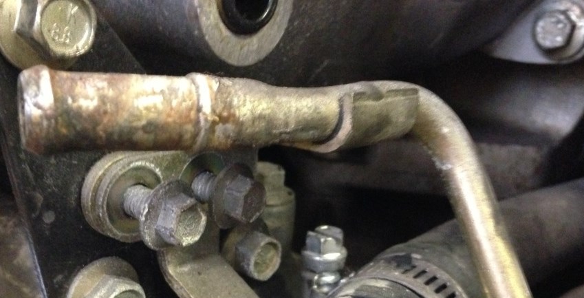

2 things...is there a hose that connects to the end of the fuel pressure regulator and where does the J shaped hose under the throttle body connect to...

Yes, there is a hose that connects from the right hand intake to the FPR. It is for vacuum so that the fuel pressure varies with intake manifold pressure.

The small elbow shaped hose is cooling system connected. It is directly below the throttle body and is oriented about 45 degrees to the left side of the engine.
A real bear to change after everything is back in place and you discover the hose is leaking ask how i know LOL

Right...thanks. And it would just a bit more helpful if you tell where on the right hand intake manifold I might be able to find this hose. Just in case people read this in the years to come, know where it is exactly...
Oh man thanks I need to get that hose back on the right track quickly then LOL. Where does it hook up to please?

Attached is the relevant pages from the tech manual for the FPR hoses and the cooling hoses.
