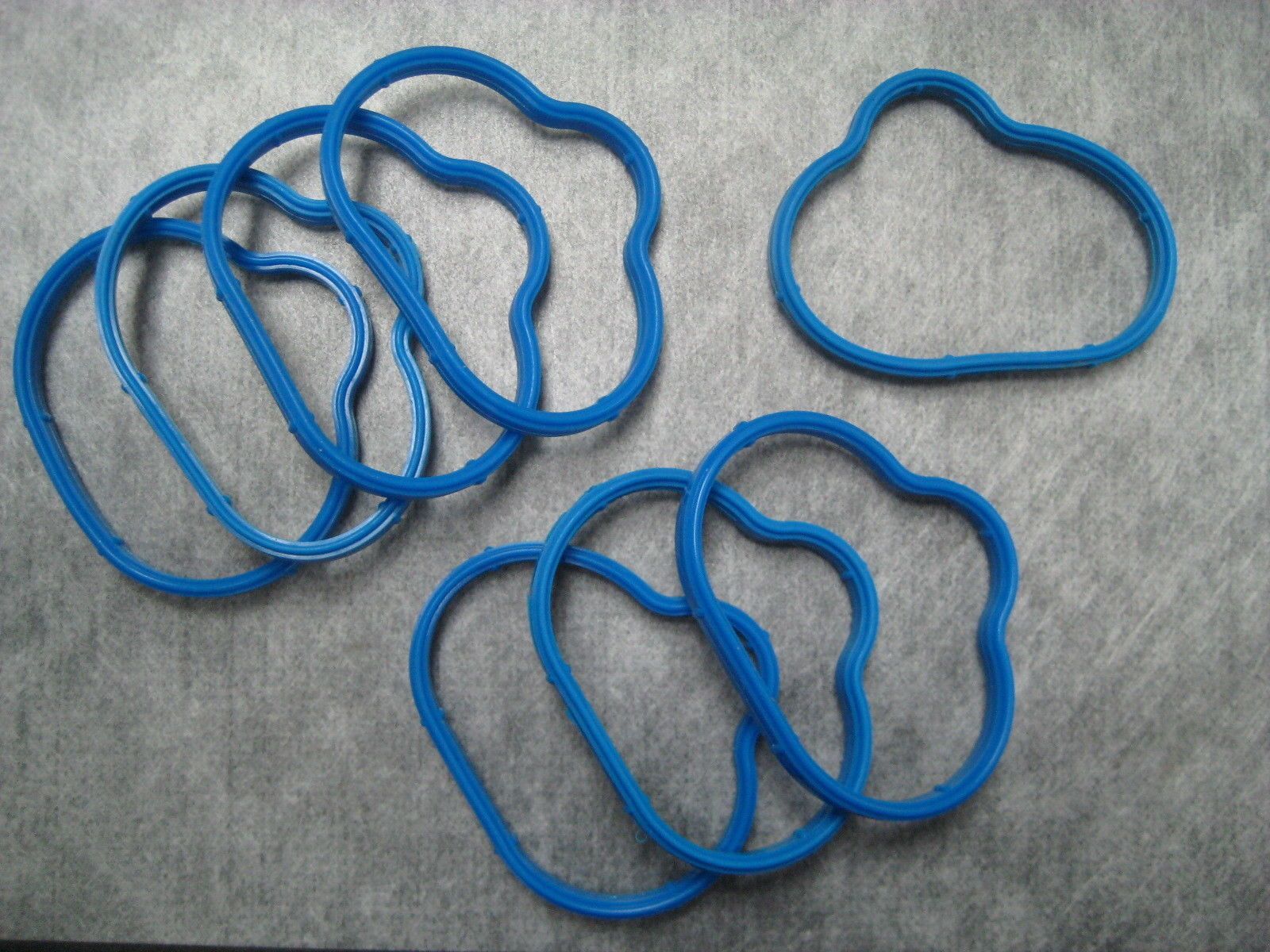

Looks like I'll need to open her up then.
It's got over 200k miles on it so it's quite possible the manifold gaskets are brittle etc.
