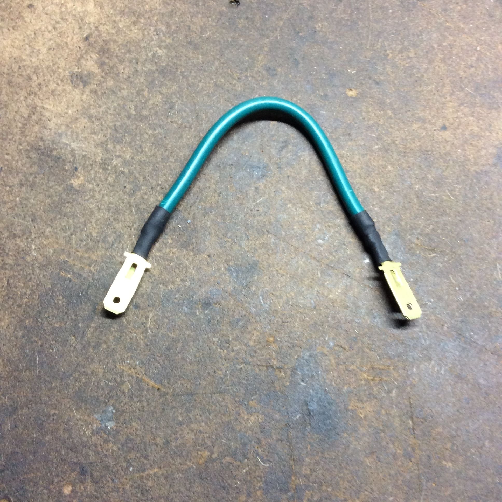

To save some money on a tow visit the auto parts store behind the counter and have them make you a jumper clip using blade connectors
The clip requires 8 or 12 inches of heavy gauge wire
Clip the clip in half and strip the wires at the cut
Pin 3 to 5
insert the 2 halves with the stripped wire ends in the air . to start the car with the key in the run position bring the 2 stripped ends together
This bypasses the BPM and its enables like the key chip , transmission neutral switch and engine control module
This is a low power section of the starter circuit not like the battery cables which ultimately power the starter motor
But is high enough power to damage the relay socket if jamming round copper wire into
