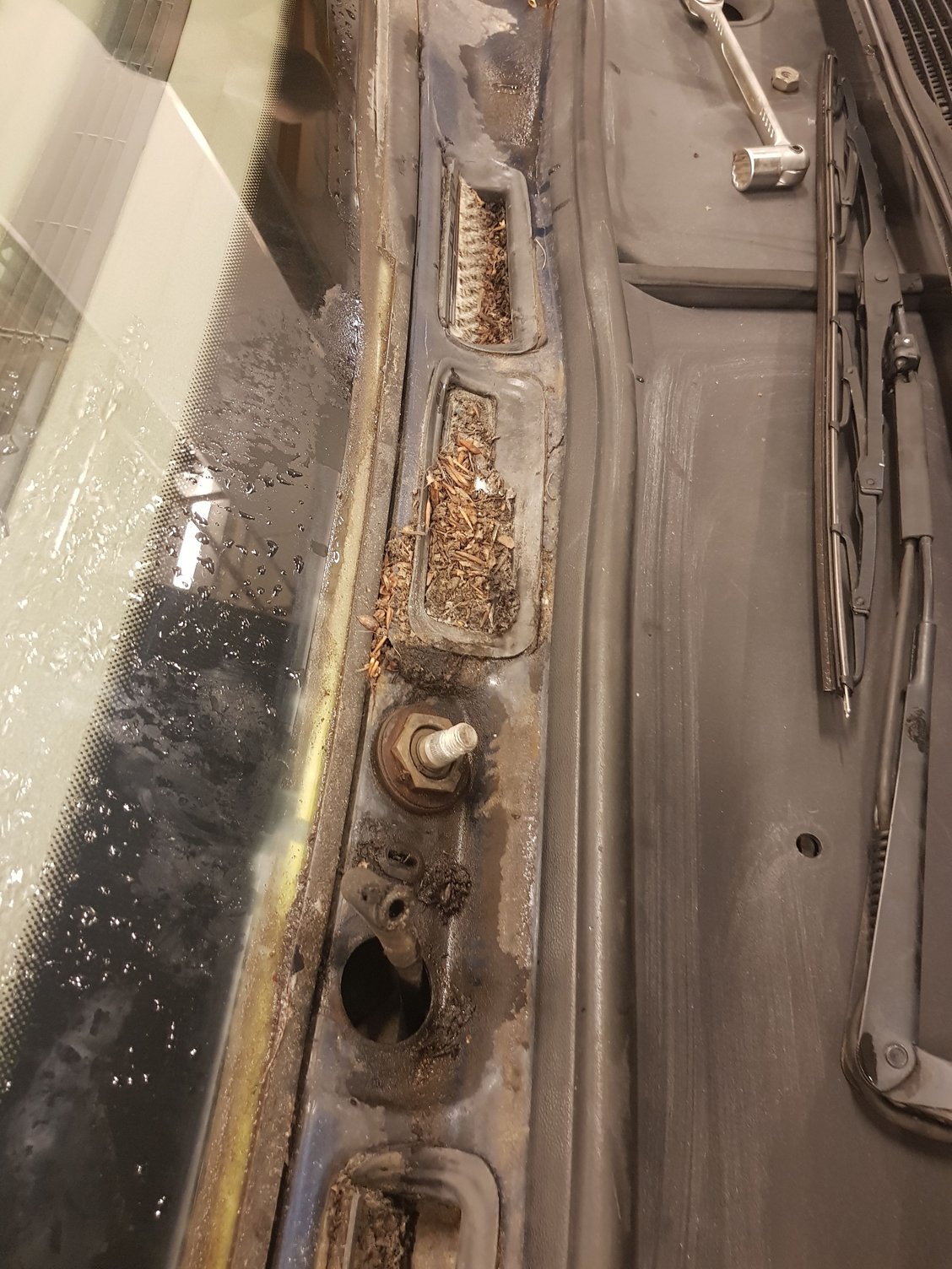

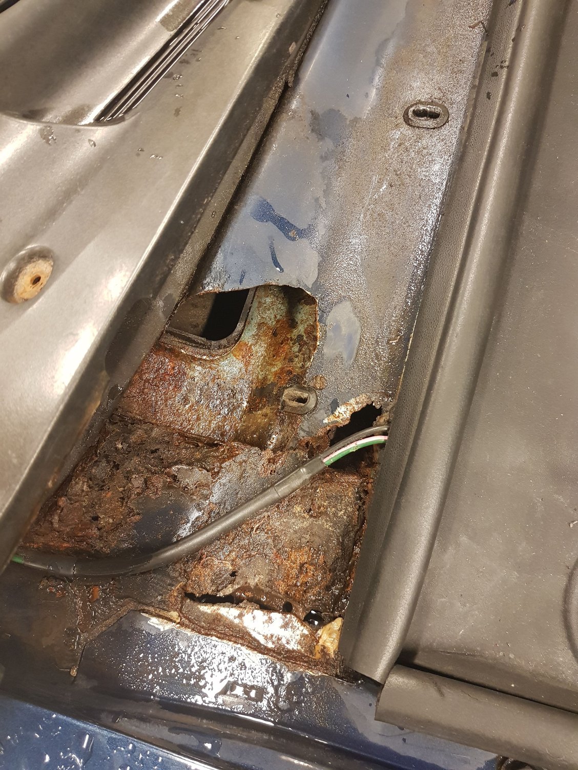

Ok guys. Seems like i found the big issue.
I went on to remove the panel beneath the front windshield. There is a big big rusthole in the left hand side corner. I think this is the source.
I also cleared the drainpipes on the sunroof and firewall high pressure air and å thread. Seems to be ok now.

Ouch, there's some work. There was a member who did the replacement on this, I'm thinking about 10 months ago...welding new piece in, the works.
