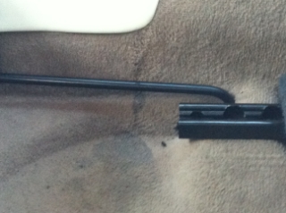

Daughter got in the back today for a trip out and to my absolute horror I noticed a patch of soaked carpet just behind the L/H runner of the passenger seat - about 4" x 4" square, when the back of the front passenger seat was tilted forward. The rest of the carpet in the footwell seemed ok but not 100% sure if really totally bone dry.
Unfortunately my garage isn't large enough for me to get the cat indoors when not in use, so out on the drive she proudly sits but its been hammering it down for days recently - nothing new tho.
There's nothing obvious anywhere else inside the car - ie passenger front footwell or anything on the driver's side. The only change recently is parking it nose down on a few degree slope on the driveway.
Any offers of help greatly appreciated.

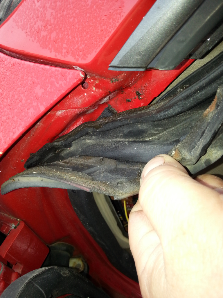

Take a look at the bottom of the windscreen A pillar, top of the door, the pic explains it, if that seal has been taken off for some reason or has come unstuck that will cause a leak.
And these pics are of the US XK I am doing

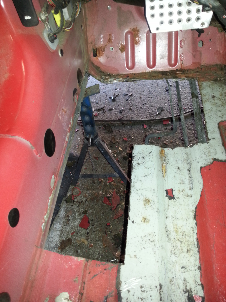

Left unchecked the floor issue will be the least of your probs, the water has been seeping in for a while, I had to hang the carper for 3 days to drip dry, the result is below, ironically the usual culprit being the strengthening plate is still reasonably intact
And now the size of the hole I cut
There is also a hole in the rear footwell..... Not pretty but I will make good.... Just remember if that seal has come away stick it back on!!
