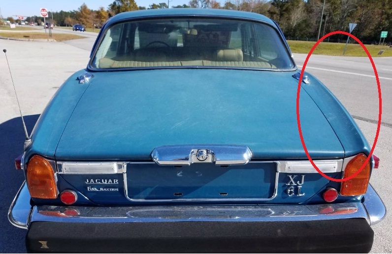

XJ6 update : I went to drive it again Sunday afternoon, this time the car was pulled from the inside garage bay & I got to see the concrete underneath it. It indicated a heavy oil leak which the seller was indifferent to when pointed out. I spoke w/ the maintenance/detailer guy alone & he confirmed the car had a few massive leaks.
Seller turned down my $4K offer & I avoided another project, win/win.
