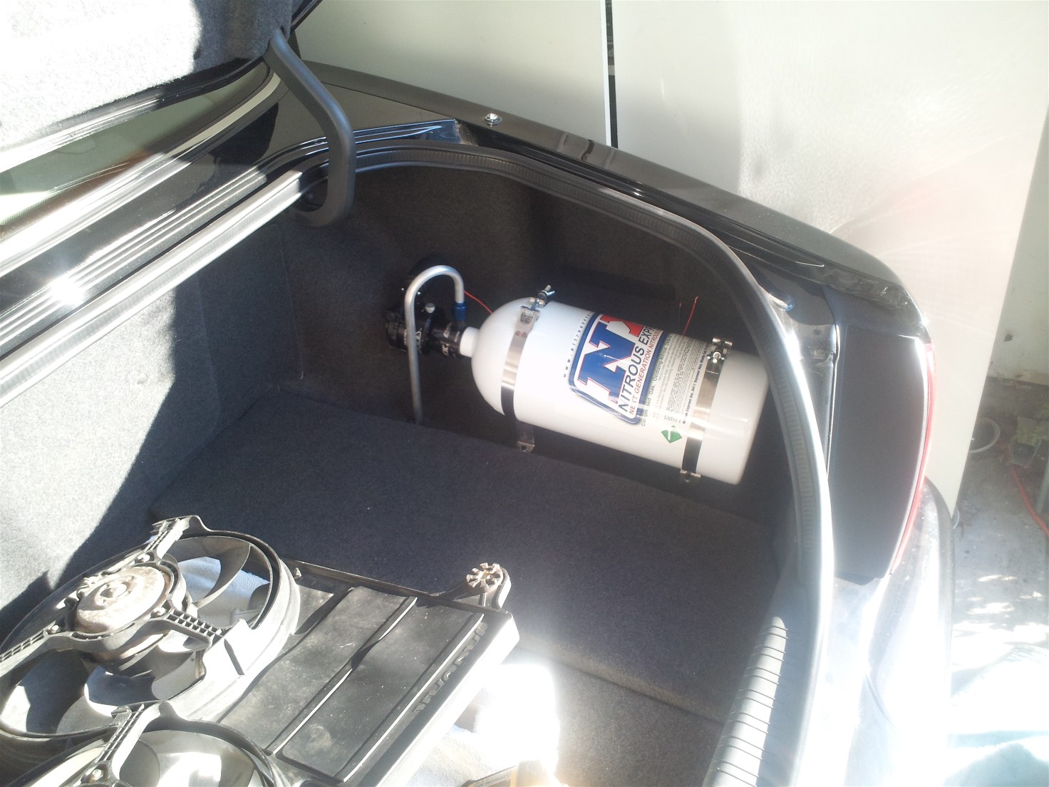

I added even more wiring:
2 NOS solenoids in series to lessen likelihood of one hanging open when not desired.
1 fuel solenoid to match with the NOS
1 Purge valve solenoid
Wired NOS controller
4 more relays for the above
ran nos line through cabin with gauge
added in line cooling fan to vent cool air to rear of engine bay when not moving
Mounted NOS bottle in trunk, installed blow off tube
Now impatiently waiting for super charger to return from warranty work to test this all out.

uuhh....that's a lot of wiring!
