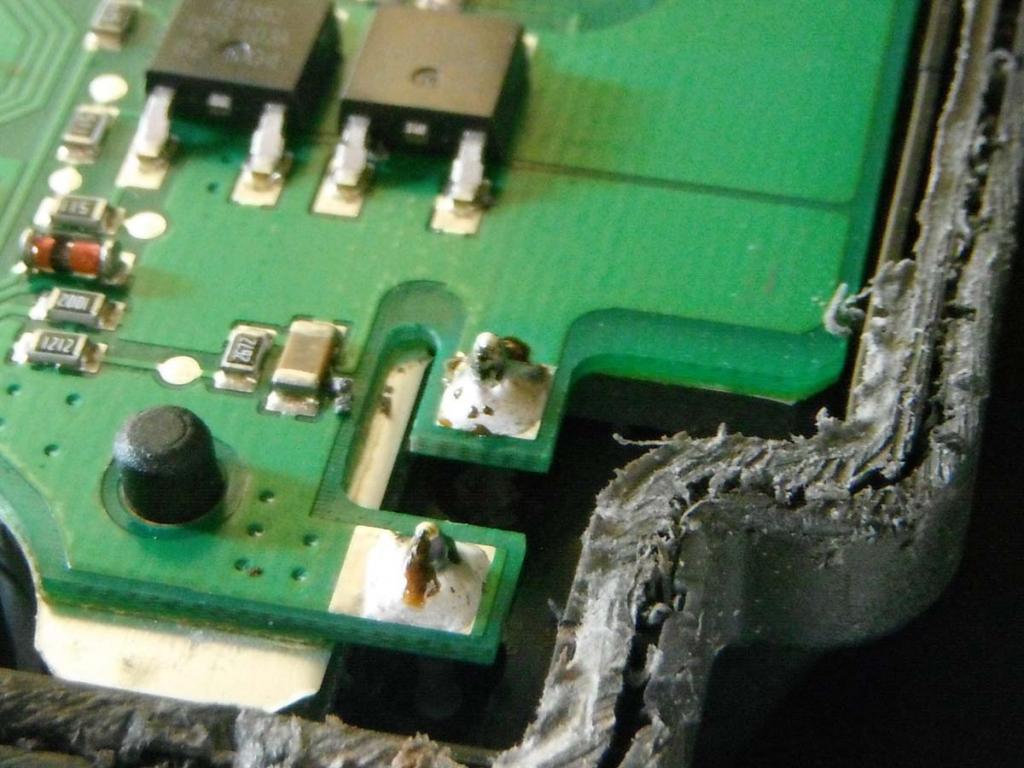

Intermittent ABS light last 3 startups moving the car for the summer, went solid yesterday.
It's covered 1300 miles since the rebuild so it couldn't be the wheel speed sensors.
The battery is fresh off a trickle charge and 12.91V on the car.
Only bloody job I didn't do was the pin check on the ABS module, why bother, got a spare. But thinking about fitting the spare and that part doing the same thing in the future I opted for the fix.
ABS module board and pin pickups for the pump as found.
After a liberal dose of super solder.
No ABS warning light, all is well.
Nice pictures and write up Sean B. You can see the cracked solder joint in the before picture (top pin). I have inspected and repaired many automotive PCBAs. and it surprises me that they work at all; the original workmanship leaving much to be desired. Couple that with the harsh environment they are subjected to - temperature swings, humidity, etc.
Most of these boards are soldered originally with RMA (Rosin Mildly Activated) or No Clean Flux which is designed to become benign and non-conductive and non corrosive after the soldering process is completed. I have my doubts about long term reliability with this process, but they are built both with a cost and revenue bearing spare replacement goal in mind.
