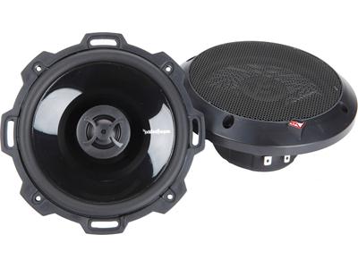

Just bought Rockford Fosgate Punch P152's to replace the dated factory speakers front & back in the Jag, getting them installed in the AM. The left front is blown w/ cracked grill the rattling/popping is annoying lol. Gonna look into getting a 8-10 inch ported sub & amp as well.

Had all factory speakers replaced & 2 12' Memphis Car Audio subs in a ported box installed in the trunk.
