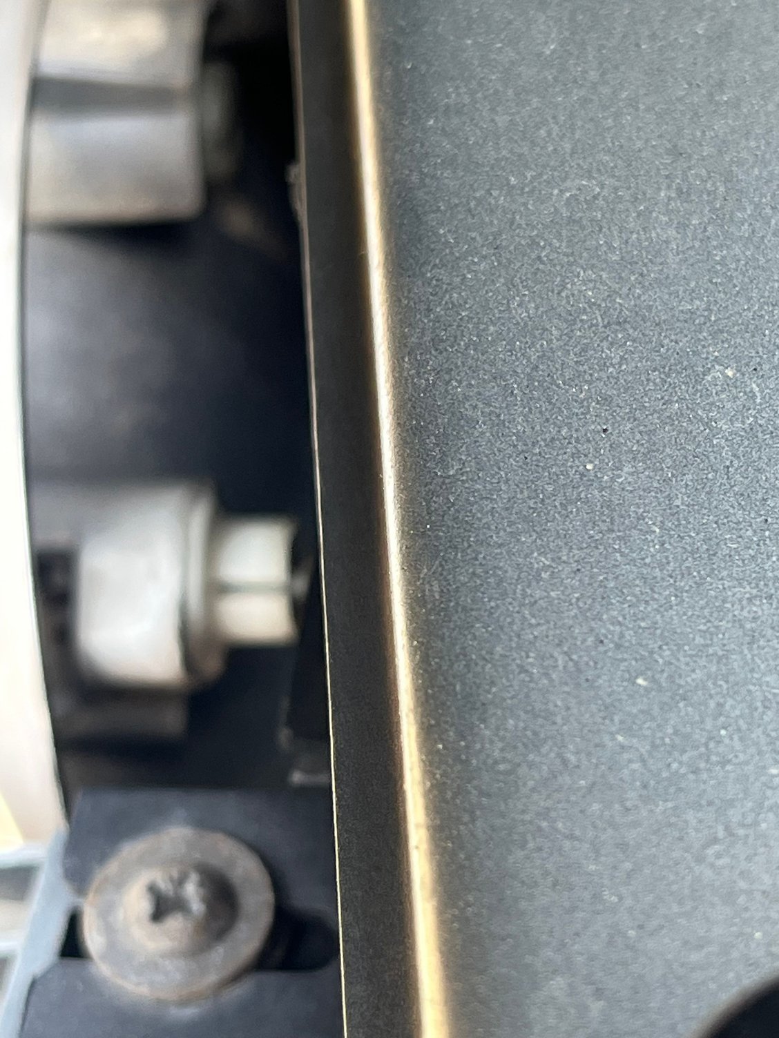

On both assemblies I sprayed silicone lubricant into the gap visible here on the ball/socket plastic parts I could see and reach.

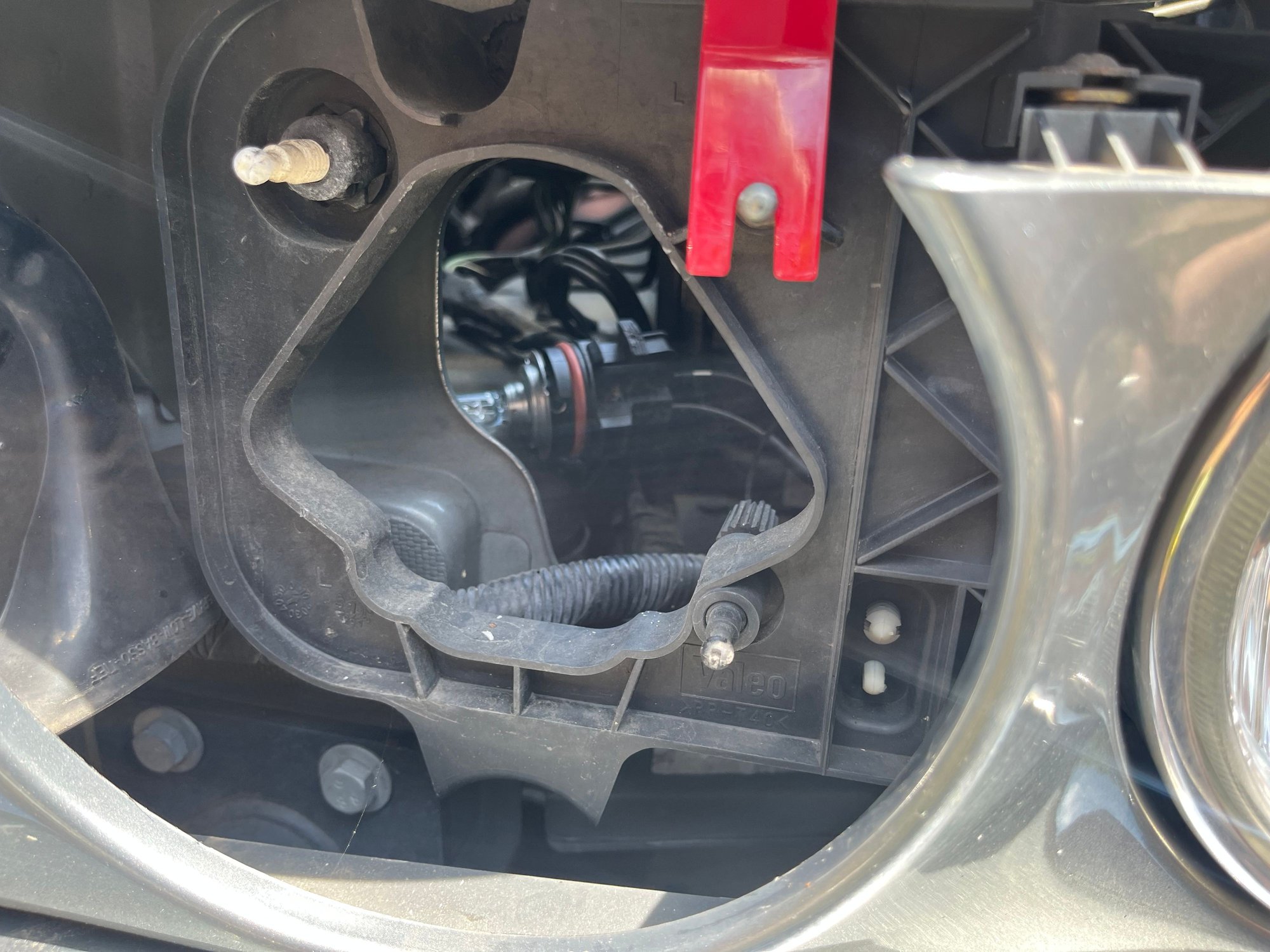

An illustration (with the old light out) of how I popped open tthe reachable top attachments from inside the hood. The bottom one came loose with steady pulling from below either with my finger or the larger of the two upholstry tools which had a good firm right angle in it.

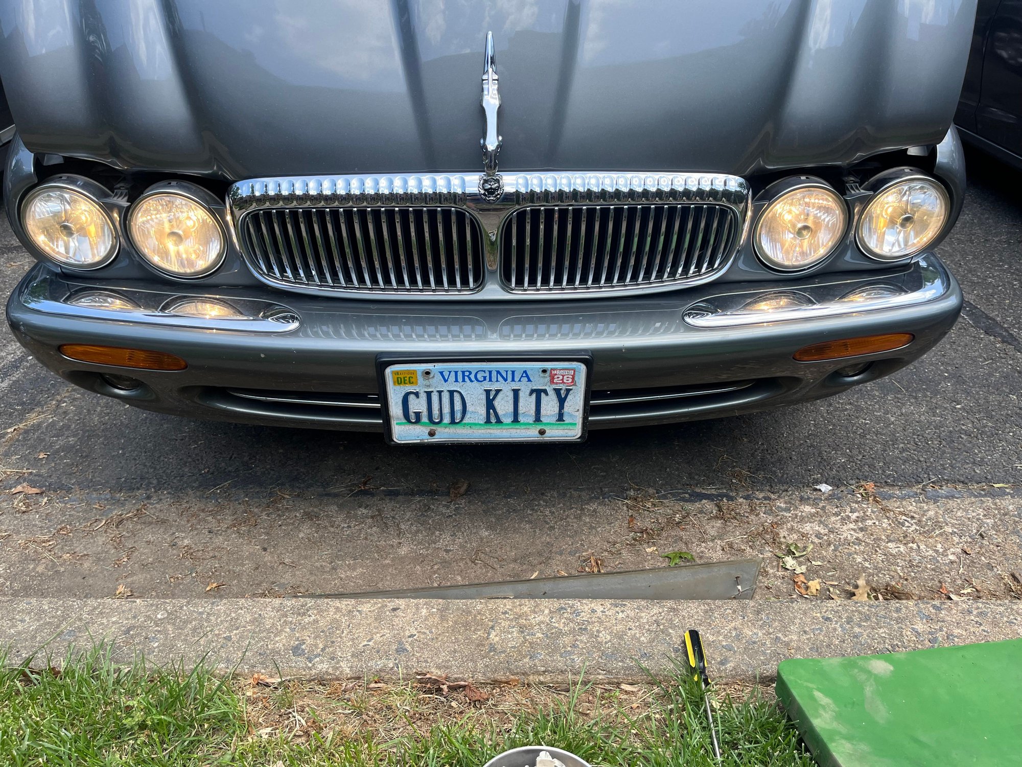

The finished product. On occasion I amaze myself, with a little help from my friends!

Well done for not breaking any of the plastic clips. They are very very brittle.
The lens assembly is the same on both sides.

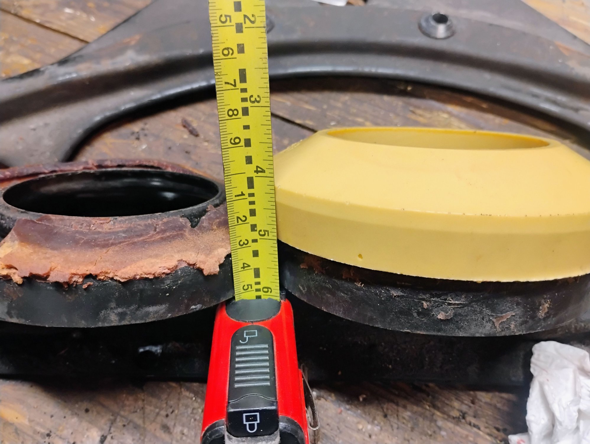

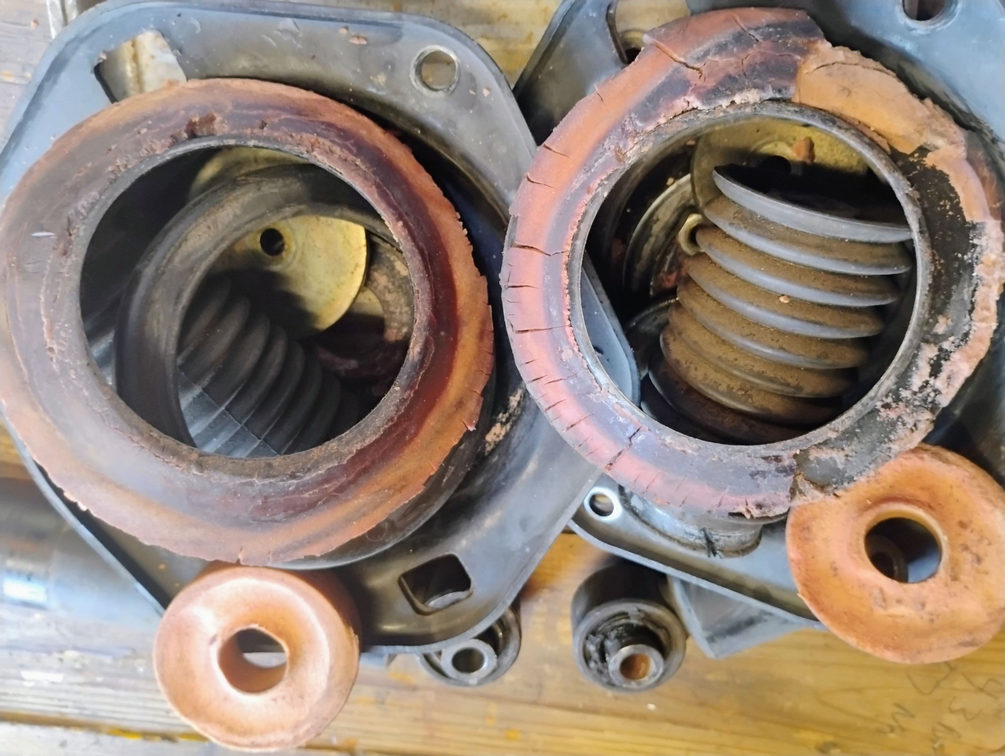

You will gain an inch after replacing coil bushings but it may not be enough to clear your sagging,
If it is sagging overly then your springs are gone, if bumpy then shocks and if you have a spare cash then replace both and enjoy the ride as new
You will need to manufacture special tool for front springs,good info here

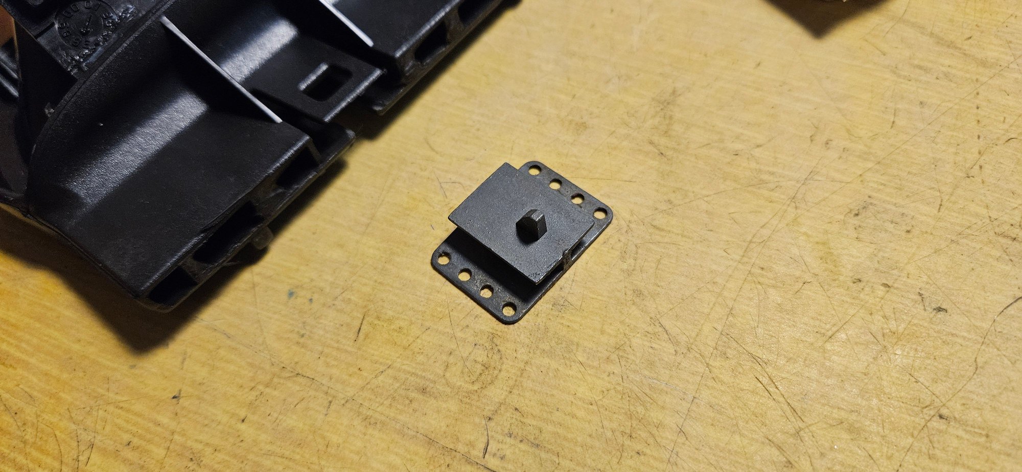

The piece I need is this, little metal clip that's normally glued to the rear glass:
The high level brake light clips to them.

6mm spring packers/shims are available new from JLRCP, part MNA3562BA.

Philip, I'll look through my misc. jag bits for that mount. (I removed the rear, high, light from 3 jags. I cant remember what I did with th
