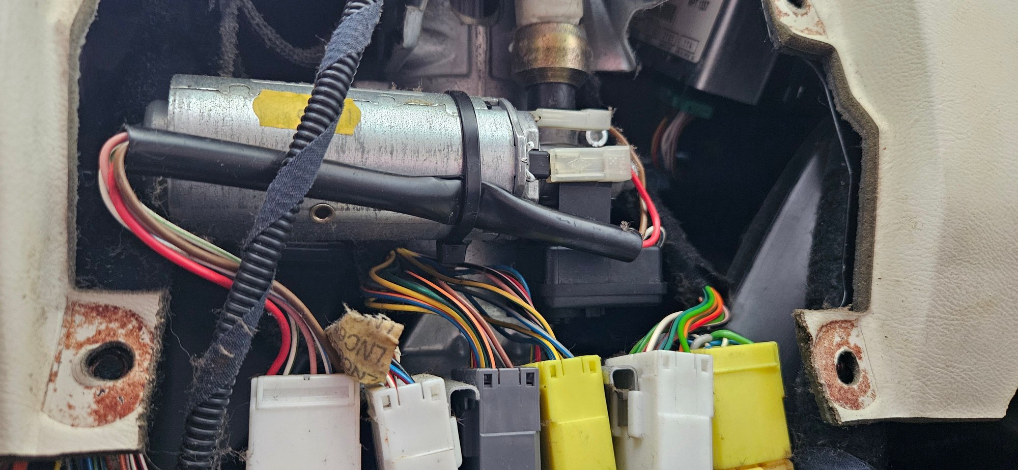

Undid the column lower cover. The potentiometer had fallen off the gearbox for the tilt motor. I ran the motor to the end stop, wound the pot so it had a turn spare after that, clipped it in and bingo.
Now it remembers the tilt position again. Happy days. Now all I gotta do is get all the gravel out of my hair and shirt from doing my best limbo-dancer impression clmbering up under the dash.
