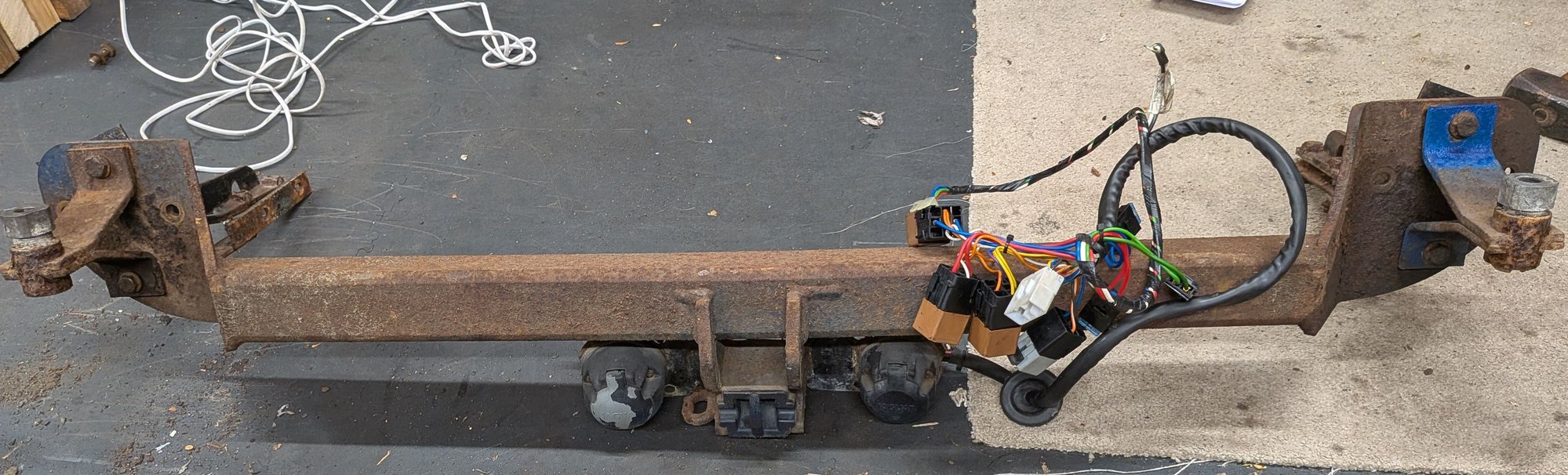

I removed the original Blink Tow Bar from the Daimler last night. The bumper is off to replace a couple of broken cover mounts and deal with some surface rust behind it; I'm never going to use the tow bar so decided to clean up the rear end and remove it.
It came out intact with all the electrics, relays, fuse etc in place. Does anyone need a tow bar for an X308 (I believe it also fits and X300)? You'd just need to source the removable tow-hook which has been mislaid at some point in the car's life. It's a big heavy piece of kit so probably only practical for a UK based owner - I'd just ask you to cover the delivery charges and maybe drop in a nice bottle of Whisky for my efforts ;-)
I'll post later in the X308 section so I can capture the removal install instructions - in case someone wants it or I decide to put it back on at any time. I hope I'm not breaking any forum guidelines here - I just want to find a home for it.

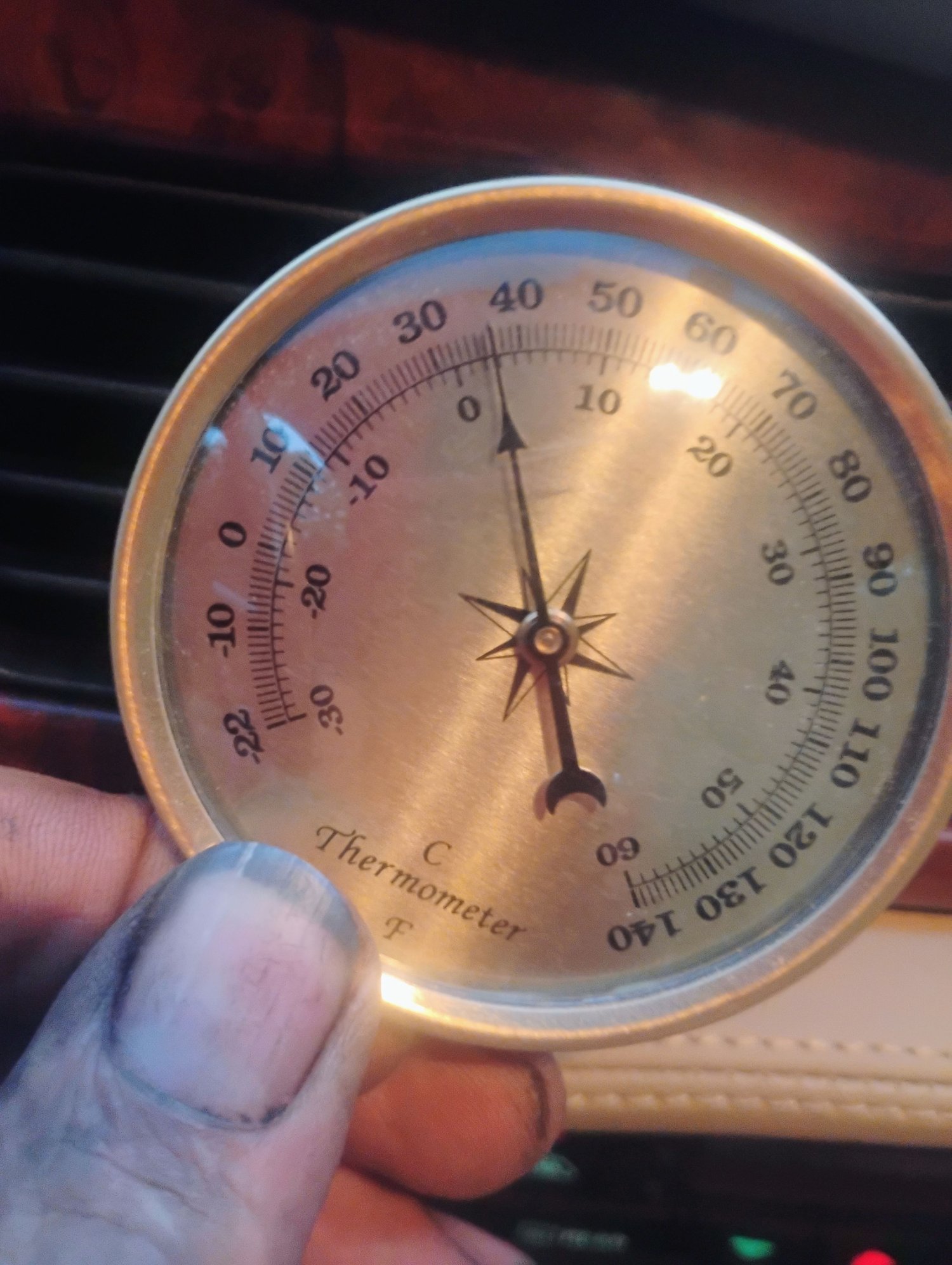

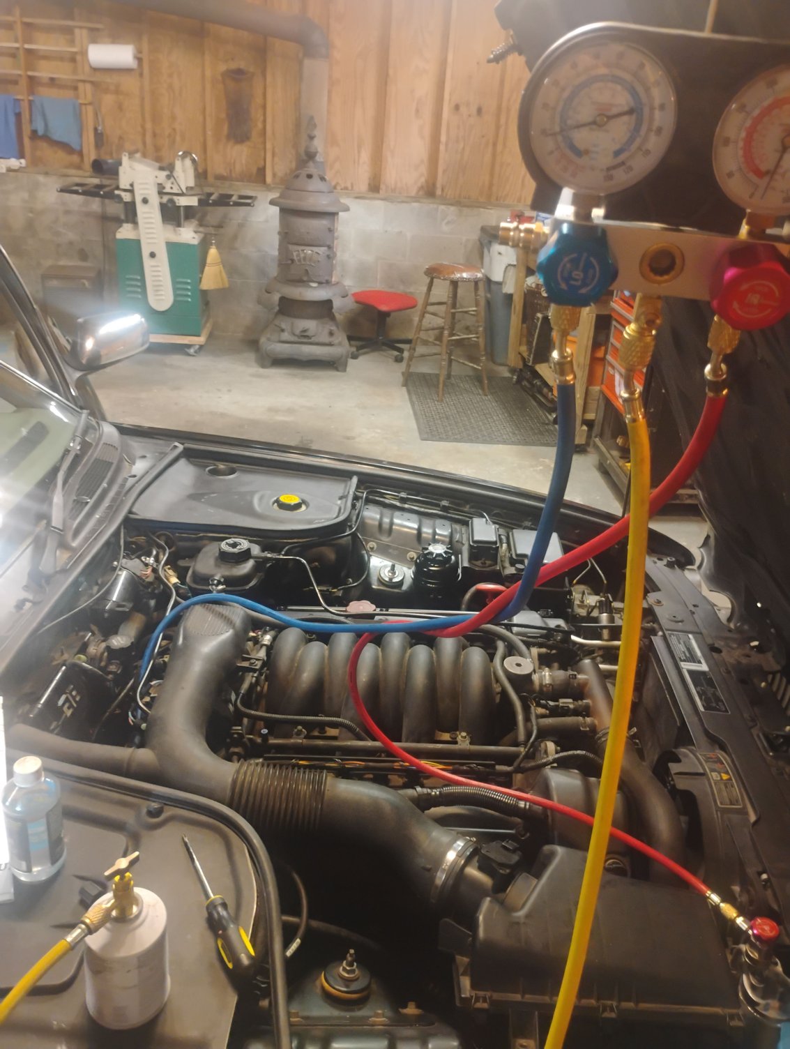

After engine / trans swap, no AC , no stereo. AC is priority.
Two leaks, at compressor, located using low tech (hillbilly) compressed air and soap water. Proper O rings installed and holds vacuum, I added at little PAG oil and 2 cans of 134 and it's putting out 37 F. Wife getting brain freeze.
I am very pleased with myself.
Stereo is next, will not turn on, fuses (if I checked the right ones) are good. Any suggestions? Id rather not pull the radio head.
Thx, Jeff xj8

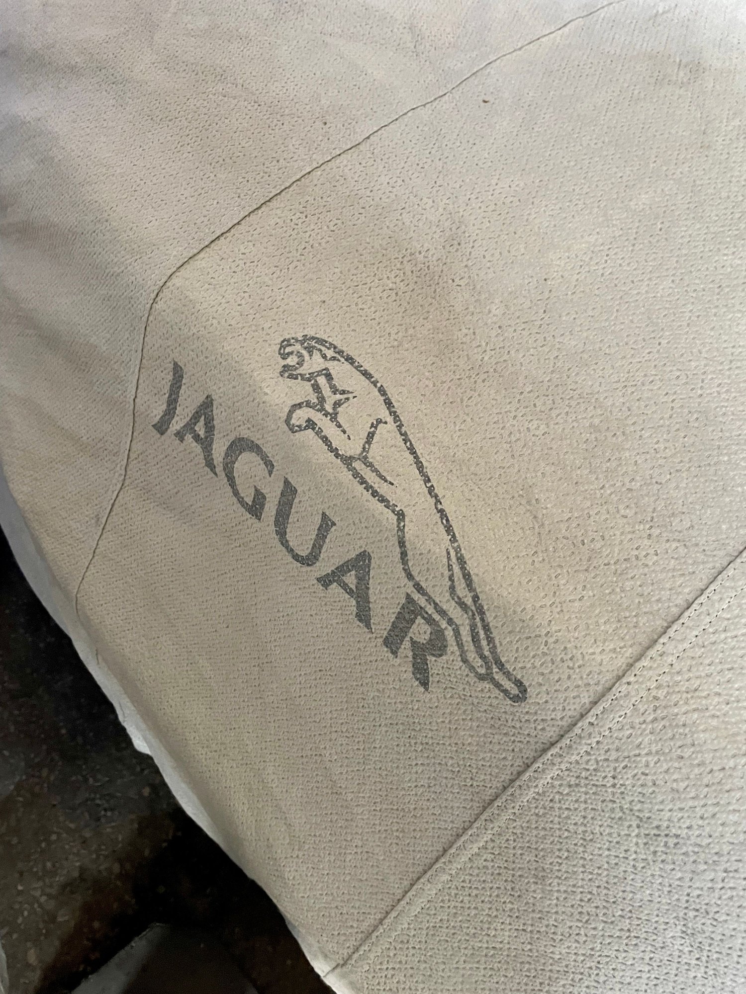

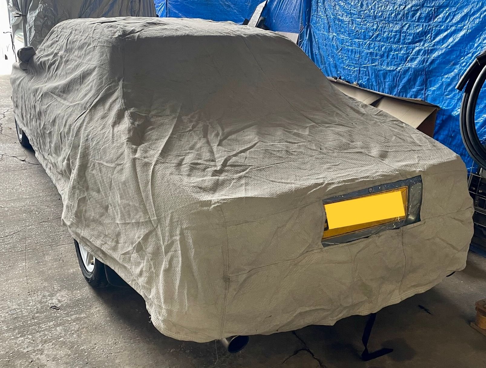

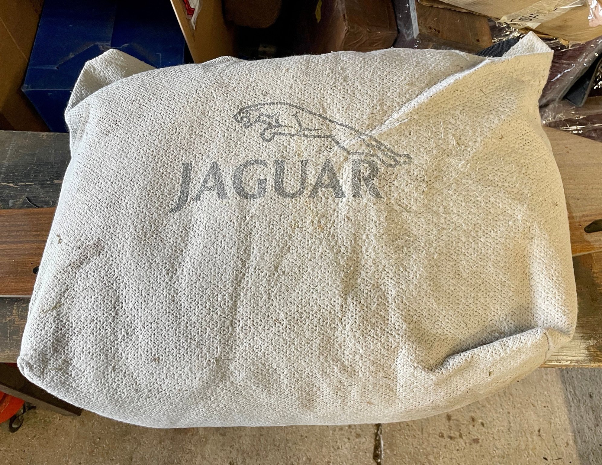

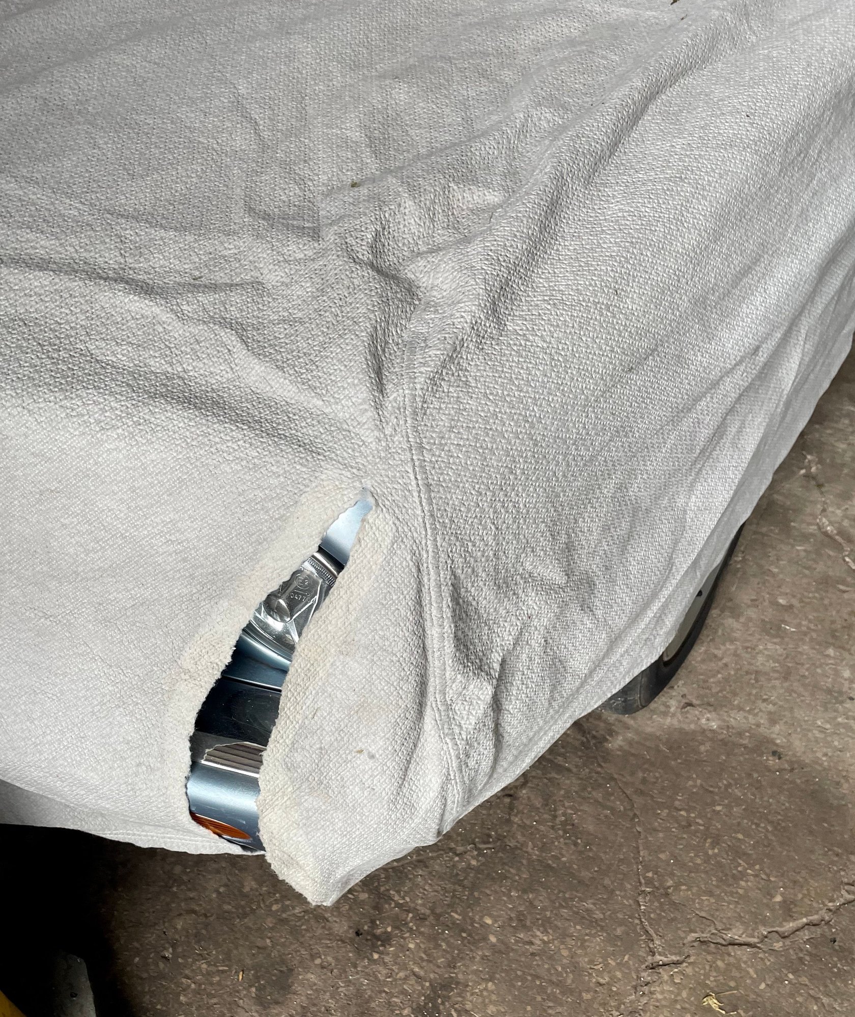

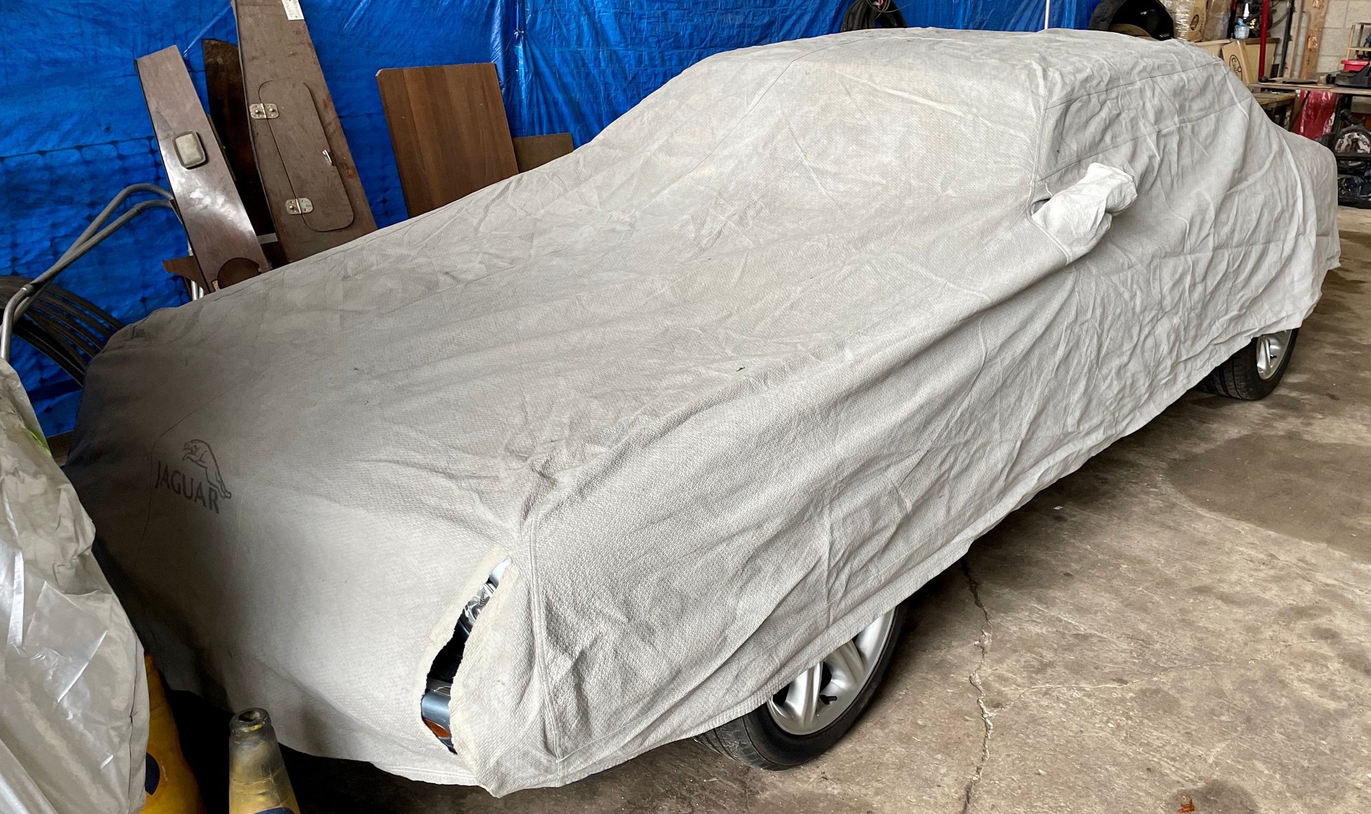

What I did to my X308 was to cover her up! Because of one of my other projects taking priority at the moment, Jessie Jag has to wait in line before I can pay her any serious attention. I managed to win this original OEM Jaguar car cover on eBay for £25 ($33 US) to keep the dirt and dust off whilst she sits in my workshop. It’s got a tear in one corner but it can be fixed, but for the price I’m happy with it. I’ve also begun collecting parts for the big restoration and yesterday a job lot of front suspension parts I again won on eBay arrived, all new in the sealed bags.
The plan at the moment is to send her in for bodywork and rust repair around October, that will give me time to acquire the necessary parts and funds for the repairs. Once that’s sorted I can spend the winter sorting out the mechanicals and suspension stuff.
Jag Bag
Jag Bag
Cover has a clear panel to allow for the registration plate to be visible when covered.
Peekaboo!
Peekaboo!

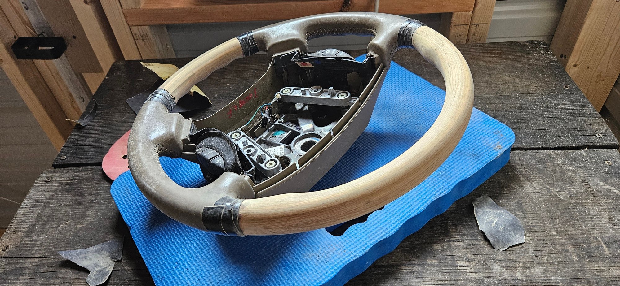

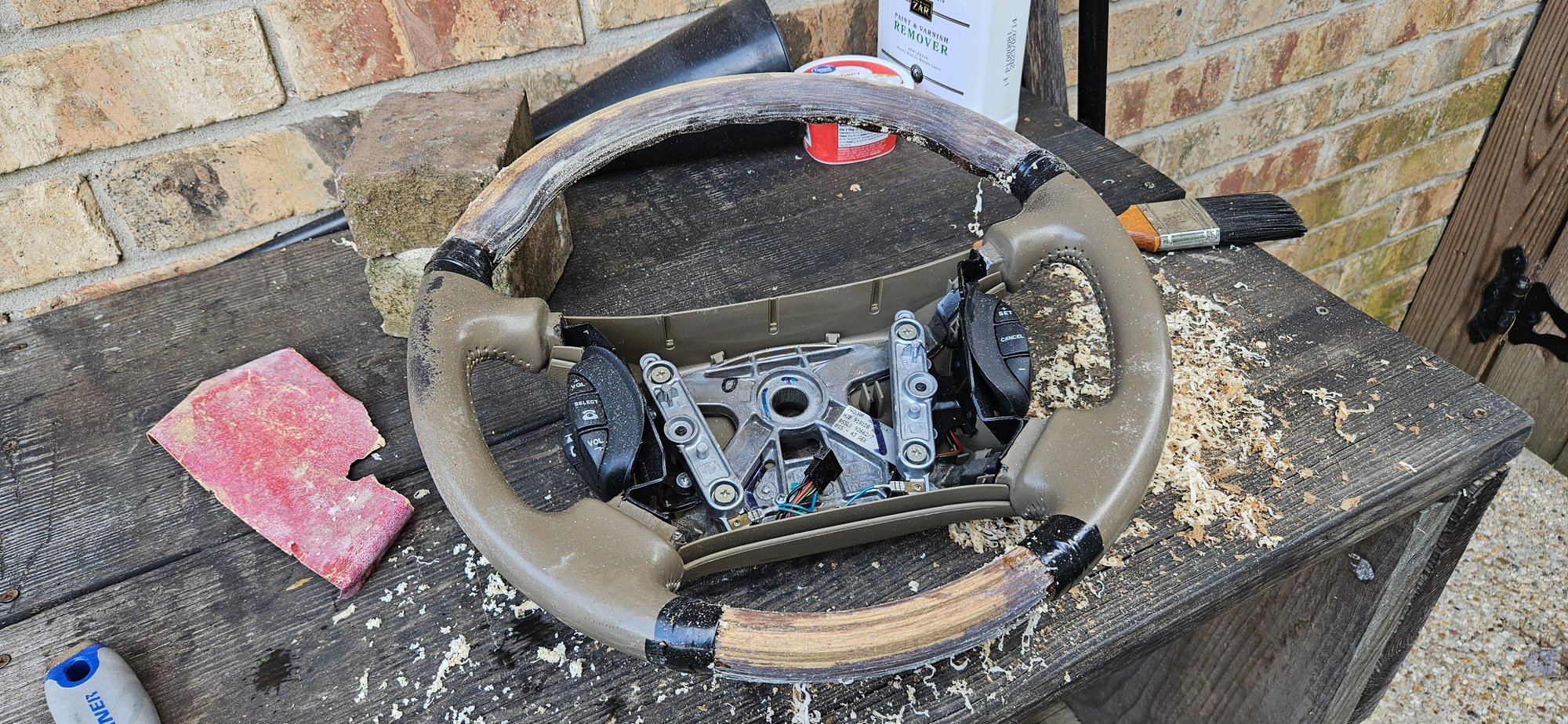

The varnish was all coming off my steering wheel where it's been in the sun.
Work in progress but it looks nice already.

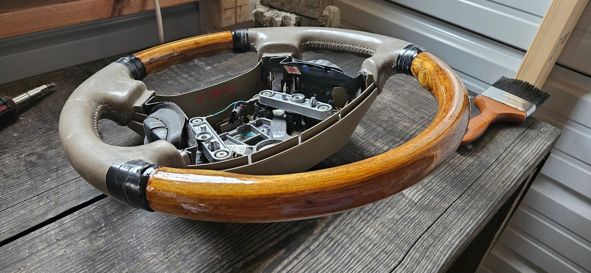

Happy with that. Now it needs to dry a few days and then I can polish it up and get it back in the car.

Did you use varnish or lacquer? Originally from the factory it would’ve been lacquer and to achieve the deep shine there would’ve been many many coats. When I did fresh veneer for my Triumph dashboard I gave it 35 coats of lacquer with a 1500 grit sanding between each coat. The shine is god but nothing like X308 Veneer shine which would’ve had around 50 or so coats of lacquer.
The steering wheel in my car has suffered from abuse and sun damage thanks to the guy I sold her to in 2019. I had the wheel trimmed in fresh leather in 2017 but he’s managed to ruin the leather and damage the wood. I’m thinking of restoring the veneer or fitting the NOS Jaguar wheel I have in my spares stock.

I decided on oil based polyurethane to try give it a bit of longevity- the dash appears to be lacquer as you say but the wheel has all the hallmarks of varnish which makes sense given how much it has to be handled during use.
It's got about 8 coats on. Should be enough to look well enough after a bit of a rubdown. I was just getting fed up of sharp flakes getting stuck in my hands from the top surface.
