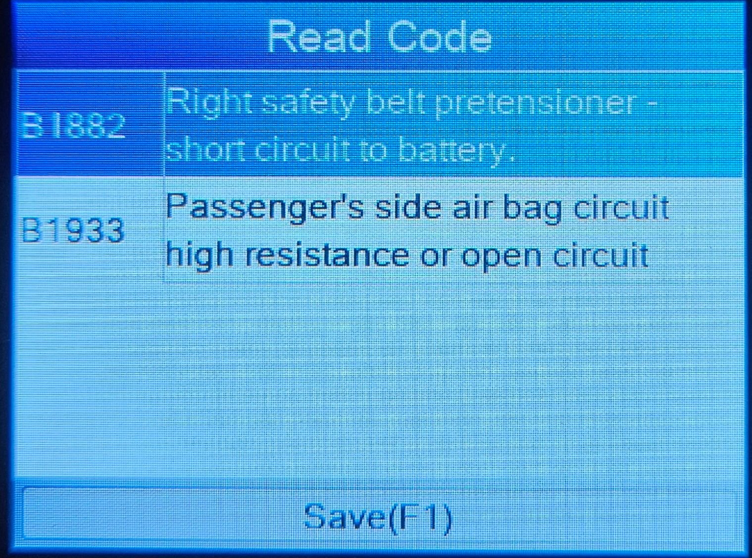

Carefully added all the details my code reader needed and polled the SRS module
I presume that's the main airbag module in the dash? Odd the pretensioner is giving a fault also.
No. it is passenger's SIDE airbag. Not passenger's side. Side airbad is right side of the seat backrest. I can not remember that has the seat bucle lock the pre tensioner or has the roll it. If the lock has it. Both wires goes through the seat connector. Do you have a yellow loose connector under the seat?
Pretty sure the pretensioner is in the inertia reel.
It does have a yellow connector underneath the seat. I'll have to pull the seat up and check all the wiring there.
That code is horrible grammatically. Thank you for setting me right.

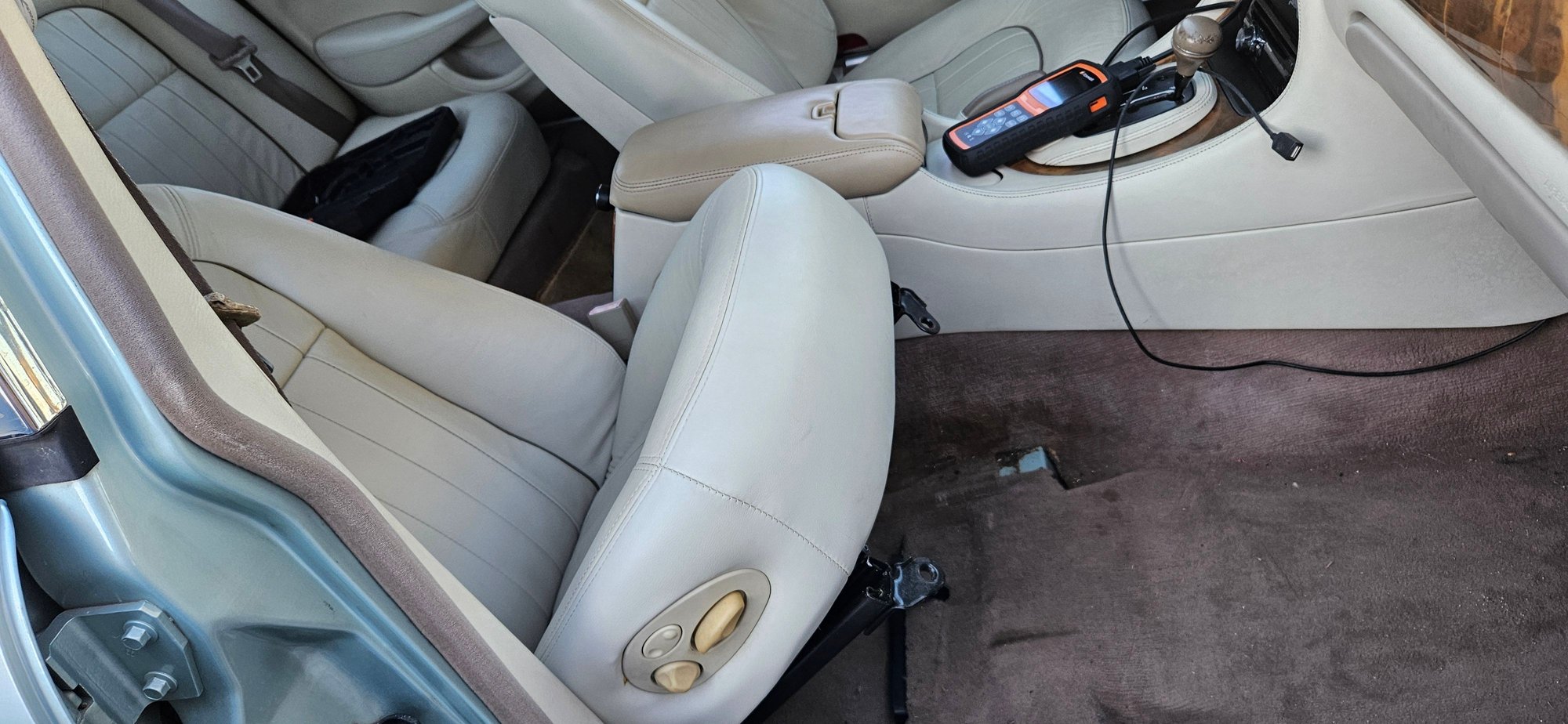

Battery off. Seat undone. Tilted back.
Cleaned all the connectors. That got rid of the side airbag high resistance fault.
The pretensioner short to battery is still there though - that's an oddity. I guess I'll have to pull the trim panel off and check the wiring.
I'm doing some looking and the pretensioner is part of the buckle assembly and not the inertia reel?

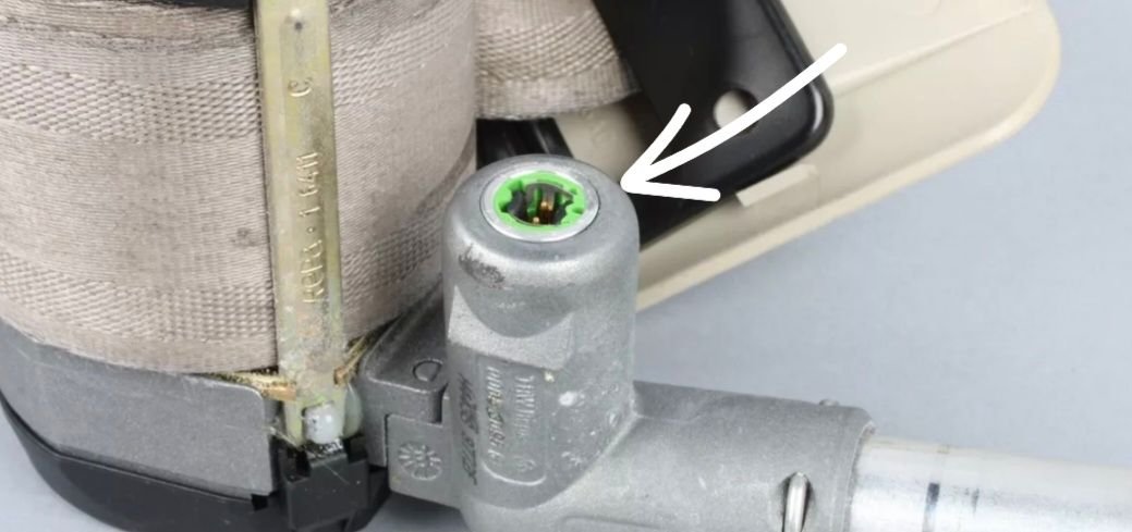

I'm fixing to take the B pillar trim off the car on the passenger side.
Is this the connector for the seatbelt pretensioner ignitor?
​​​​​The Jaguar manual shows no detail and doesn't mention any connector in the removal and reassembly procedure.
Phil
Edit: Got the trim partly pulled off, need to remove the upper buckle. Ran out of daylight and warmth. There's a yellow connector held in by tape there, from looking inside with a flashlight
