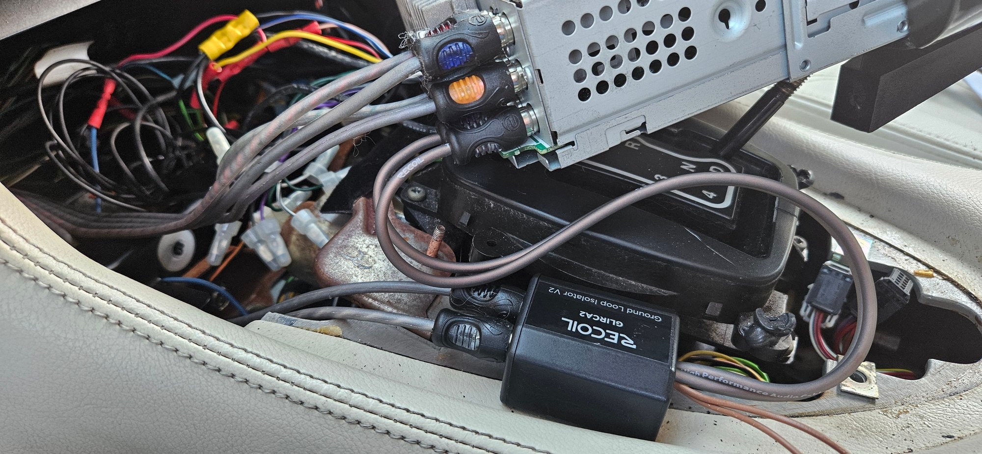

Ground loop isolation transformer fitted.
No more alternator whine. That works!

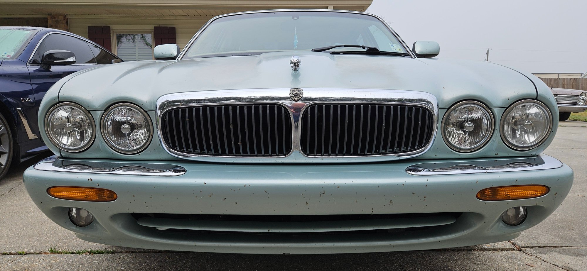

Scrubbed all the flies off the front. Flies, in February. Ugh.
Tried the red can of Mother's tar and bug remover from AutoZone.
End result: removed pretty much everything with a minimum of fuss. Better than Turtle Wax by a long shot and only a dollar more.

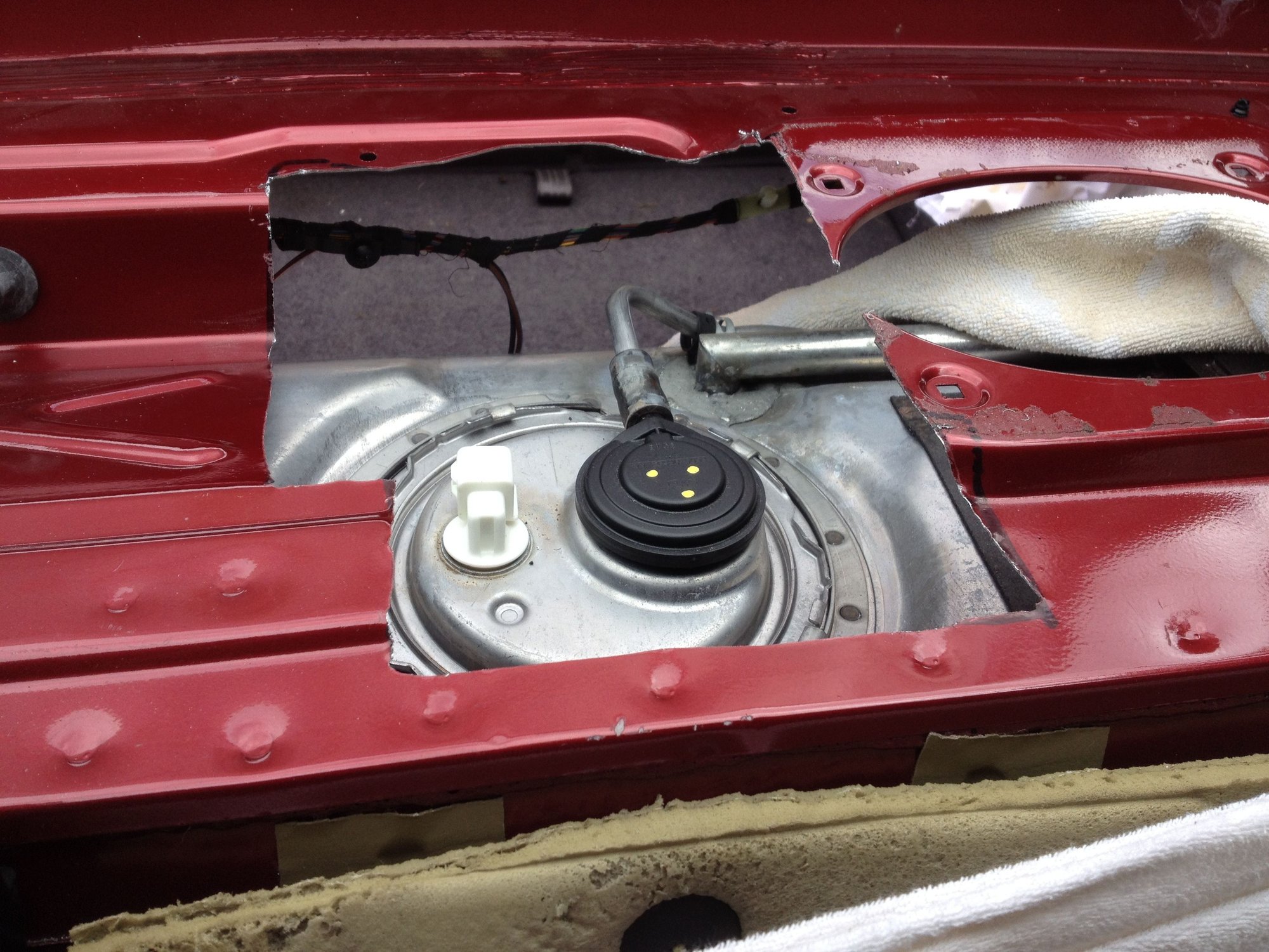

Warm, dry weather. Feeling better. Time to do the fuel pump.
Tank out; removed the exhaust pipe on the driver's side which gave a bunch more access without having to resort to dropping the differential cradle.
​​​​​Uhm. That doesn't look very good.
Pulled the pump and retainer plate out. Poke poke.
That's pretty grody. Scrubbed it down inside with a wire brush, flushed it out.
New pump. That'll do.
​​​​​​Test run successful. Filled the tank up. This pump is very quiet compared to the old one, which I managed to get running and drained the tank with before pulling it out. It was squealing, loose bearing noise.
Strapped the sub down (added two nice chrome marine tiedowns to the trunk floor base) so it can't go anywhere. Works well enough now.
