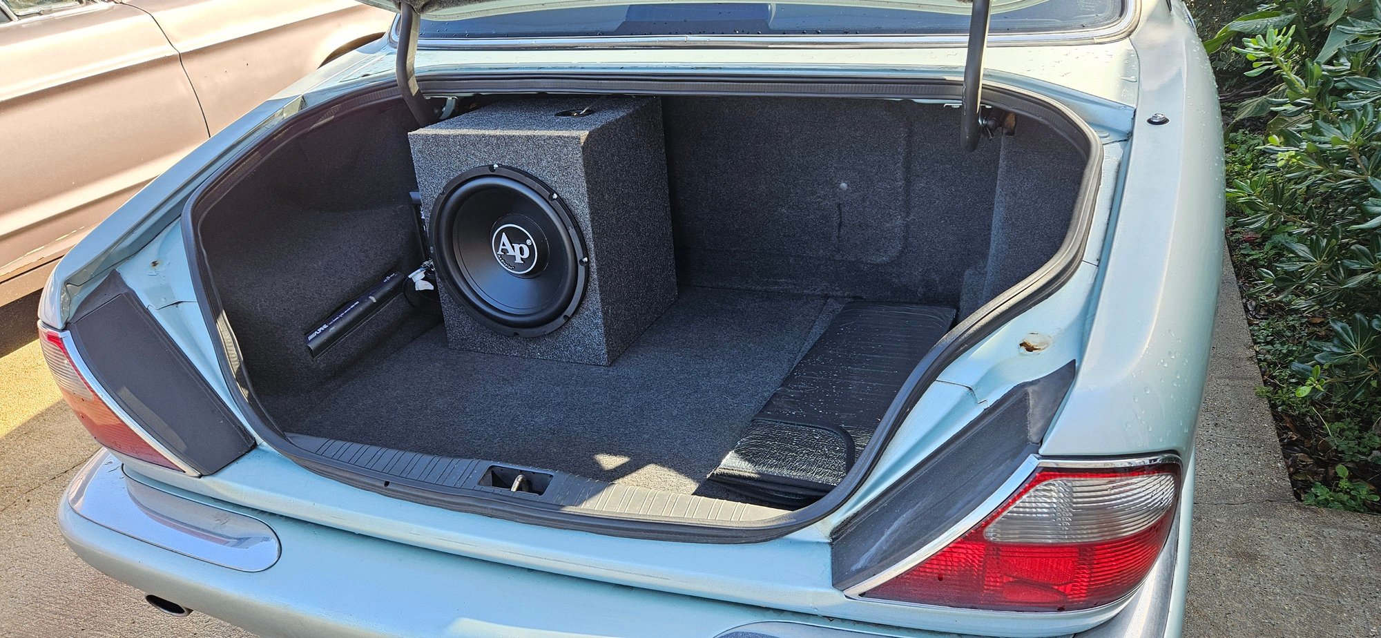

Added a sub to finish off the radio.
Adds the bottom end the mids in the doors just couldn't create. That works.
​​​​​​Don't got it dialed to buzz the license plate. Just enough to make the bottom end audible over the road noise.
