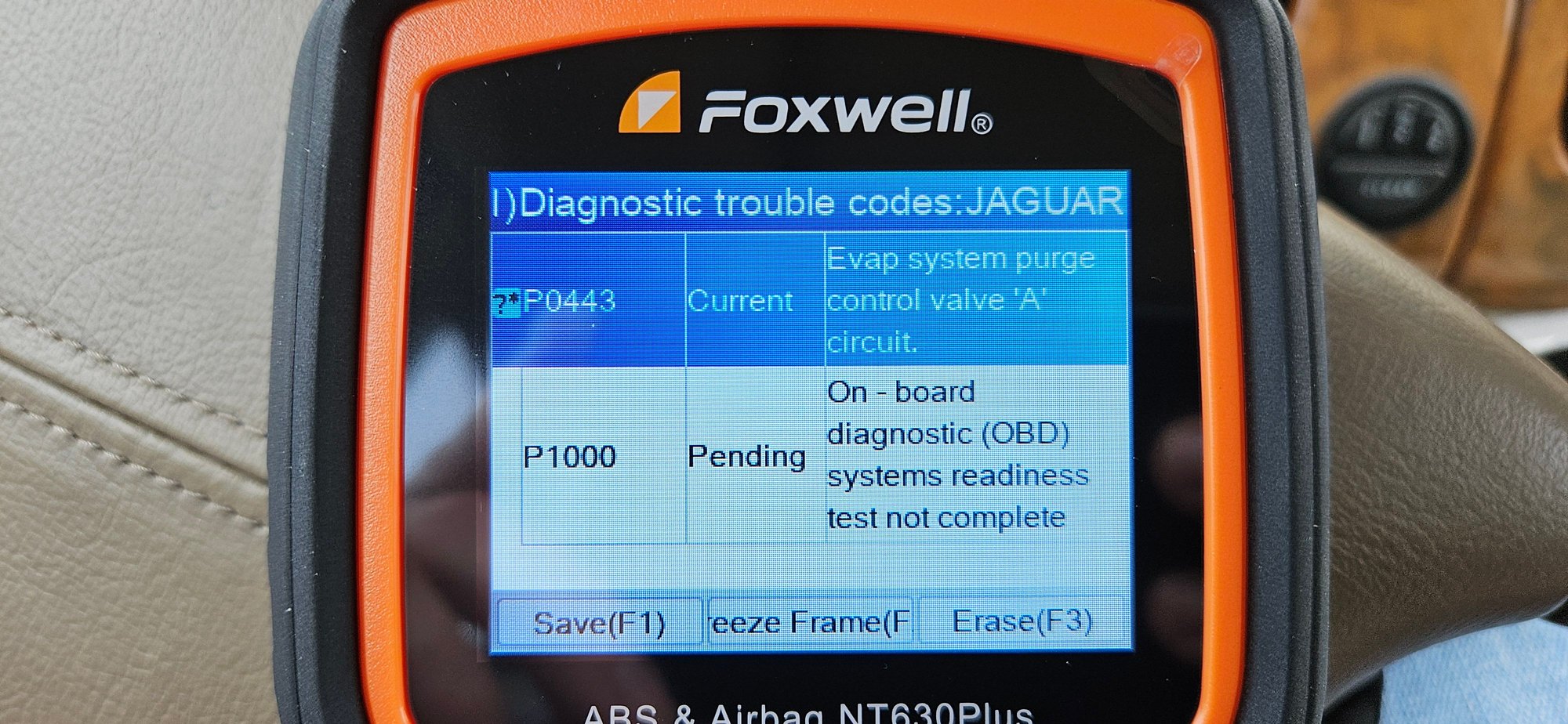

Ordered a Foxwell NT630+ reader.

The code should still be stored when your reader arrives though. Be interesting to see what it was.

Probably misfire. Maybe evap leak.
​​​​ That's my guesses

Who called evap system issue?
