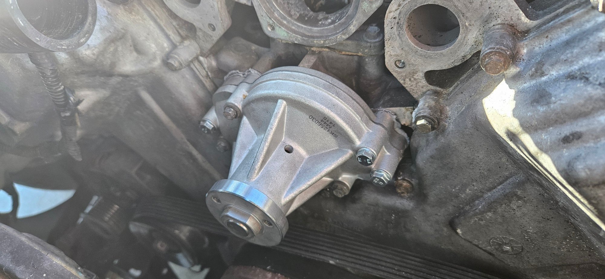

New water pump, secured with all bolts now.
Replaced thermostat, which was the problem all along.
Seems to be good now.

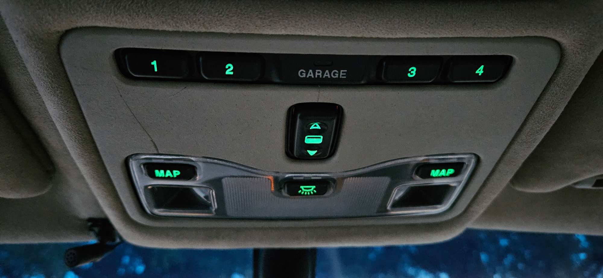

Lunchtime today I took the overhead console out and replaced the two light bulbs in the buttons which had ceased function, polished up the reflectors and cleaned the lenses.
It all works now, which is nice.

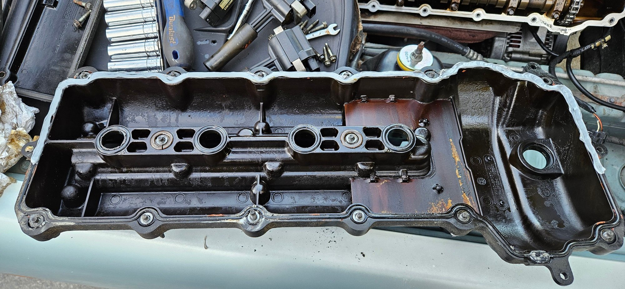

Found the source of the burning oil smell. Hiding under the intake pipework, rear corner of the passenger side cam cover was weeping because the whole thing is warped with age. Sealant only at the block/head joints? Nope. Full bead around the lower half. That should keep the oil in.
Cleaned the glass, added a little bit of adhesive foam to the top of the high level brake light to stop it chattering against the glass over bumps. Figured out how to set the station presets on the aftermarket radio that's in the car. Happy now.

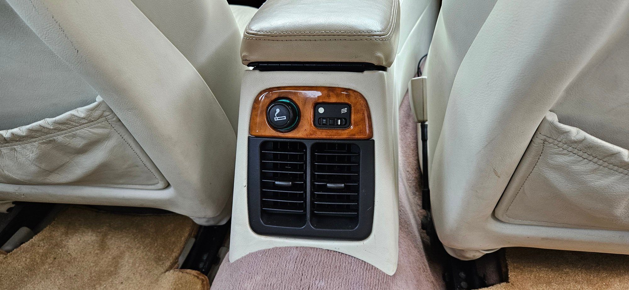

Optional rear panel installed, to provide the lighter socket outlet in the back.
Now, the two phone users who sit in the back have means to charge said phones. I have a USB plug-in for it.
That seemed the tidiest way to make that happen.
Phil
