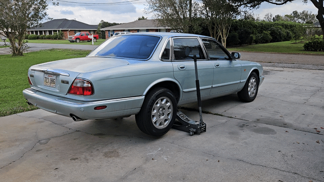

Originally Posted by Philip_A
Diagnosis: Begin!
Got the car jacked up, wedged the gas pedal down and went poke the stethoscope about. Right rear hub is noisy. Guess I'll get those on order.
Phil
Please tell me you weren't doing this with only a jack to support the car?
Old Nov 7, 2024 | 09:24 PM
  #5085
Philip_A's Avatar
Joined: Apr 2024
Posts: 272
Likes: 130
From: Larose, LA
No, there's also stands under the rear and chocks in front of the front wheels.
Just the angle I took the photo from!

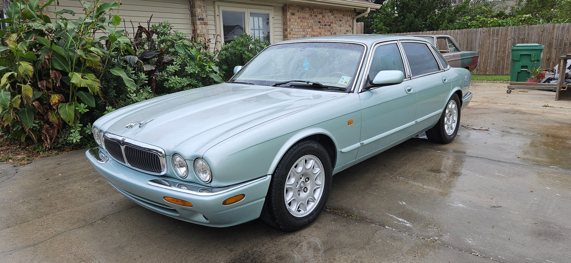

I washed it and made it look nice.

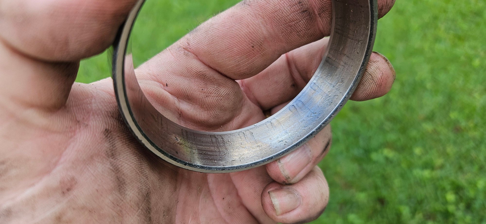

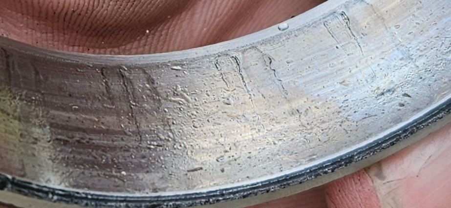

Welp.
That's wrecked also.
A closer look shows that was well past it's prime.
All new wheel bearings up back and the car is silent. What a difference. Also hard to tell where the noise was coming from.
Phil​​

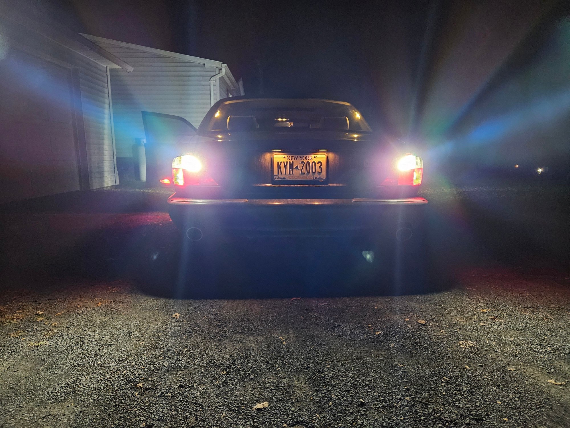

Installed some fancy shmancy LED reverse lights.
