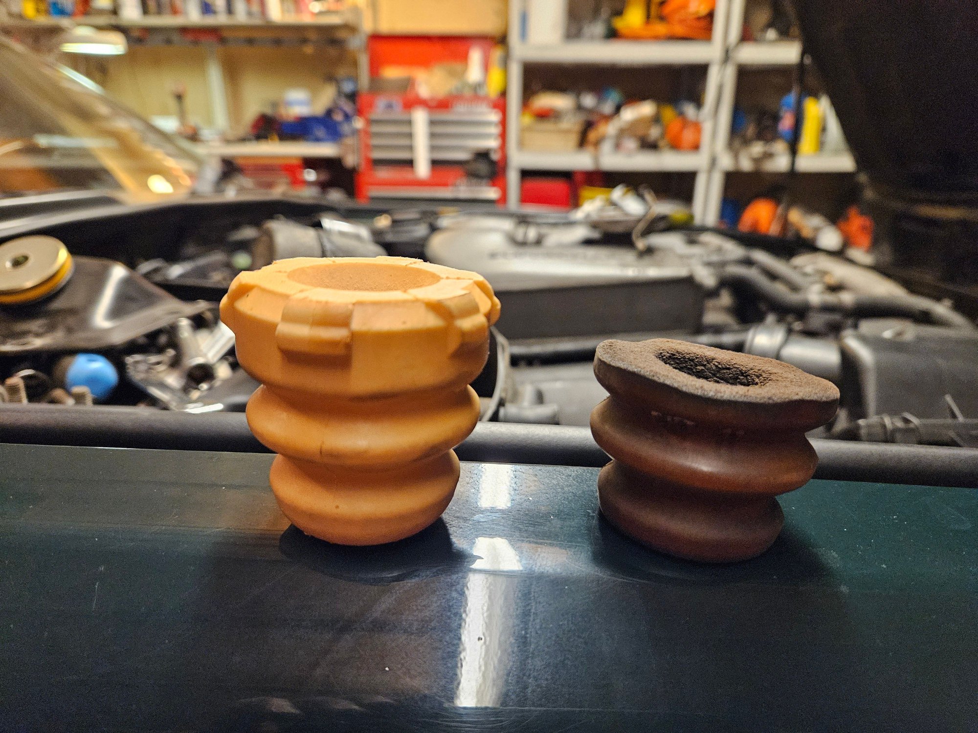

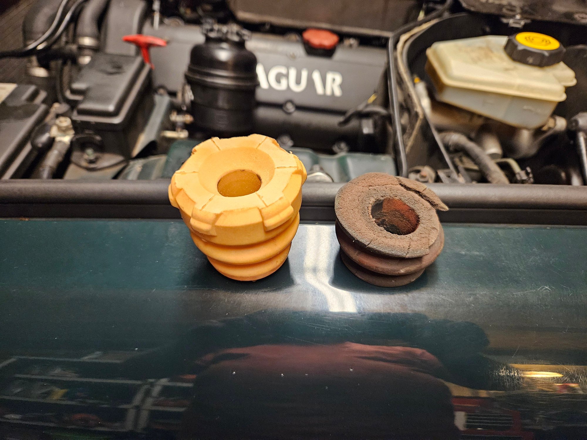

Technically not today, but Wednesday night I put in a warranty replacement power steering pump to get rid of the whine and I replaced the two bump stops on the front shocks. Pics below, maybe this will stop some of that clunking.
Waiting on ASI to re-repair my throttle body so I can't test drive it yet, but I'm anxious to see how it feels and sounds. Those old stops might just be original...bet the rear ones are worse.
Where did you pick those up at? Mine have disintegrated.

https://parts.harperjaguar.com/
Seem to have a decent supply of OEM parts.

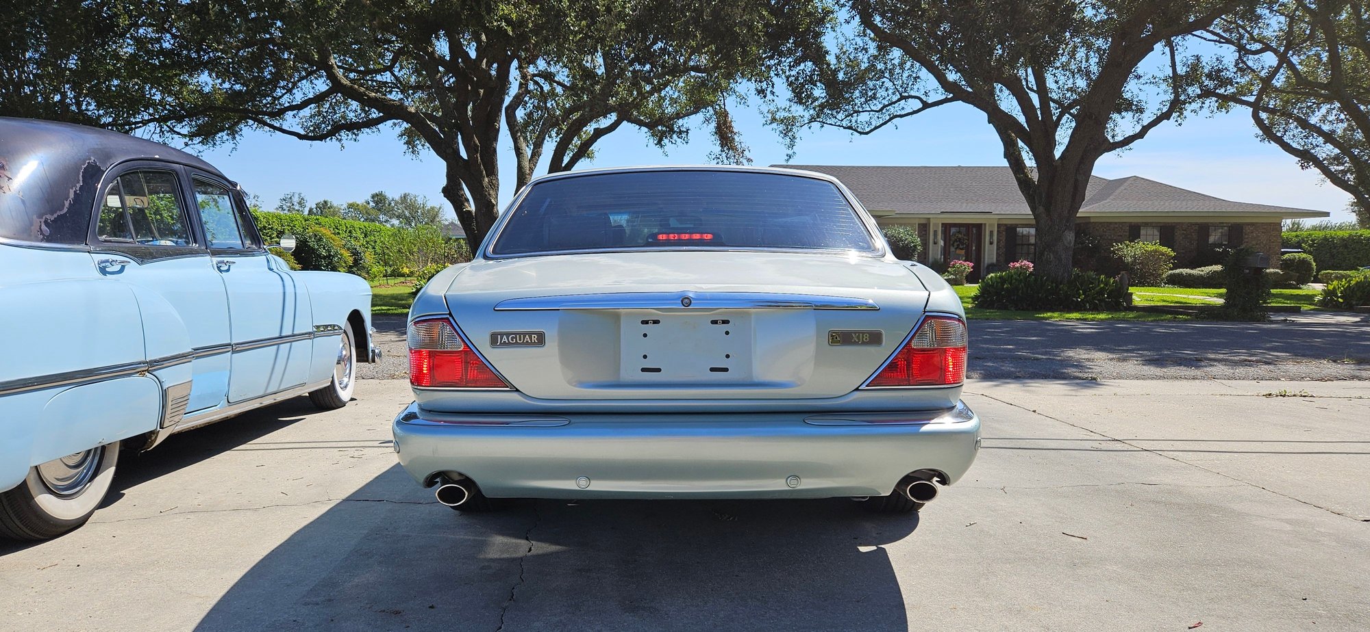

Fixed the high level stop lamp. Needed a few bulbs and found a suitable size thing to put underneath it (35mm film container).

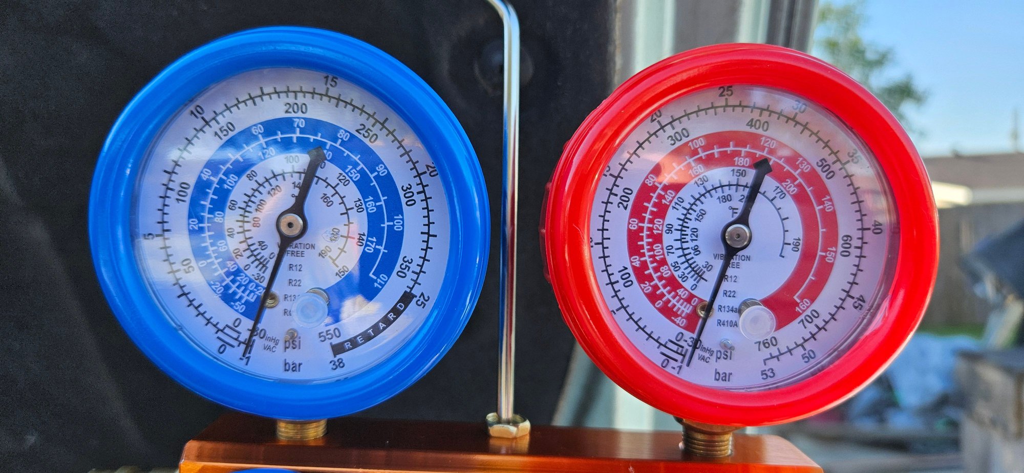

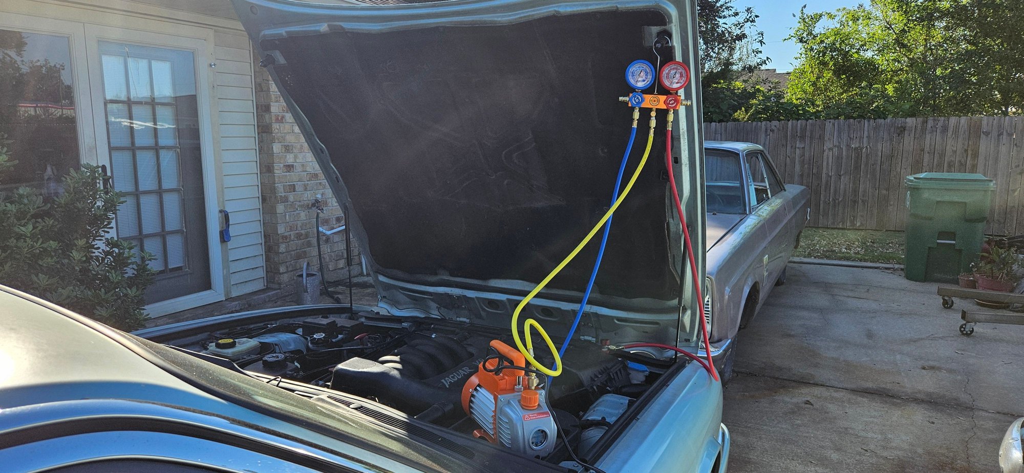

Vacuumed the aircon system down.
It held a good vacuum.
Refilled it, 20oz. Pressures exactly where they should be. Ice cold air from the vents.

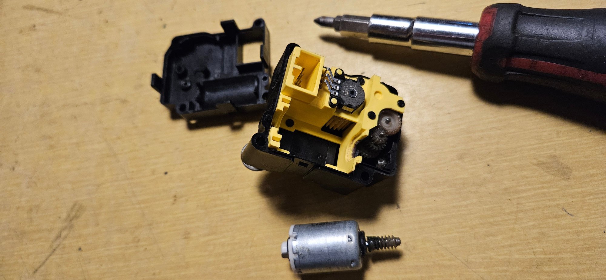

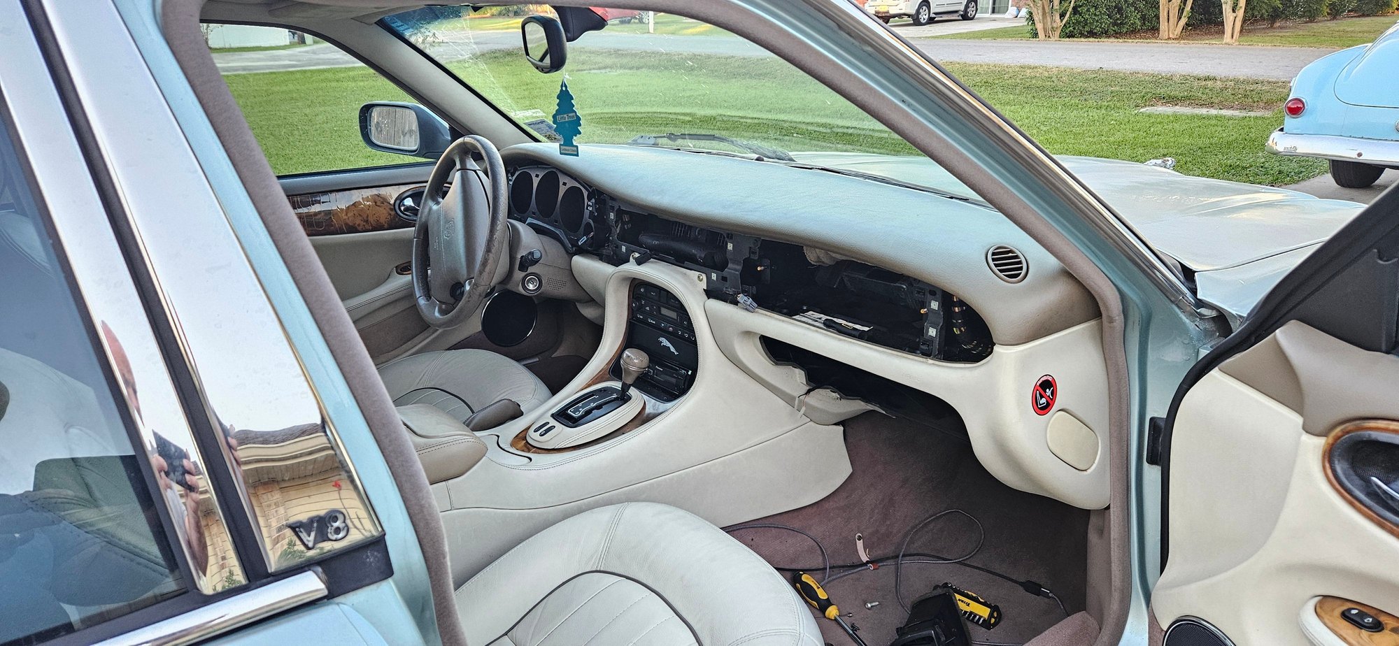

Pulled half the dash to bits to remove the face vent damper actuator motor on the airbox.
Obviously they didn't intend on this being worked on with the dash attached. Pft. A small amount of violence and the actuator is out.
Pulled it apart, discovered the motor wasn't doing anything (not even drawing current) when connected to power, so I took it apart and cleaned the brushes and commutator. Now it spins happily and the potentiometer works. Just need to put it back in now.
