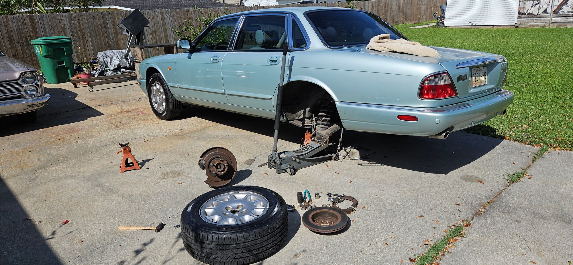

Replaced the hub bearings. The inner race was toast. Back of the car is still noisy, so the other side is likely up due.
Hoping I'm not going to have to do the diff bearings.
Phil

Hub bearings done. Still noisy, though the noise has changed.
I took a look at the information on the 4HU and as usual the factory manual is not great; the thrust bearing that takes the weight of the car from the driveshaft is the one that sits behind the solid block you have to drill and chisel to remove?
I need to get a stethoscope and poke up against the bearings to check which one's noisy. This is just a regular vwa-vwa-vwa that goes quiet on a right hand curve. Thinking the axle bearing in the diff is the culprit.
Phil
