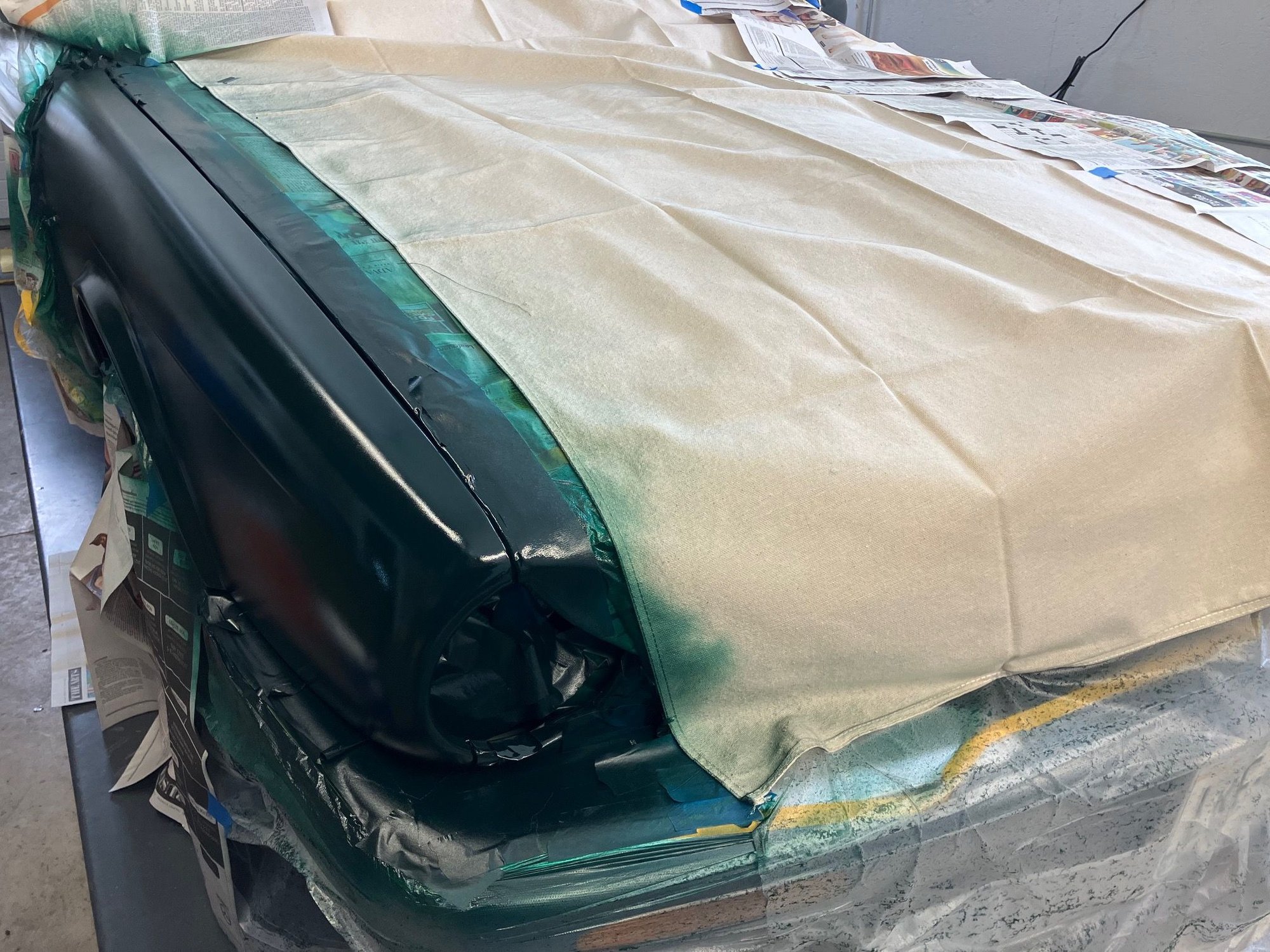

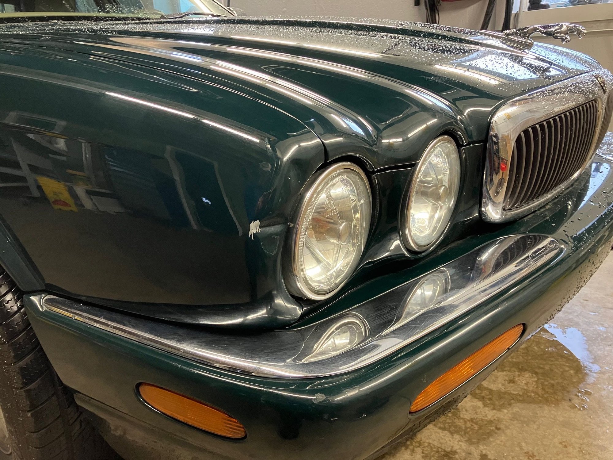

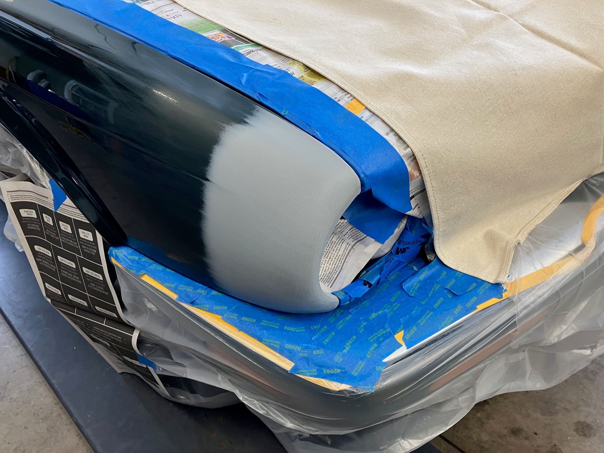

Today's task was to repair two small dents on the edge of the passenger-side headlights. Filled, Sanded, Masked, Primed, and painted. Tomorrow will be wet-sanded and the final polish. Those two small dents were the only imperfections in an otherwise pristine exterior.
The effect was that of a beautiful woman who smiles, and is missing a tooth. It was just wrong.
The dents.
Filled and primed.
Two base coats of British Racing Green
Five coats of lacquer before polish. It needs to dry overnight before final polish (tomorrow's task).

That was a very remarkable transformation. Surely makes a tremendous
difference in curb appeal.

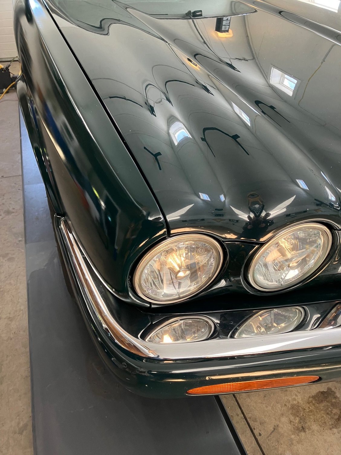

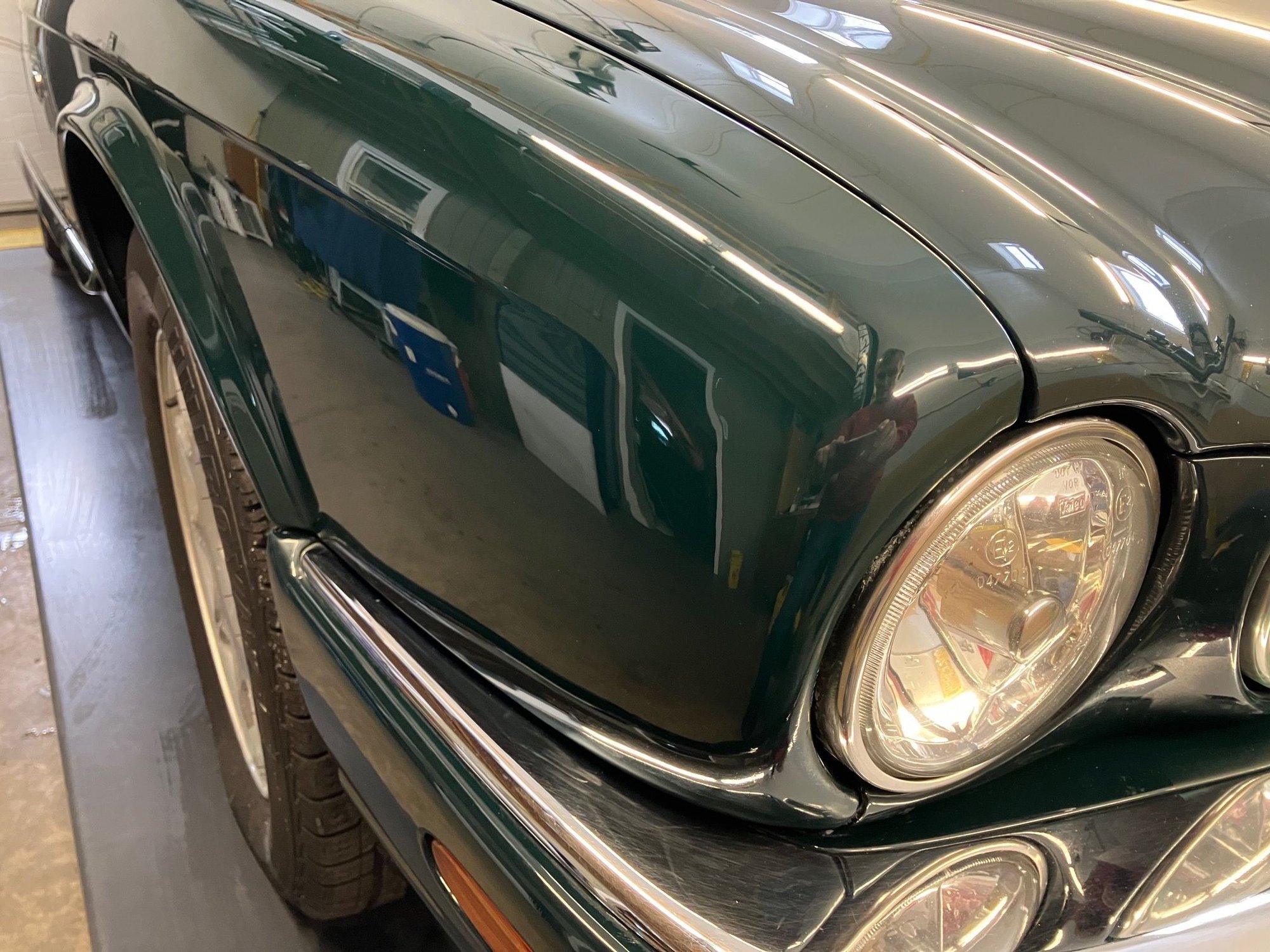

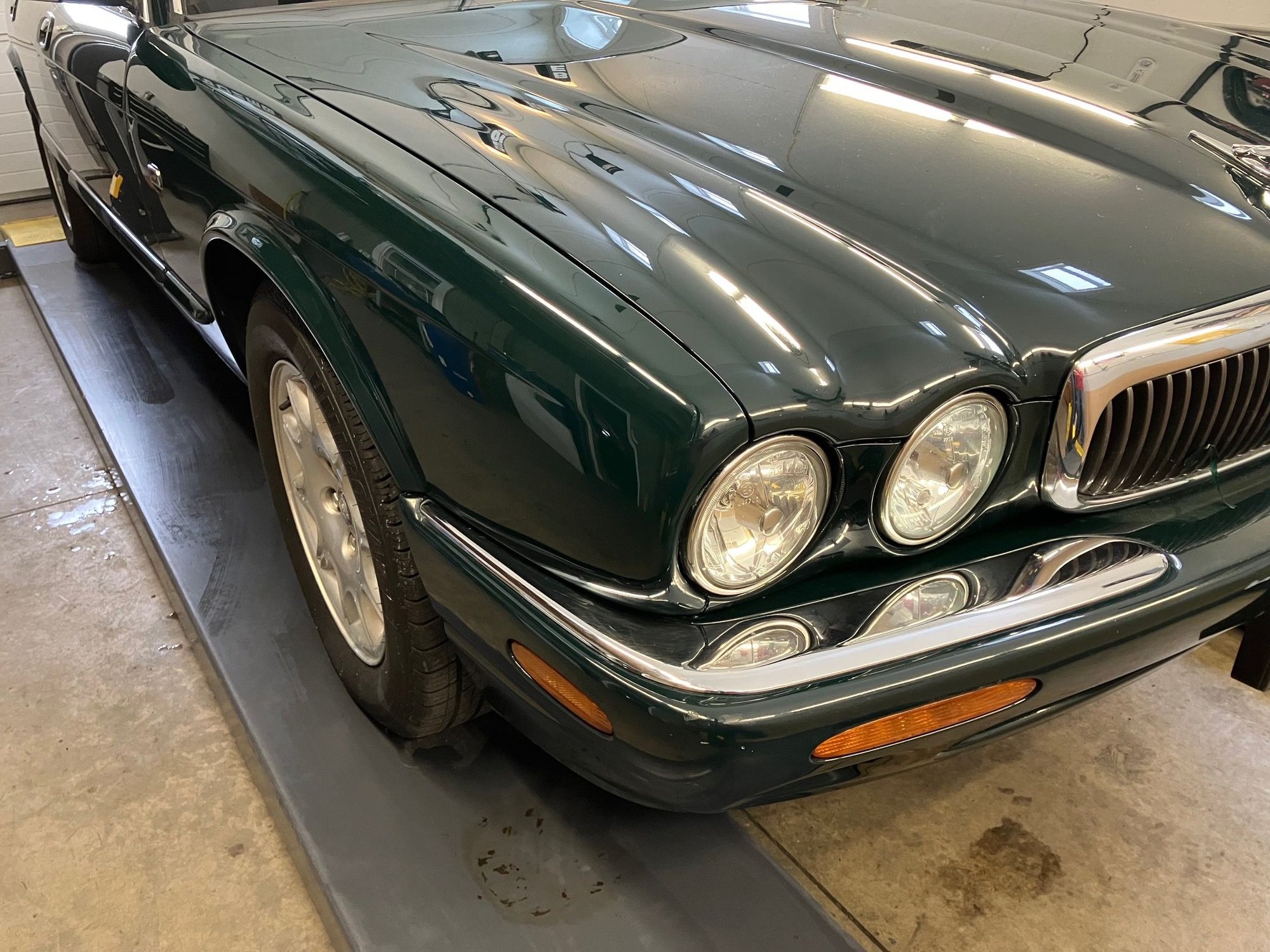

And here it is after wet-sanding and polishing.

Nice repair. Well done!

Interesting car to work on. I have not worked with body metal this thick since my 1949 Chevrolet 3600 pickup. Definitely not the pop can fenders on the typical modern car!

Most people obsess over getting the application part of paint perfect. That's probably the least important. Getting the surface prepped is key. After that, you can use a rattle can if it's from a good producer. As long as you follow directions, don't goop it on, and have a clean surface and environment, the rest is just patience and elbow grease AFTER the paint is on the car. For me, it's a bit like drywall seams: someone really good hardly has to sand it. Me? I spend a LOT of time very slowly wet sanding with 1500, then 2500, and finally 5000 grit to remove any orange peel or other imperfections, always stopping and carefully checking along the way. Then it's just a few more minutes to polish the paint. If you missed any imperfections you'll see them now, and if so it's back to sanding that area again. It's slow, but it works for me. Never had to do a job twice, but you'd not want to pay me by the hour. I repainted the entire fender. To do the entire car would likely take me about a month or so, one section at a time. But, it beats paying someone 7 to 10 grand.

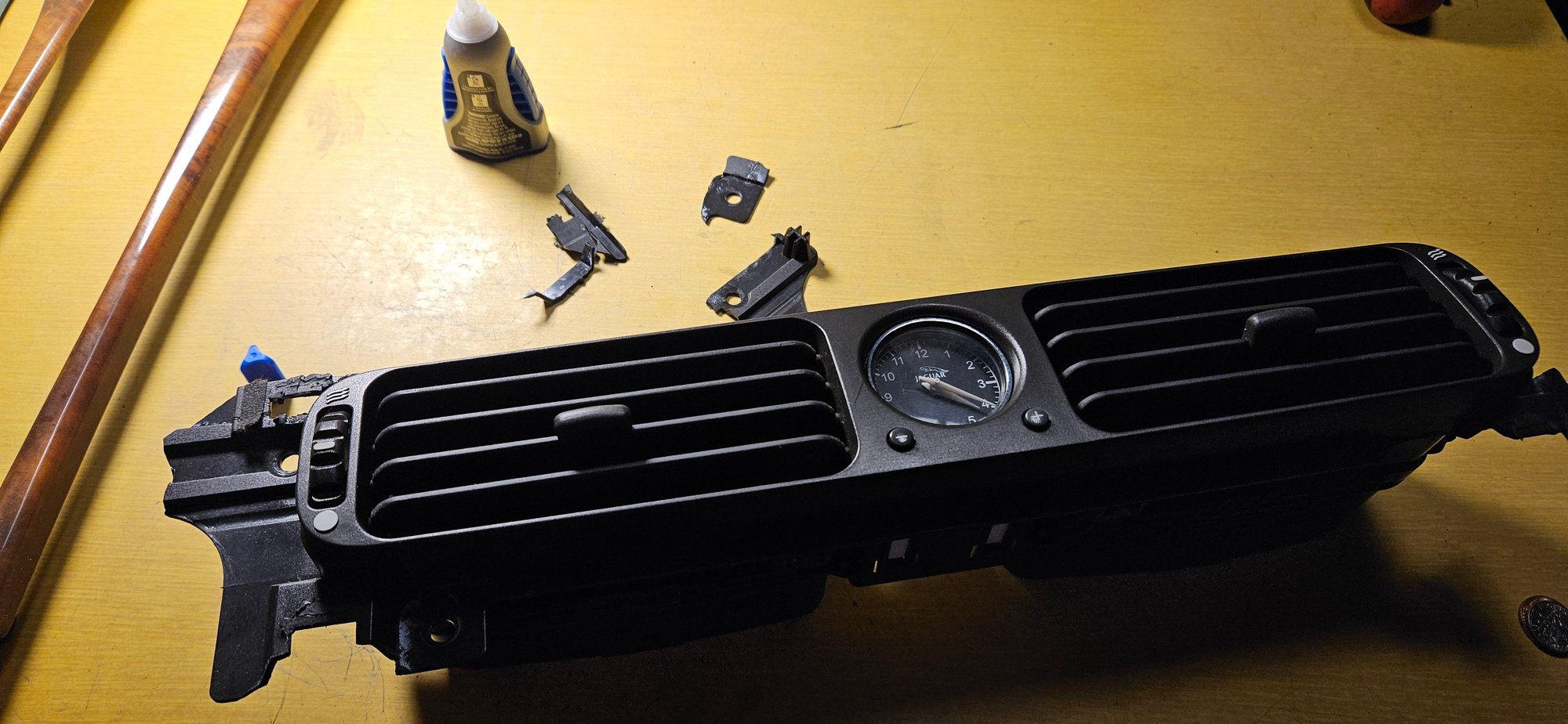

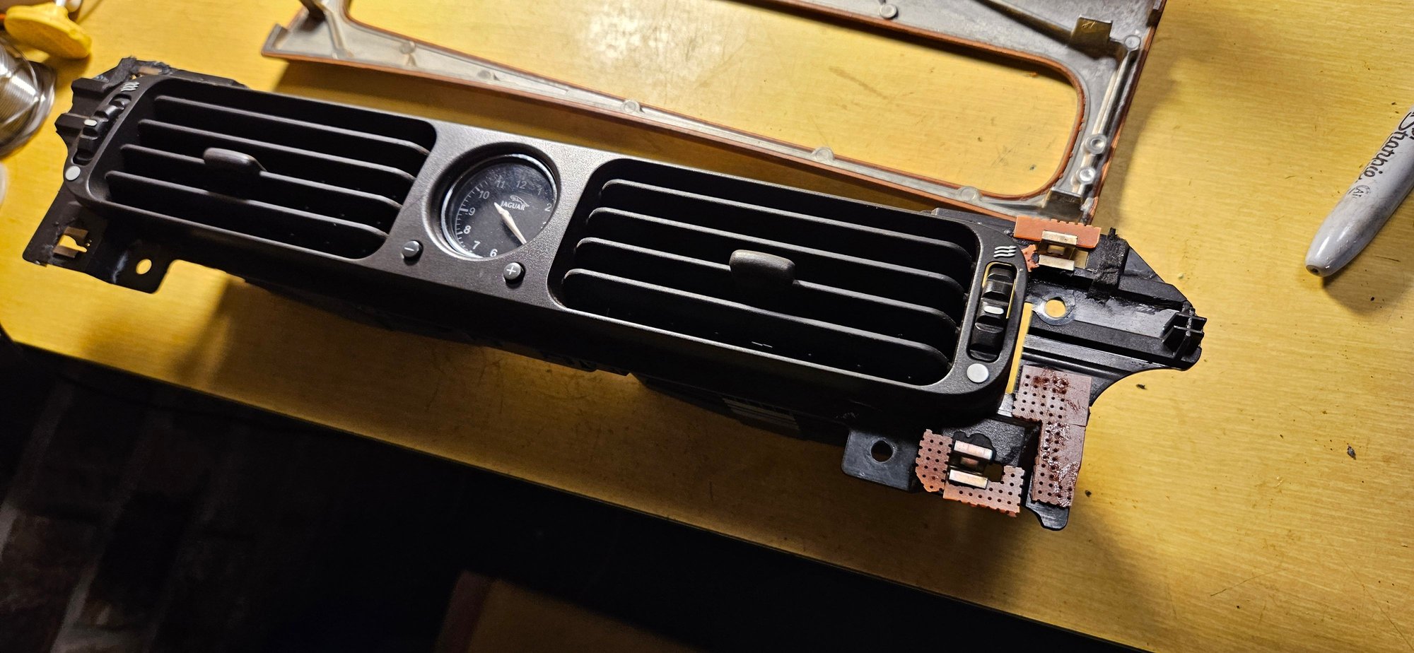

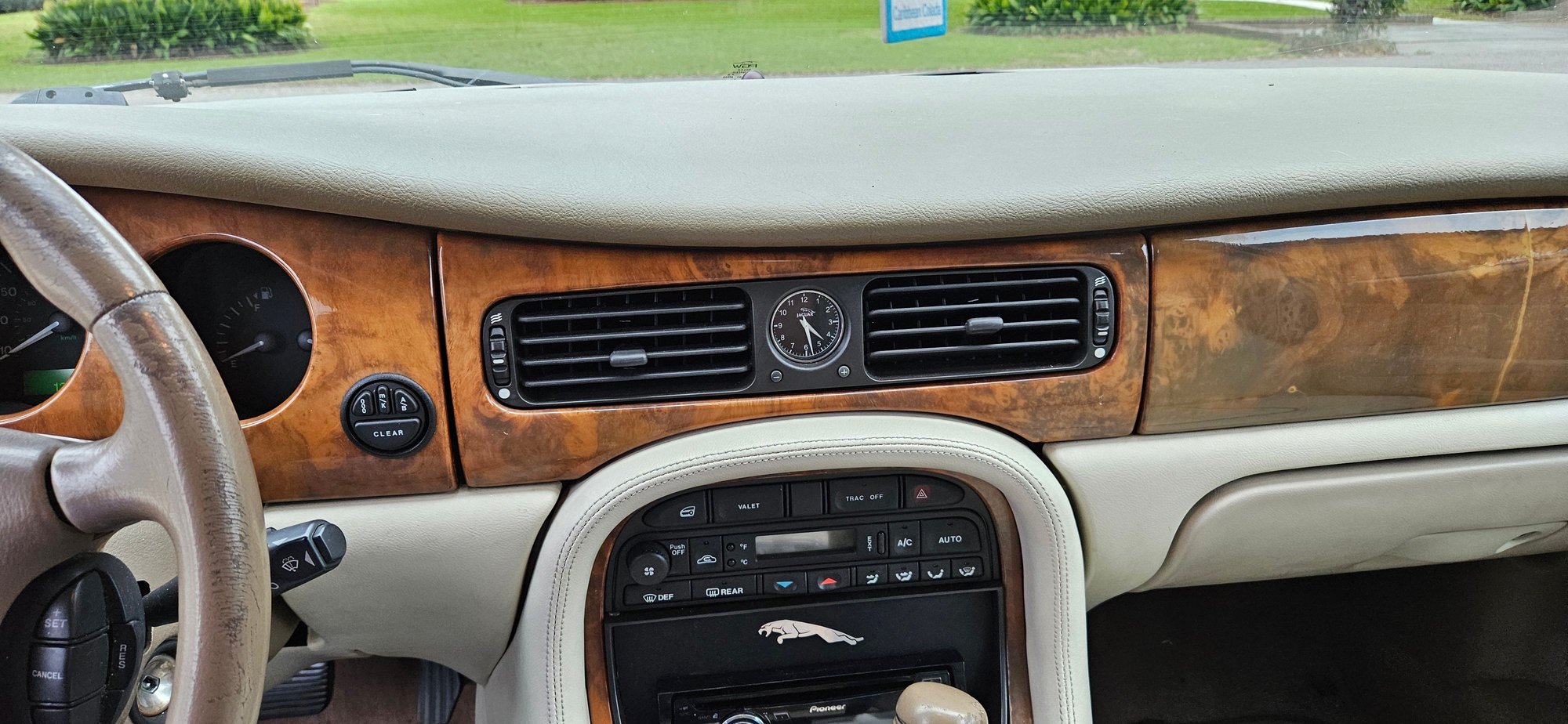

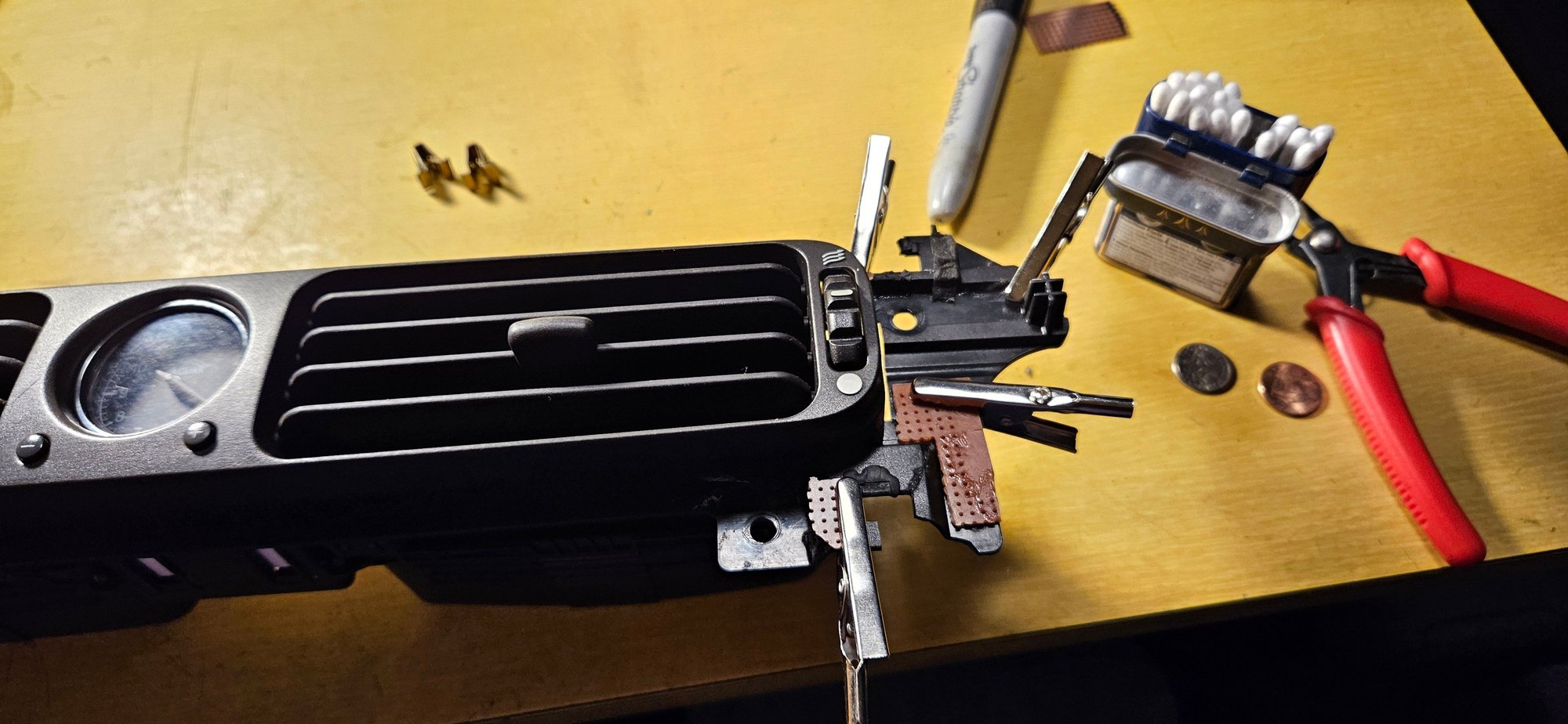

I had to pull the center wooden panel the other day to remove the center console and armrest assembly. Crunch pop all the plastic broke again.
Removed the backing box and grilles. Started supergluing my fingers together.
Decided to reinforce the broken sections with some bits of circuit board because that was what I had to hand that's fairly tough and I know accepts glue well.
Strong enough to hold the spring clips again.
Net result: dash doesn't fall out when I accelerate hard now. Only made slightly crunchy noises pushing it back in.
Good enough.

Great idea reinforcing. I should have done the same when regluing a broken bracket ( I also found it like that) in the AC panel just to be future proof.

Yeah, know what you mean. The panel that came with my car had no arms. It just kinda floated in place. The replacement for that because one display driver chip had quit has one, at least. It's better...
