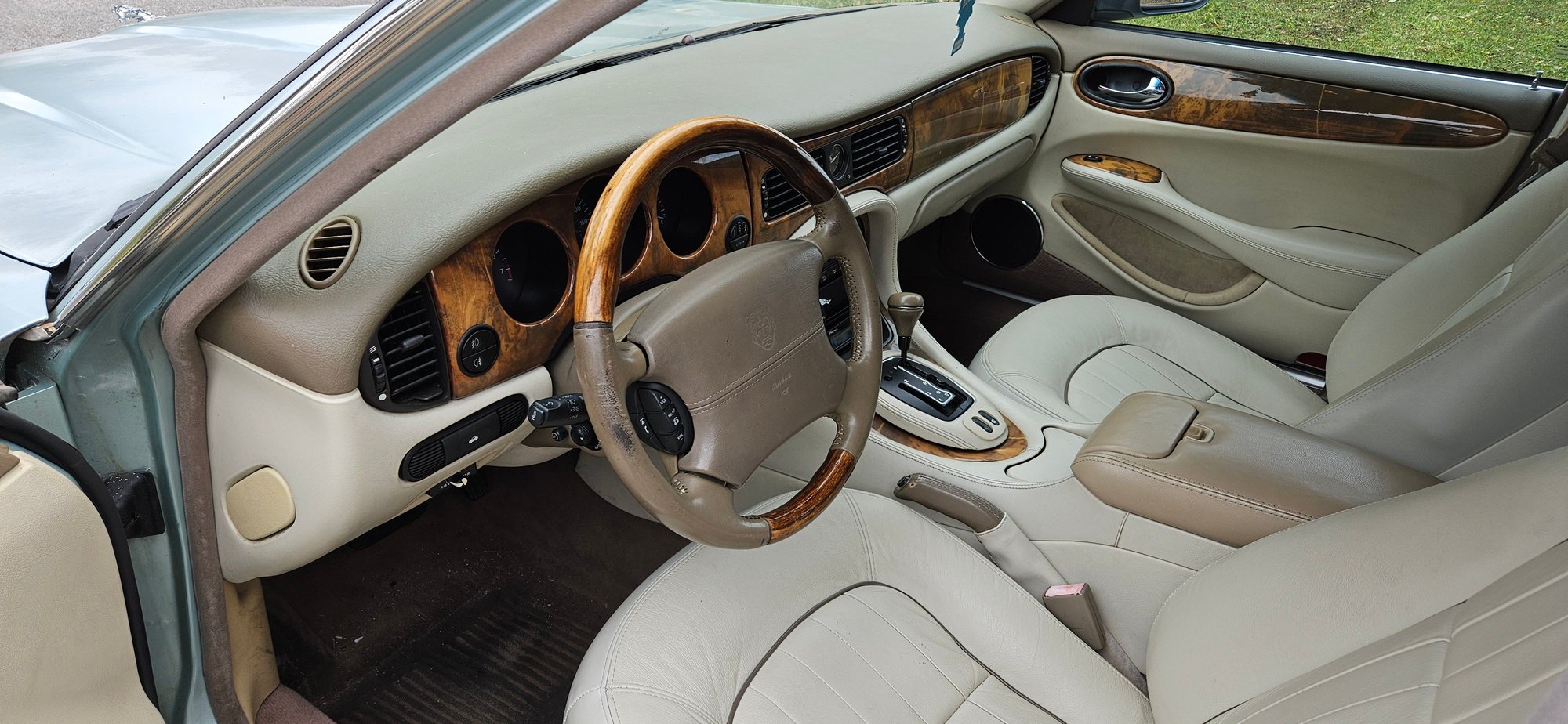

The old steering wheel was horrible to hold, the top surface had gone through. So, ebay to the rescue.

If the leather is still in good condition, this .. was not.
I like the half wood wheel better anyway so I'm happy with it now.
