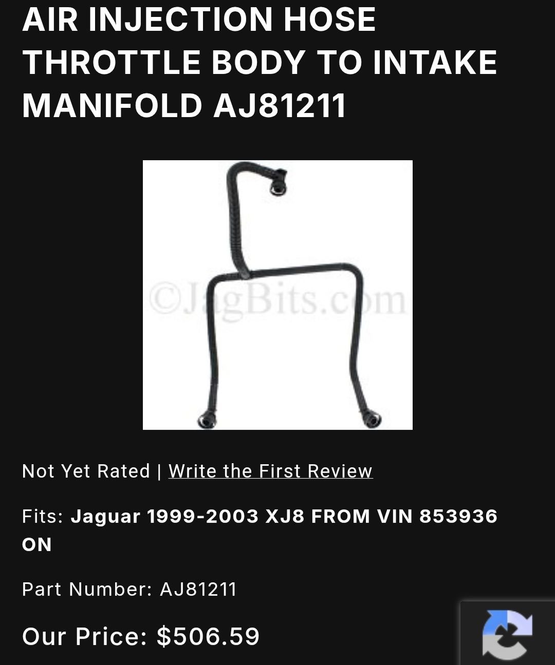

Replaced the 500$ hose for 20$ unfortunately my car intake manifold was broken and caused vacuum leak so I had to either buy new one for 500$ or do something I used 1/2 transmission hose which work great I had silicone hose but it shrinks the transmission hose better I used plastic T and kept the hose connectors to install the 1/2 transmission hose works great

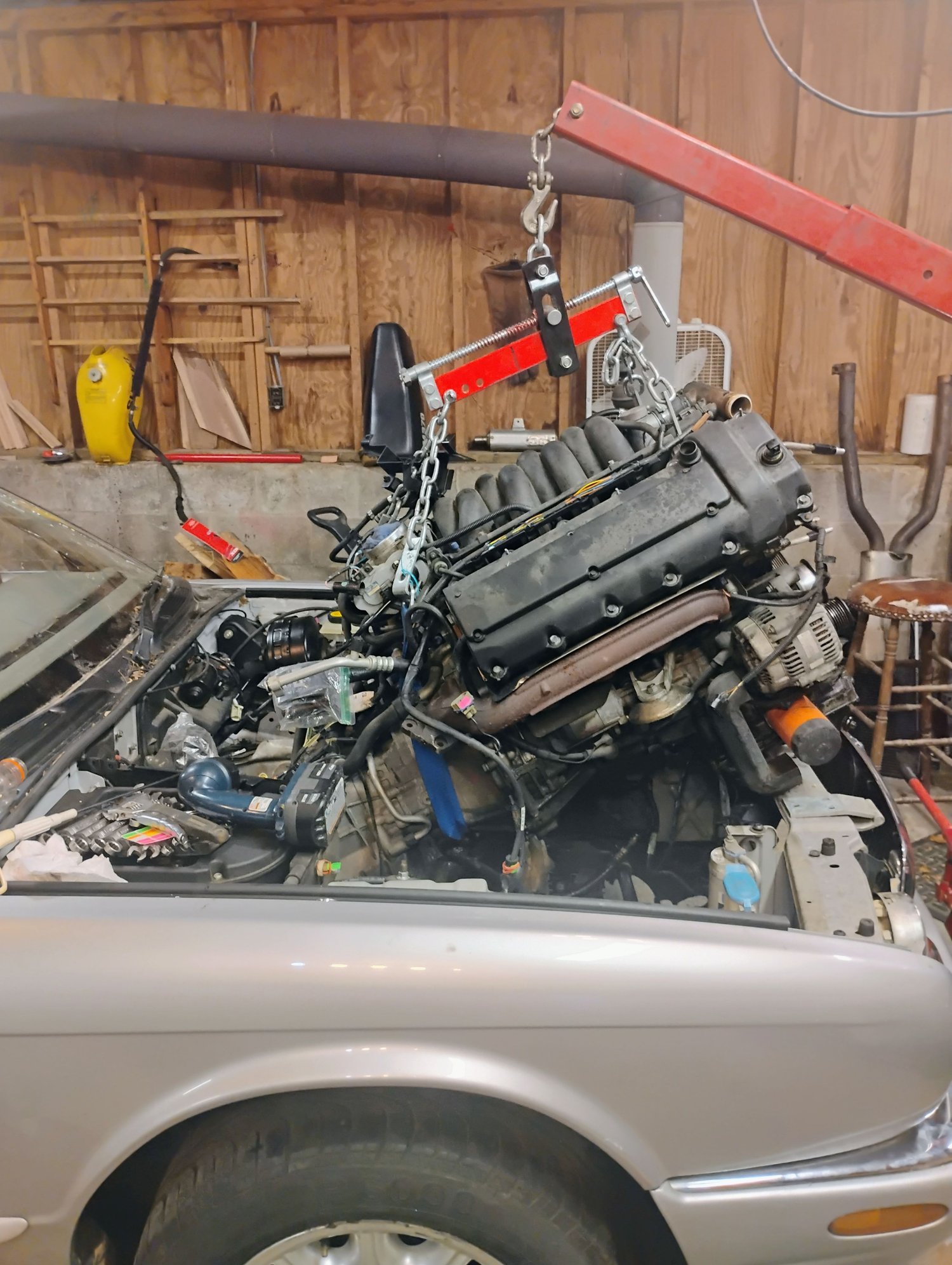

Default engine out
i got the engine out of silver, im gonna replace some seals and maybe timing chain tensioners, anything you guys may suggest? and put this engine into a 99 vanden plas. Thx everyone for encouragement.
split the transmission from the engine. Pull the flex plate off. Replace the rear main seal and oil gallery Dowty washer. Those two are engine-outs to do. Might as well do them now. Inexpensive.
Do you have the tools to do the timing chains?

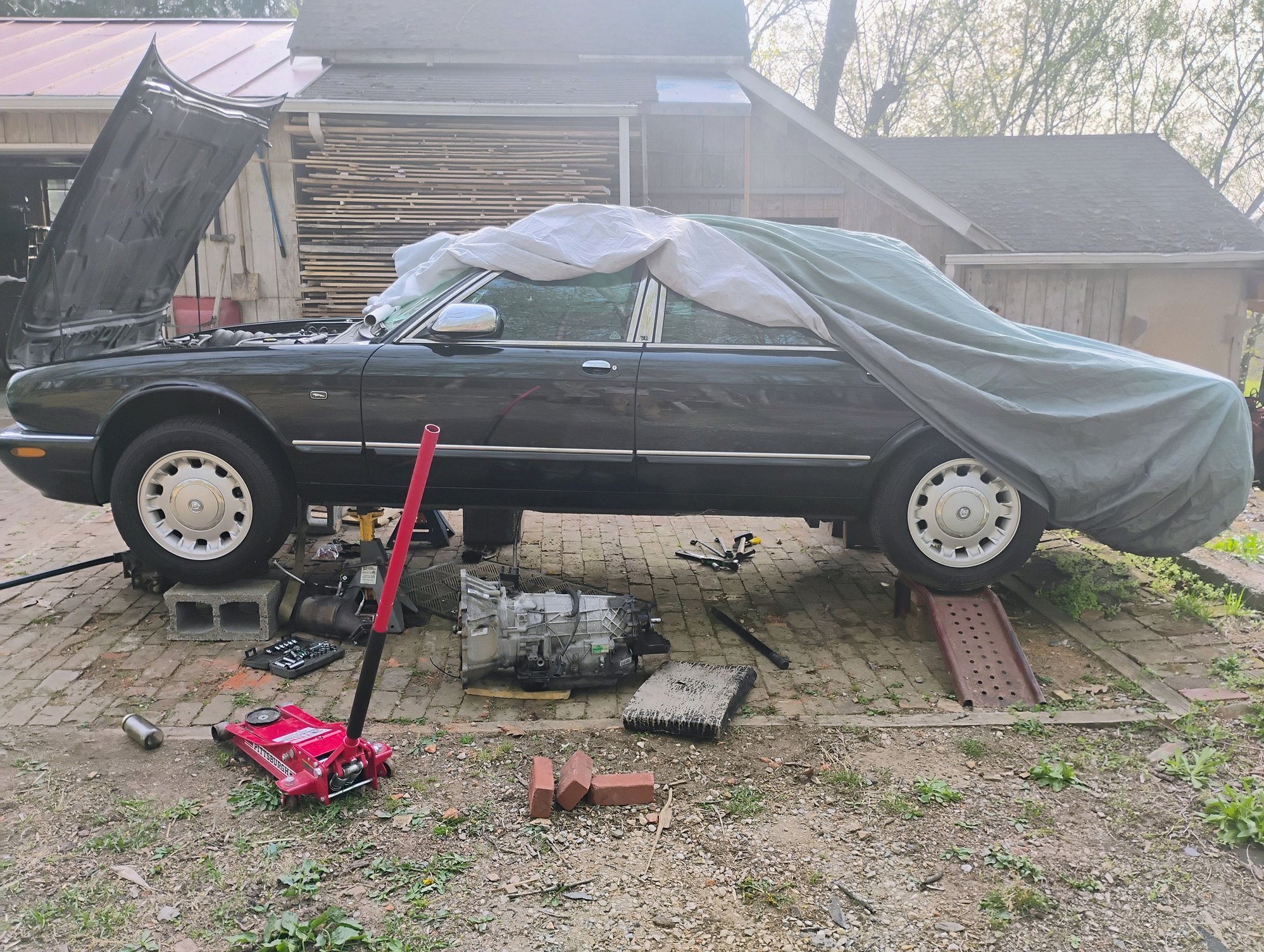

Trans removed ( giving it to friend). I will remove engine and install engine and trans from my wrecked silver xj8 into this Vanden. I'm in over my head, here we go.

Its on. transmission separated, engine on an engine stand. gonna replace main seals and whatever other seals i can. gonna look at timing tensioners.

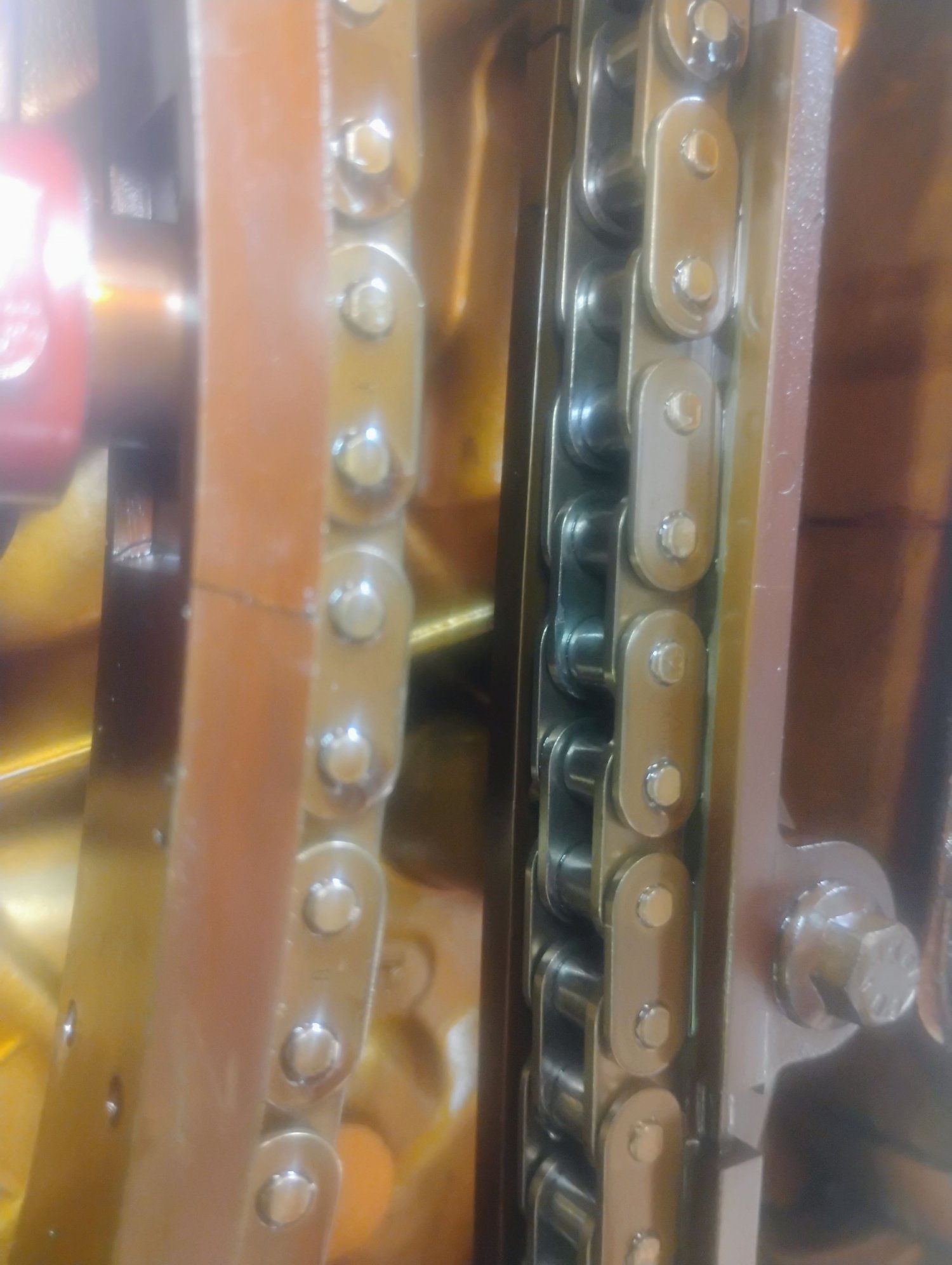

Default engine swap - tensioners
The Odyssey Continues,
2001 xj8, serial 001104
While I have the engine out I want to fix what I can and am working on tensioners and guides.
I did some parts research and am overwhelmed with options. Buying parts individually is very expensive and prices (probably quality too) varies wildly. The kits I've seen all come with chains.
I'm in "analysis paralysis".
The OEM chains on the engine (114 K) look good so I wasn't going to change them but all the parts kits I've seen come with chains.
Can anyone suggest : A parts kit, and, should I replace the Chains or go with the OEM currently on the engine?
THX in advance, jeffxj8

I used the kit from DNJ Engine Components.
https://enginecomponents.com/product...9l-4-4l-tk4163
Bought it on Amazon, along with the tool set to do it all (barring the big torque wrench to do the crank pulley up)

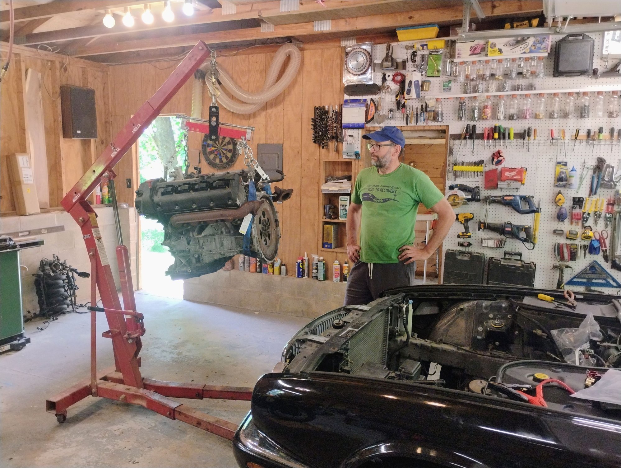

Default engine from vanden
motor swap operation continues. i removed the bad engine from new to me 99 vanden plas. I'm waiting for new tensioners etc, for the motor from the crashed 2001.
