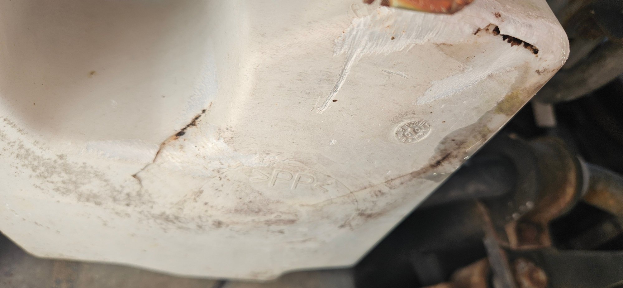

Managed to break the screen wash bottle on a high curb.
I see JB Weld in my future.
I did the same on a snow and ice rutted land a few months ago. I'm lucky that my indie has a new in "in stock" that a customer never picked up so it get installed along with a few other catch-up odds and ends when he's finished with the catch-up odds and ends he's currently tidying up on the Series 3 VDP.

get something elastic otherwise it won't hold for for long

Yes...it is for sure that bottle placement could have been engineered a bit better.

Old slowly disinitegrating polypropylene. Waiting for it to fully drain out and I'm gonna slap some sealant on it.

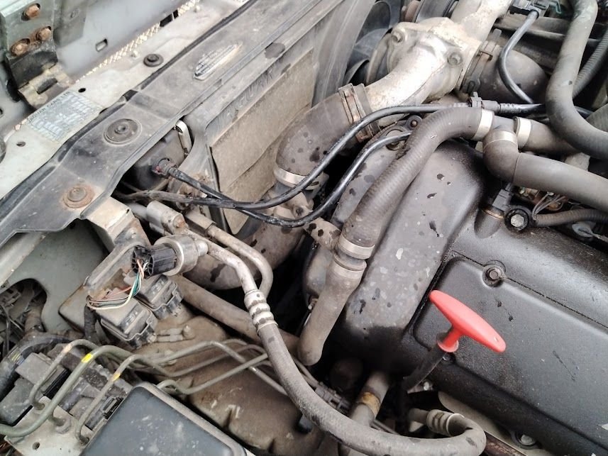

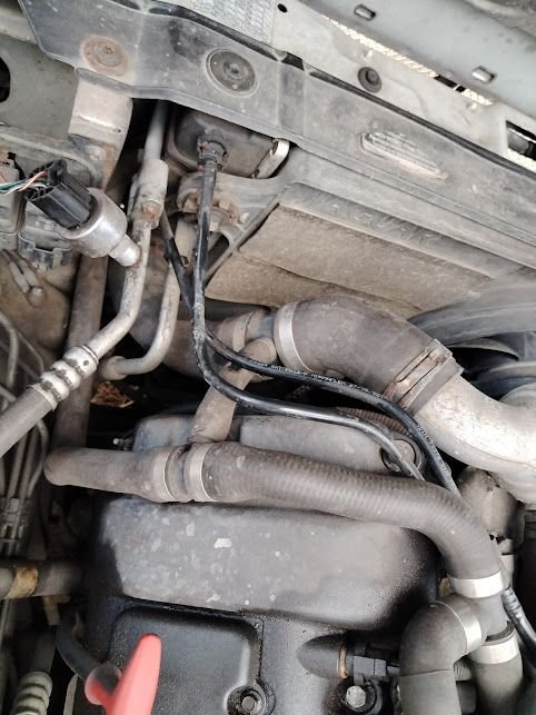

My XJR got put in a garage this week for replacement front spring pans and a coolant leak I just couldn't see.
I collected it this morning, having been told they've put a replacement front spring in too as one was broken. that's cured the pulling to side under braking at least. The coolant leak was fixed* with a new small hose off the expansion tank. When almost home though the low coolant warning came up...
That turned out to be a bit of a blessing as I poked about to see which hose they'd replaced and found one had been misrouted behind an AC pipe. That caused the small hose to rub on a different coolant hose and it already had a 1/8" deep half moon worn in it. So I've rerouted that correctly, much better to have found it than the hose burst when driving about. Topped the coolant up too and I'll continue to monitor it for a bit, I bet they just didn't bleed it right as you have to fill the intercoolers as well despite it all being the same system.
This before, if you can see the clean bit on the medium hose where the small one was rubbing.
And after rerouting so they're well apart from each other. It also means it's not rubbing the AC pipe or side of the rad as it connects to the front. The hose that was rubbing is now the furthest away from the medium pipe.

Slapped some Lexel sealant on that. Shall see if it holds.

I did some part number matching up & found bleed hose the garage replaced on mine wasn't the misrouted one, but I know they touched it as the joints both ends have got fresh red grease on. I found the hose for £28 so I've ordered it & I'll replace it. It'd cost me half that just to drive to the garage & back to show them the issue, so it's not worth the hassle.
