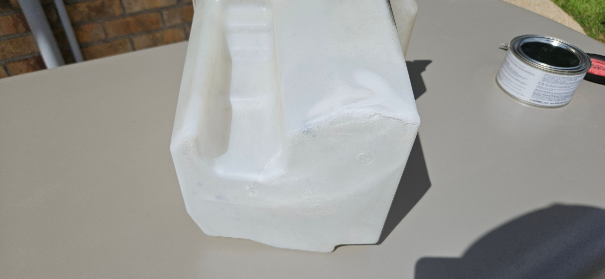

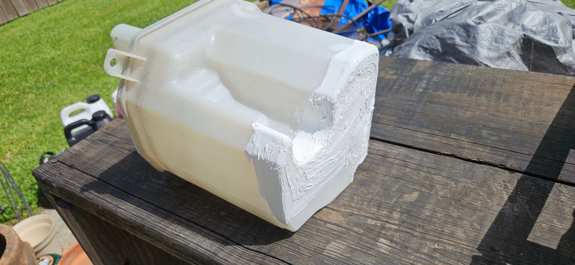

Cleaned up the surface with a wire brush to remove the oxidized old plastic. Applied rubberized putty. That's curing now, 48 hours it says on the tin.

That looks very well done. My past experience with degraded plastics is less
than stellar. If this works for you, I would be very interested in the patching
material used.
material used.
It's holding water so far.
Ace Hardware. $15
Longevity test begins today.

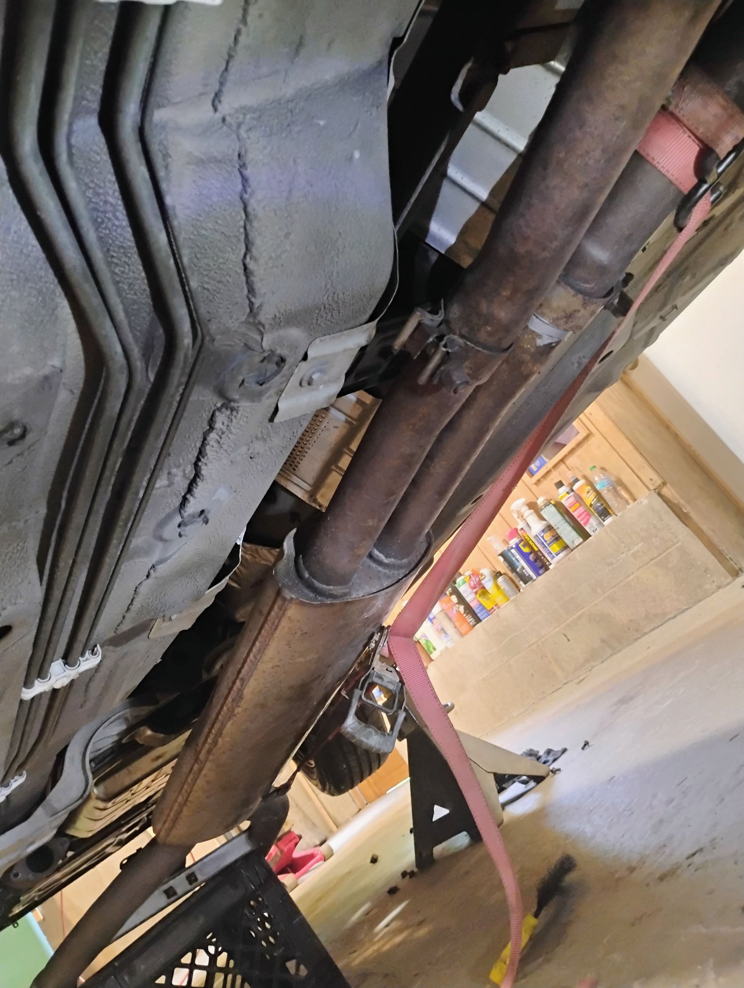

The engine swap odyssey continues.
Heat shields on CATs were a puzzle.
A clever, if I do say so myself, solution.
I used a ratchet strap to pull slip together exhaust unions together.
I'm getting close to turning the key, but keep finding more things that need to be figured out and connected up, radiator / hoses, power steering, AC dryer / lines.....
I'm stoked, Jeff xj8
It will run with the exhaust disconnected.
It's not quiet. Ask me how I know.
Don't forget the hard line that runs all the way around the throttle body base for the brake booster. It does not run well with that disconnected...
