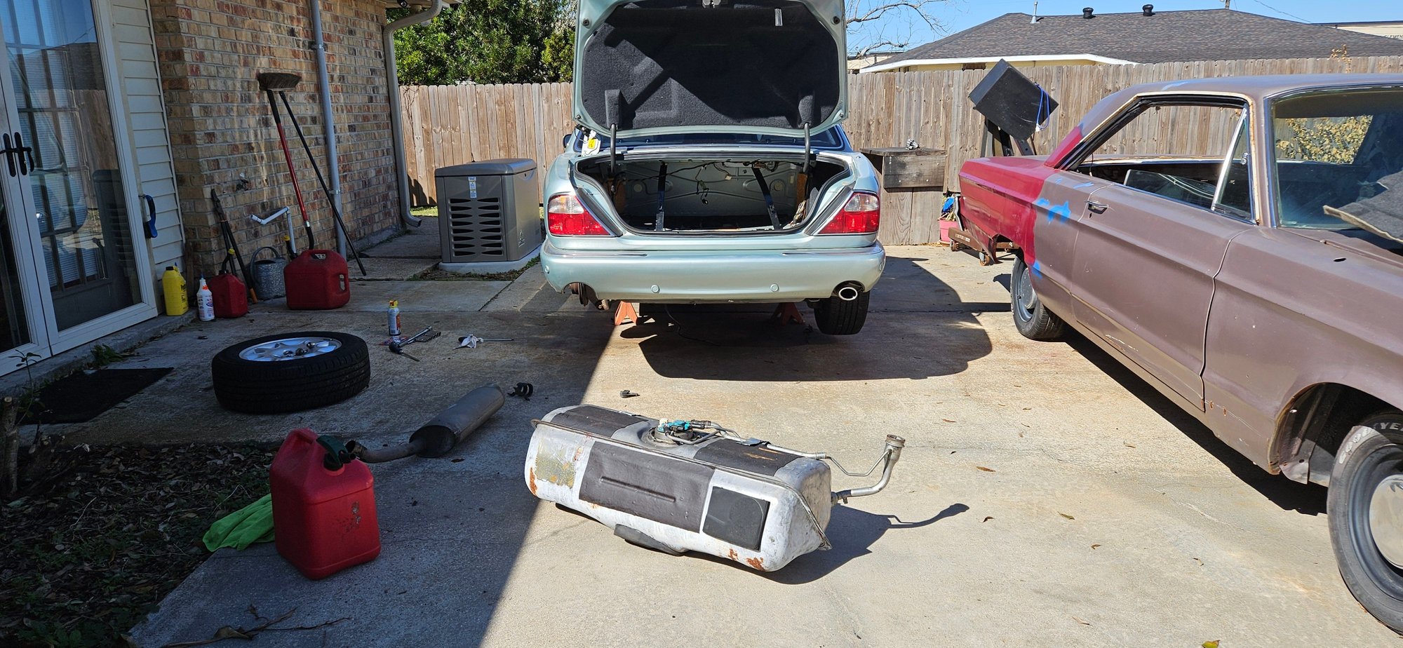

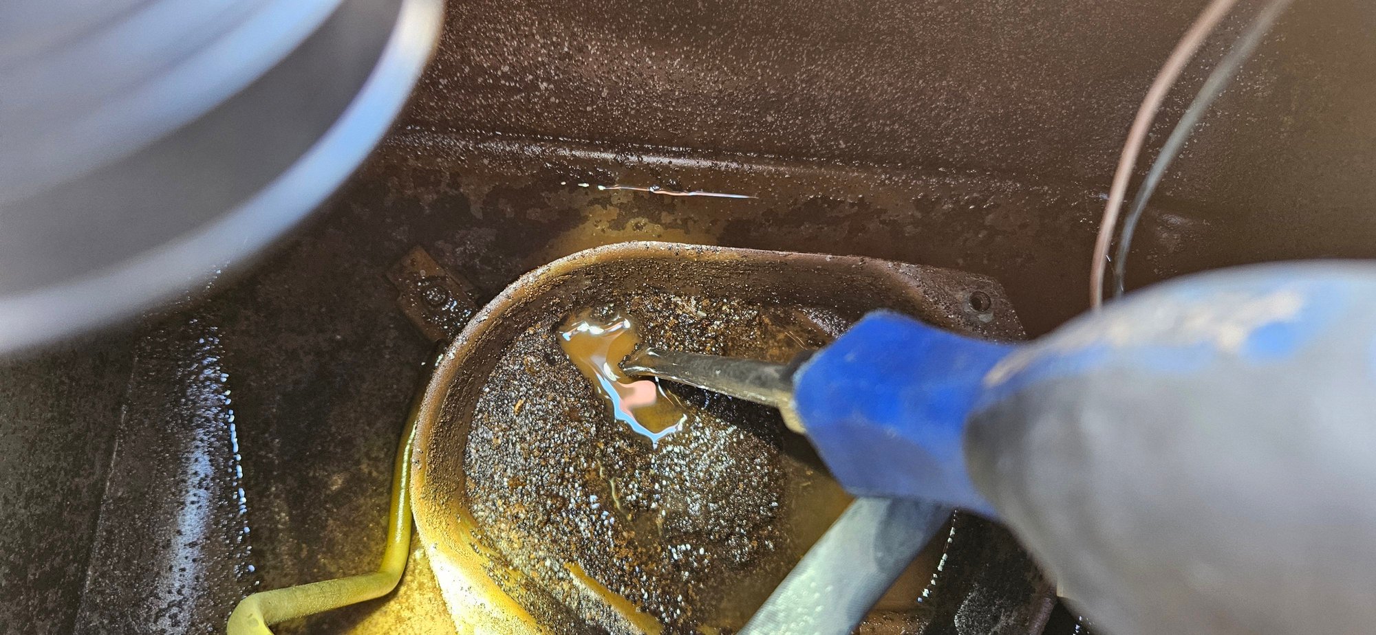

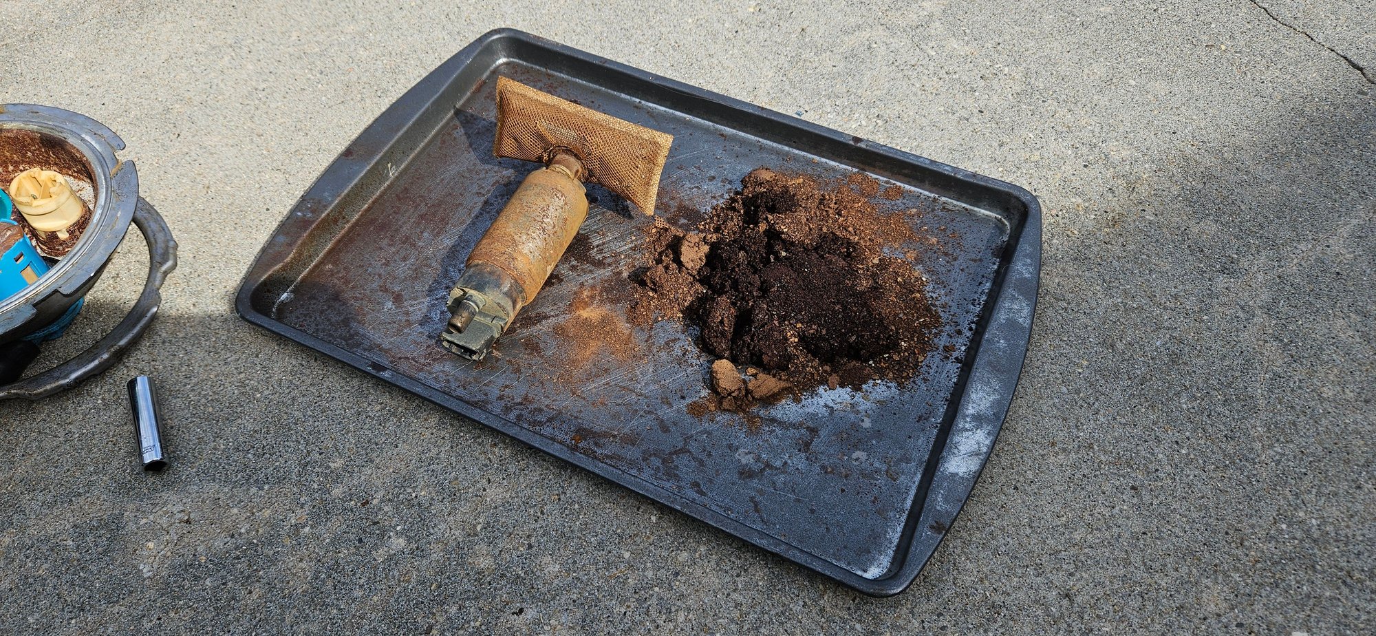

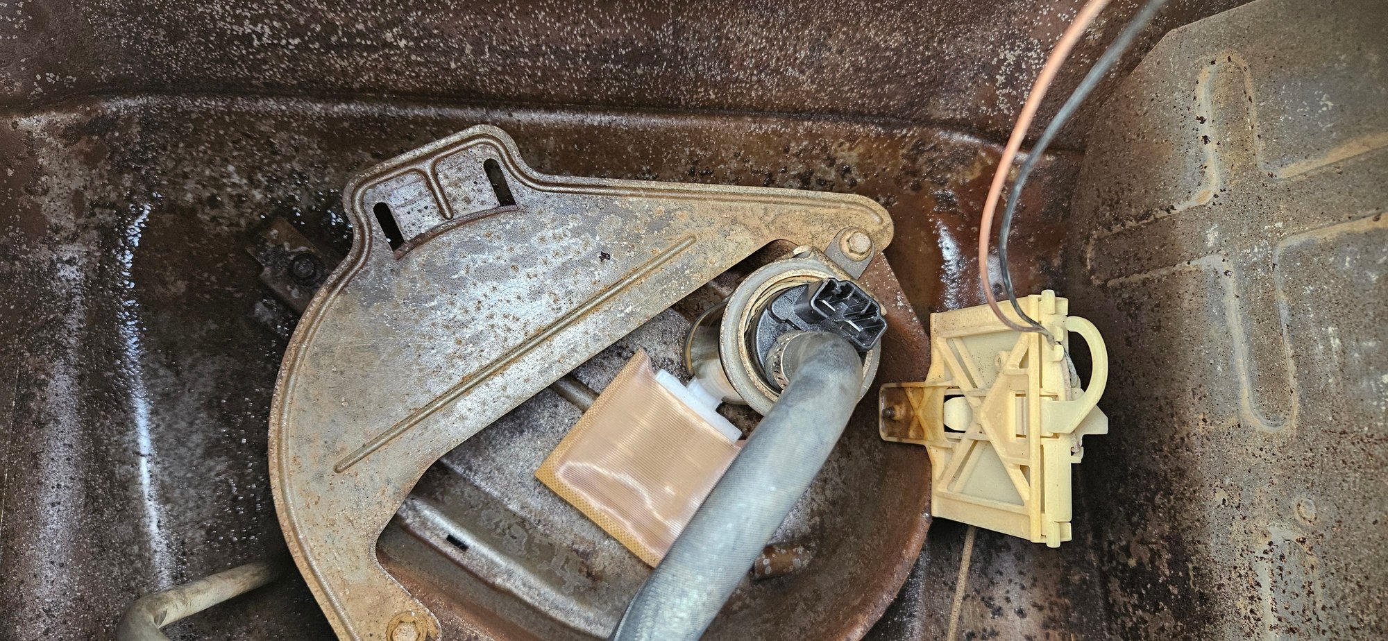

Warm, dry weather. Feeling better. Time to do the fuel pump.
Tank out; removed the exhaust pipe on the driver's side which gave a bunch more access without having to resort to dropping the differential cradle.
​​​​​Uhm. That doesn't look very good.
Pulled the pump and retainer plate out. Poke poke.
That's pretty grody. Scrubbed it down inside with a wire brush, flushed it out.
New pump. That'll do.
​​​​​​Test run successful. Filled the tank up. This pump is very quiet compared to the old one, which I managed to get running and drained the tank with before pulling it out. It was squealing, loose bearing noise.

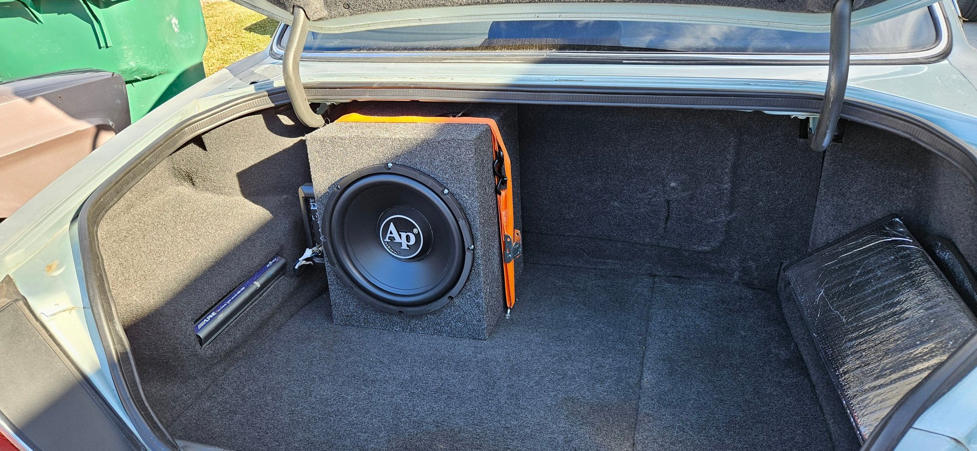

Strapped the sub down (added two nice chrome marine tiedowns to the trunk floor base) so it can't go anywhere. Works well enough now.
Phil

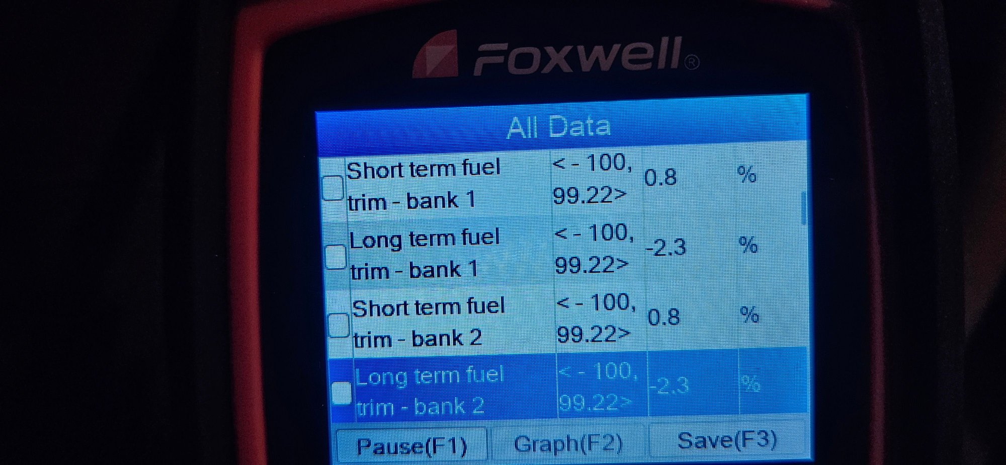

New fuel pump fixed the problem trims.
I'm good with that.
Phil

It's absolutely true...new fuel pumps can really make a major difference. Of all the
issues with these ladies...the fuel pump is one of the weakest areas and the one of
the most issues I have seen. The O2 sensor is probably number 2.

Philip, I hate to be the bearer of bad news but, you’ll be going in there again at some point. How soon is anyone’s guess. The previous pump likely died because it was starving for fuel. That pickup screen was clogged pretty bad. Your best bet would be to source another tank.
Old Feb 5, 2025 | 06:06 AM
  #5219
Philip_A's Avatar
Joined: Apr 2024
Posts: 272
Likes: 130
From: Larose, LA
The previous pump died because it drew a bunch of solids in and seized the pump up. And yes, it may burn this pump up but I know how to get the tank out, clean it and reassemble in an afternoon now. I've run worse tanks with draw-through pumps so I'll just keep an eye on it and see what the filter looks like- that's going to be a ~1000 mile item until it comes through clean.

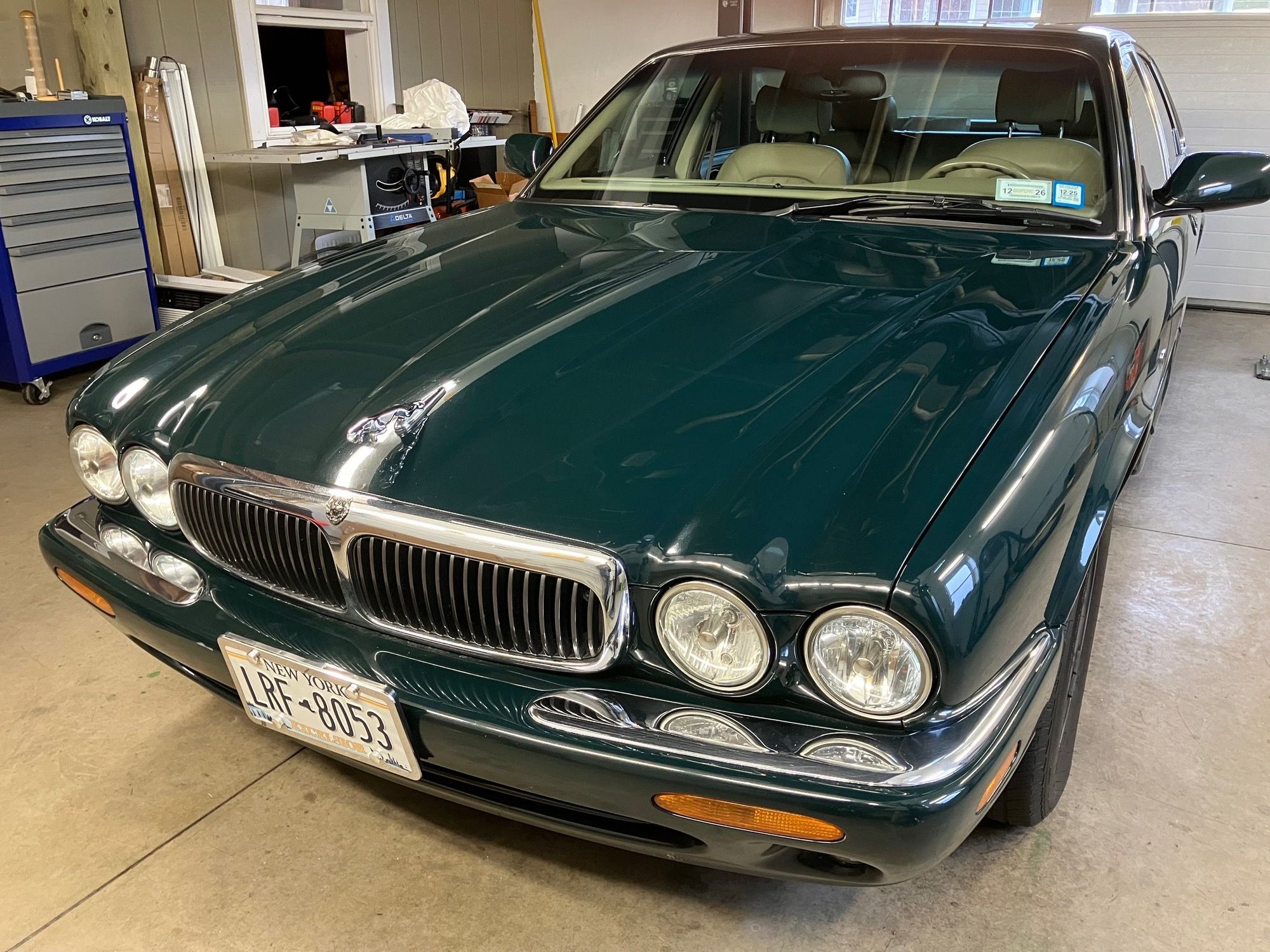

Let's see, where to start? It wasn't all done today, so here goes. Bought the 2003 XJ8 base model (74K miles, PA car, never seen winter) in British Racing Green a couple of months ago. Since then I have (i) changed the transmission fluid and filter, and installed the upgraded main pressure valve, (ii) changed the air filter, (iii) replaced the headliner, (iv) fixed the rear driver's door actuator, (v) replaced the front driver's door interior door handle and cable, (vi) repaired a door speaker cone, (vii) replaced the missing door clips on the interior door panels, (viii) re-dyed the front seats, (ix)chased down a short circuit that kept blowing a fuse that locked the car in Park, (x) new AGM battery, (xi) flushed the brake fluid, (xii) same for power steering fluid, (xiii) replaced the cracked glass on the driver's front headlight, and (xiv) repaired two thumbnail-sized dents around the passenger-side headlights and repainted the fender.
