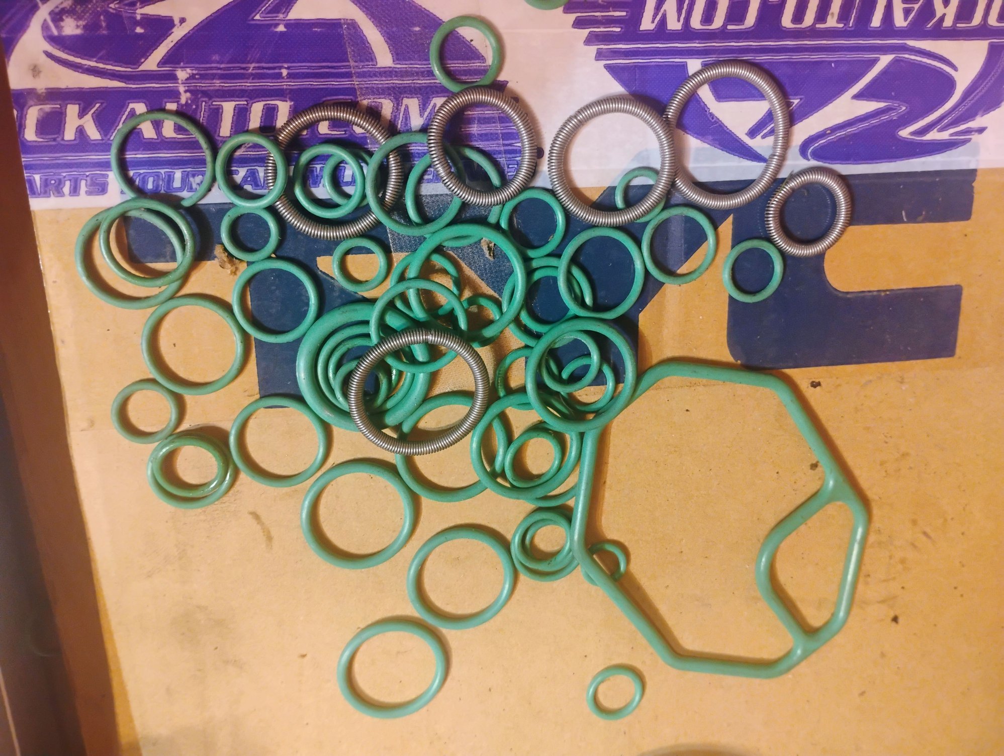

I got this AC o ring kit, rings are not fat enough and don't make a firm seal. Anyone aware of a proper kit. green or black?
Thx, jeff xj8
Thx, jeff xj8
I hit up my local NAPA and matched a bunch of new green ones to the old- took to them with the vernier calipers at the store and found a set that were correct.

Yeah, and Advance Auto in my area, has a nice selection to choose from,
in case you don't have aa NAPA close by.

@jeff xj8 , I opted for one of those 270 piece O-ring kits to ensure I had correct size and diameters - just matched one by one. Make sure they are HNBR for use in AC systems, I think most green are but best to double check.
Could be the old ones have swollen as well, but also preferred using fatter ones in the kit that matched what came off the line.

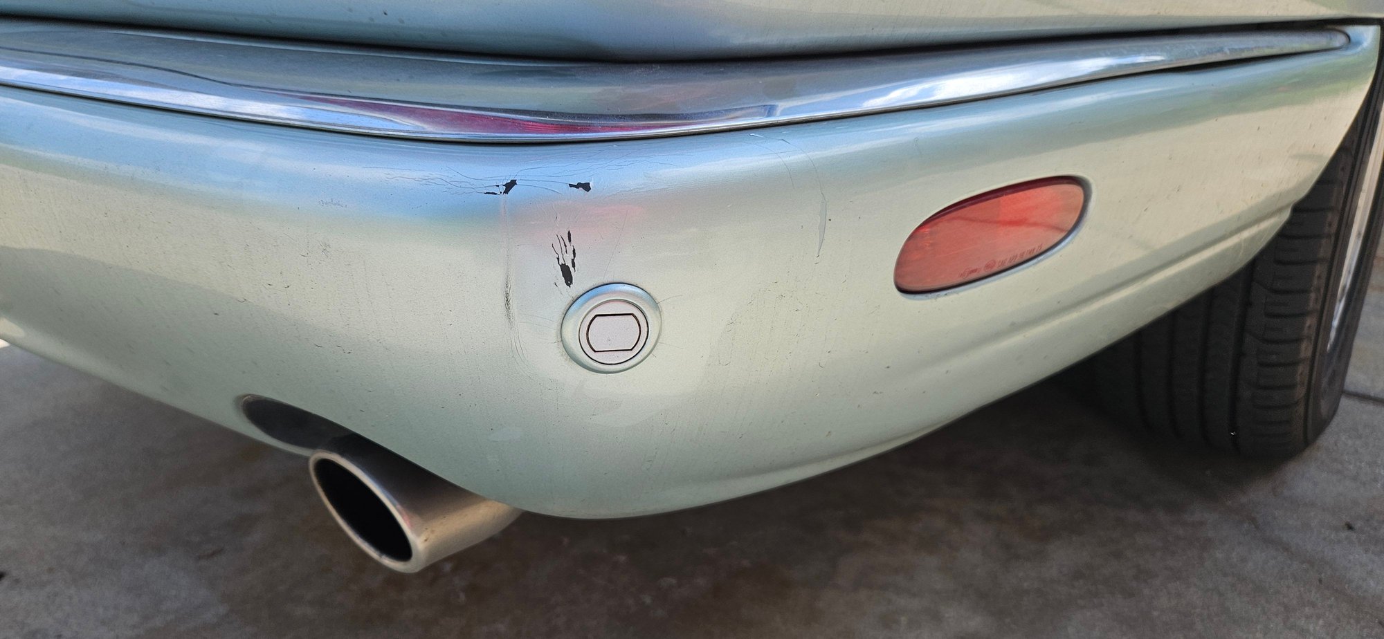

A package from our very own @jeff xj8 arrived in today- one part I was able to easily change was the ultrasonic sensor that the previous owner of my car backed into something solid. That meant a cacophony of beeping whenever that car was in reverse, which had no relevance to what was behind the car.
Installed and tested. Works nicely, and it's silver which is close enough I don't know if I'll even bother painting it.
Thanks, Jeff! Another update to come when it happens.

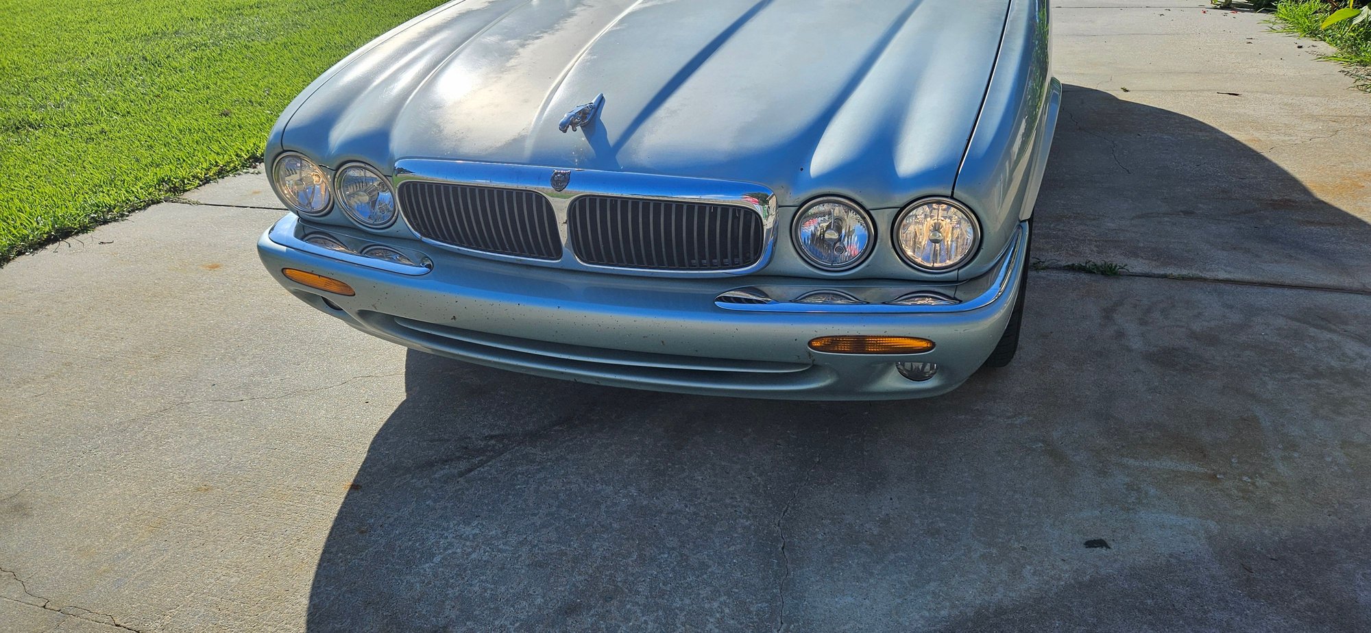

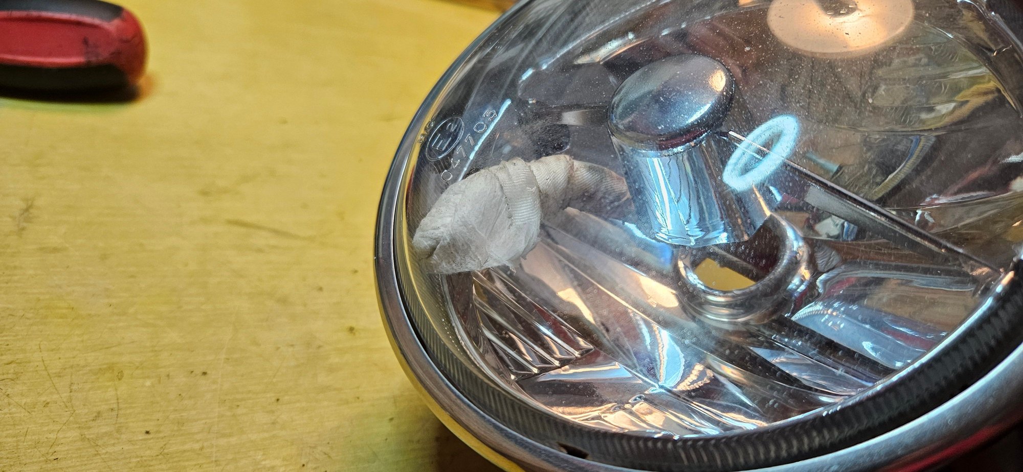

Replaced the driver's side low beam light. Looks much better now the reflector isn't all cateract.
Some of the silver Jag lives on to be enjoyed another day.

Glass cleaner on a rag on a stick.
Less glare from the glass now, which is good. Means more light ends up on the road and less in other driver's eyeballs.
Better for everybody.

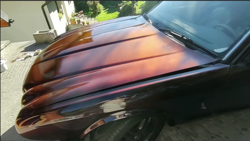

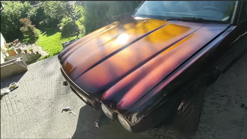

Almost finished paint job in zbr hypershift, definitely overdosed the pigment and paint is more red than intended but effect is still fantastic with color shift from nearly black violet through wine red to orange
Also did some chrome elements like window surrounds grill etc in black so all plays nice

Very nice. Looks good as is. Deep burgundy is a pretty color. Brings out the lines of the bodywork very well.
Come paint mine next please?

WOW . . . Fantastic colour choice. My purdy cat is Sea Frost blue . . but a wine red/burgundy would definitely be my second preference. Nice too to "see" a picture of the front bumper (fender) mounting struts as I'm currently wrestling a stubborn mounting bolt out where the threaded inset at top of mount has given up and started to turn . . . so man - v- jag situation going on at the mo.

Maybe if you remove bumper together with the mounts you will gain enough access to the top nut, on xj40 i would block the nut by wedging screwdriver between nut and beam body but there beam was fully metal and here it is all plastic so i doubt it will work
With paint job i was aiming at black turning into red with tiny orange hue at maximum sun but miscalculated pigment and all color spectrum shifted to burgundy, looks great so i don't mind, but i didn't really have a chance to enjoy the new paint yet, all left side needs buffing and it was rainy for last few days so maybe tomorrow
