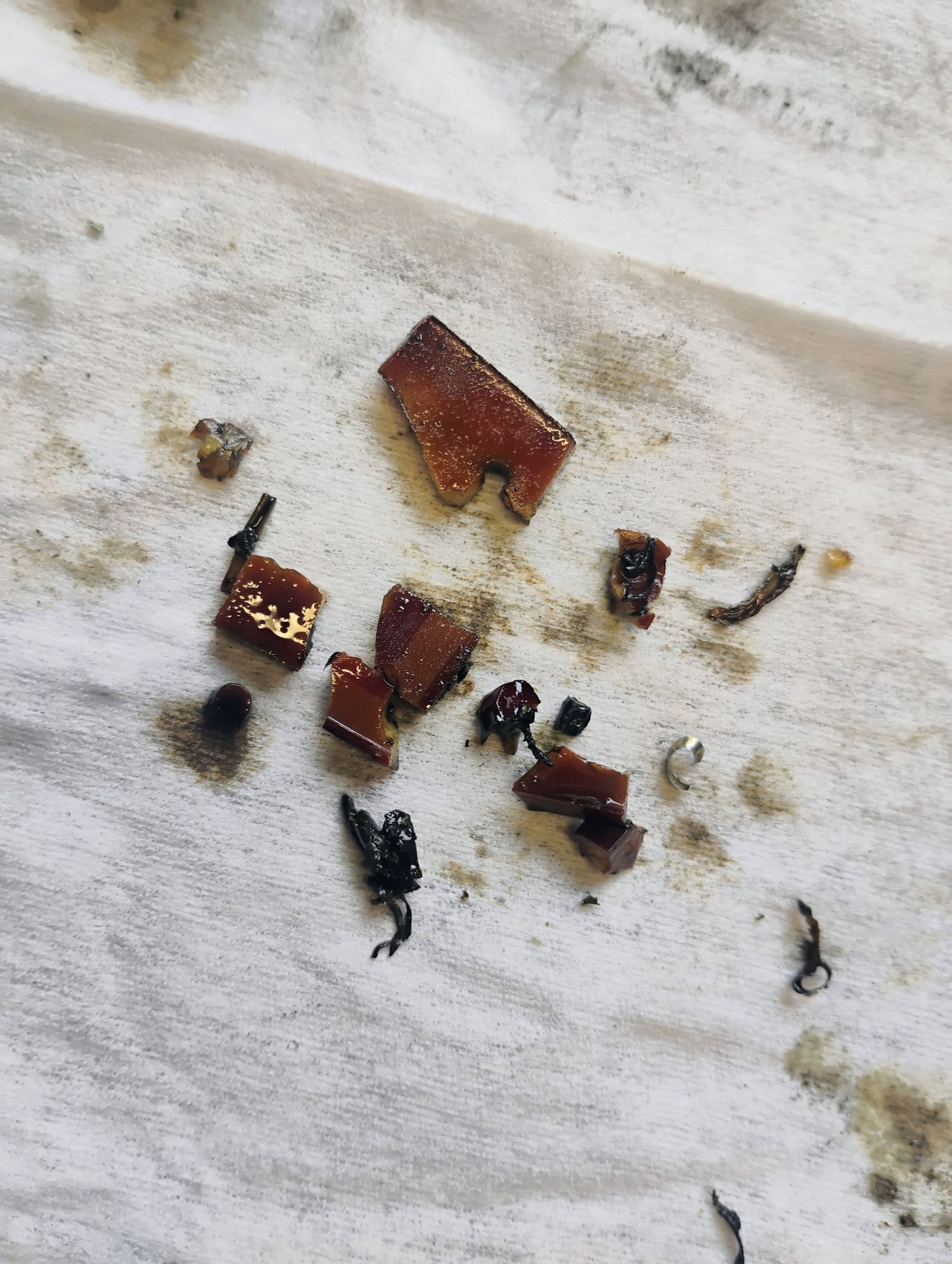

I got these bits, mostly busted up tensioner pieces from the sump of the motor from the 2001 "donor".
All, except the big piece were in the oil pick up.
Thx for the encouragement, Jeff xj8

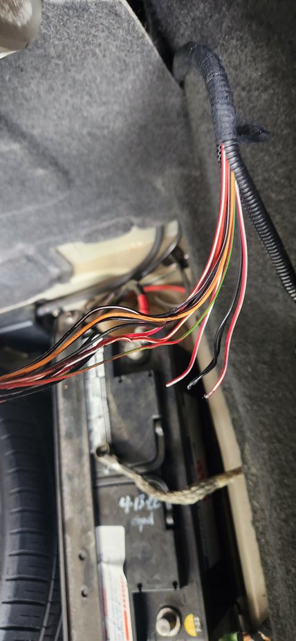

Default Found and fixed trunk wiring issue
Ever since I bought the car a few weeks ago, none of the license plate lights or interior trunk lights were working. Got an autel version of the power probe which helped give me a direction. The voltage changing with the trunk going up and down was the giveaway. Thankfully it was only 4 wires easy to access and solder. I'm a little worried it will happen again over time with the wiring showing its age. If it does, I'll have to replace all the wiring in that section.

Yep.....that particular wiring loom has been the cause of many a Jaguar owners
source of various issues. The designers did not seem to be too worried about
longevity in their design. On the Duchess, I have a low-tension spring which
keeps it out of harm's way.

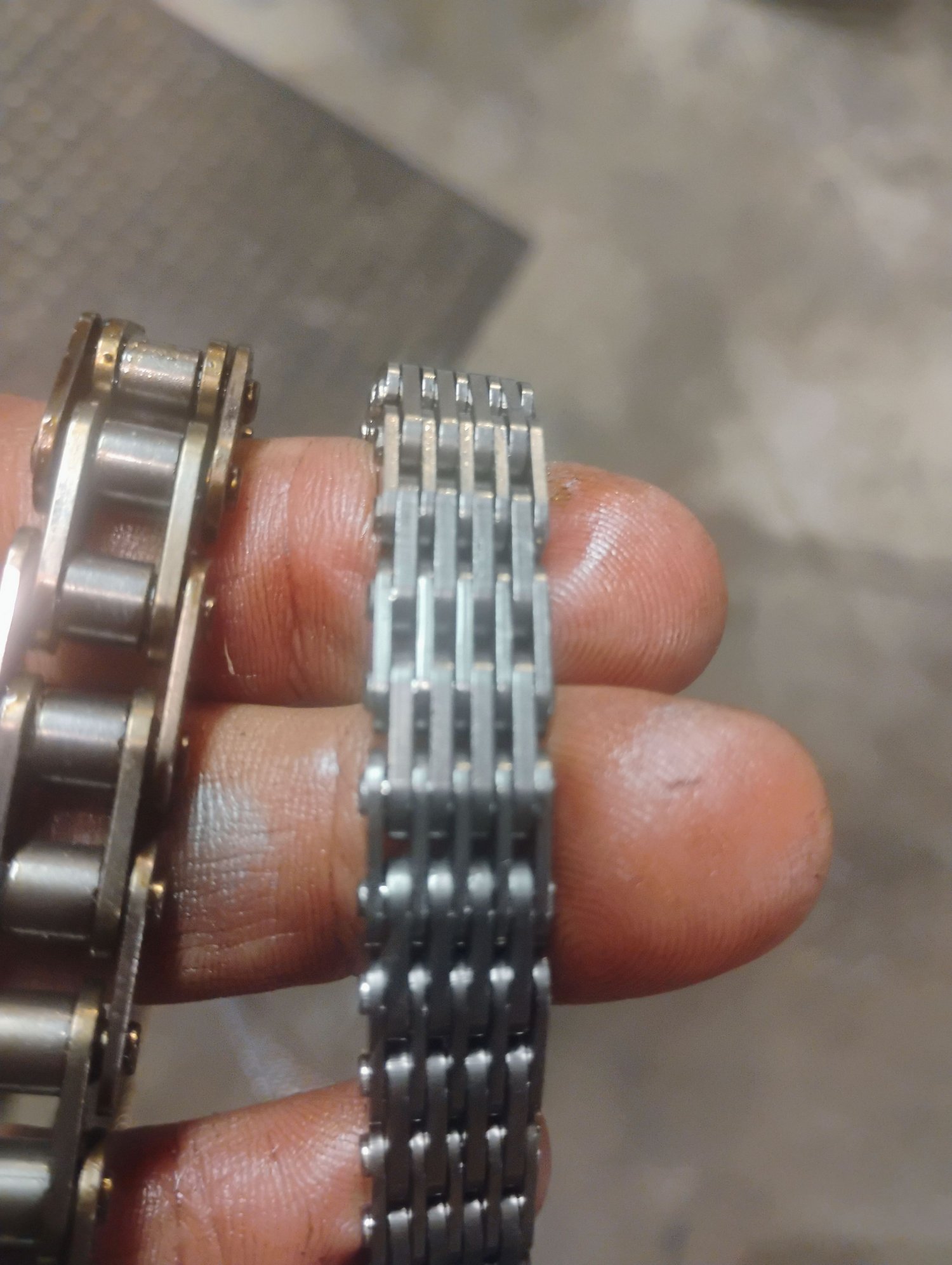

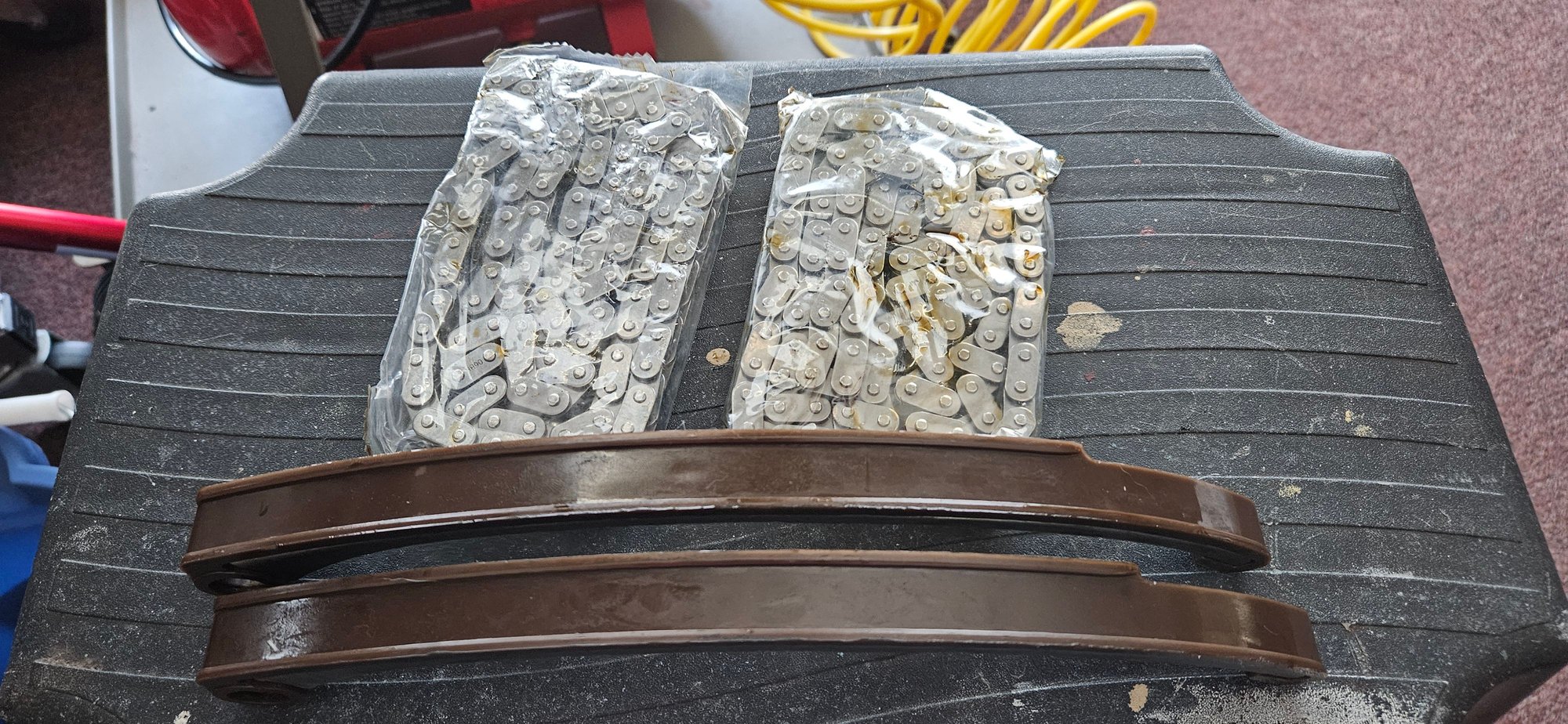

Default timing chains
The replacement kit came with two different types of chains. The secondaries , short chains, left in photo, were good. The primaries, right in photo, would not fit on gears. Are there jags that use two different types on the same motor, or jags that use the type on the right? Can anyone think of an explanation other than I ordered or Euro Cars sent, the wrong primary chains? (I reinstalled the old primaries BTW) Jeffxj8

If my memory serves me right; from 2003 and the 4.2L engines, the primary chains are of the new, tougher type and the secondarys still of the "old" type.
The main concern if that its the case, is still the secondary chains (between the cams on each cylinderbank) if they are of the old plastic/old improved plastic type tensioners.
/E
Two types of chain. The later type of the multi link. The tensioners for the single link don't fit the multi link and vice versa. Single link is fine but gets noisy as it ages and stretches (100k+).
You have the later "updated" chains in that kit. You need the earlier chain set, or get the updated gearset to fit the multilink. The updated set uses the single link chains between the camshafts.
There's some non mix-n-match items you've put together there.
TL;DR:- you got the wrong chain and tensioner kit.
Edit: I went look in the box I kept behind from doing mine.
I've got a new single link chain and sliders if you want them, my kit had both types in (mine uses multi link). Might fit in a $11 flat rate box, I think. If not it'll go in a medium which I think is $16
Phil
