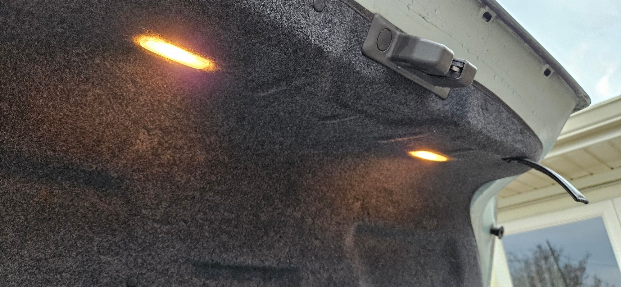

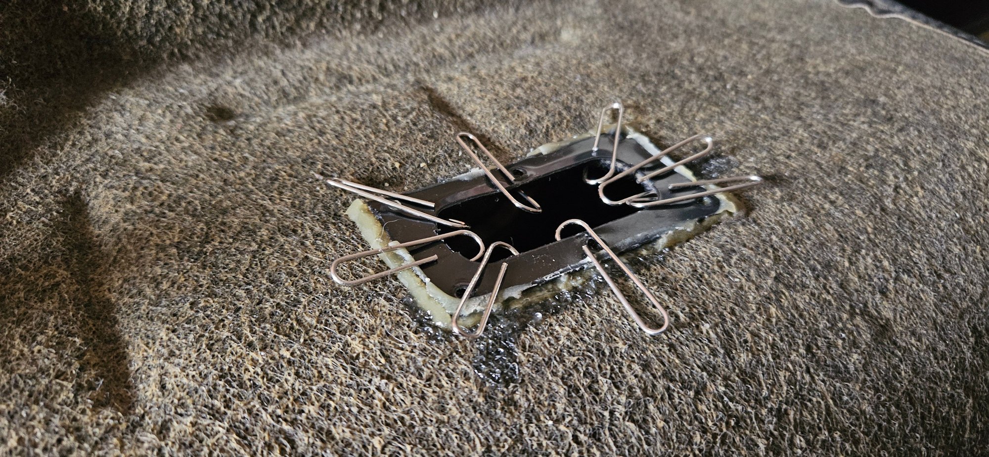

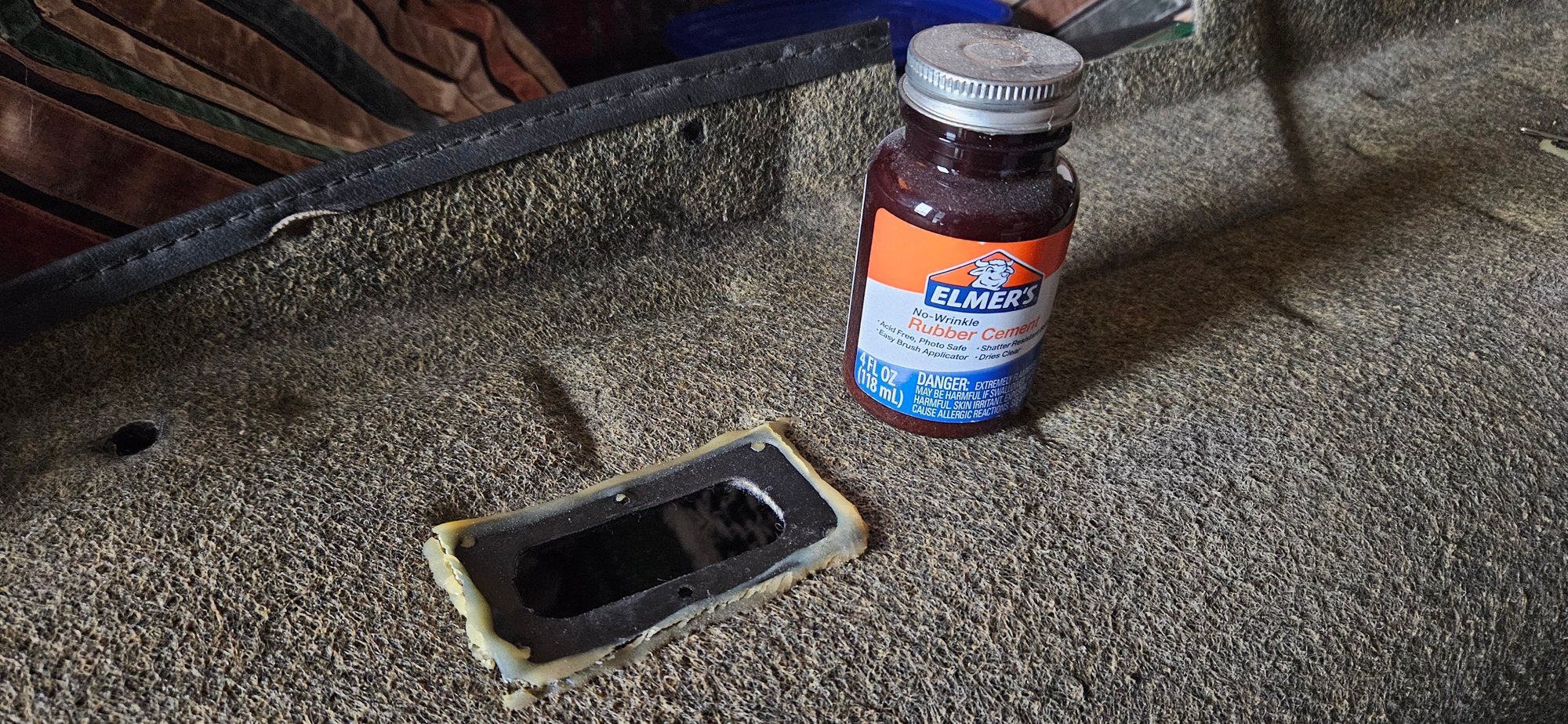

Took the deck lid inside cover off. One of the lights has fallen out.
Glued the lamp holders back in. That's now setting, going to be the next few hours before the paperclips can come off.
Might find some LEDs for these, something brighter but less hot running.
Phil

Lights now work again.

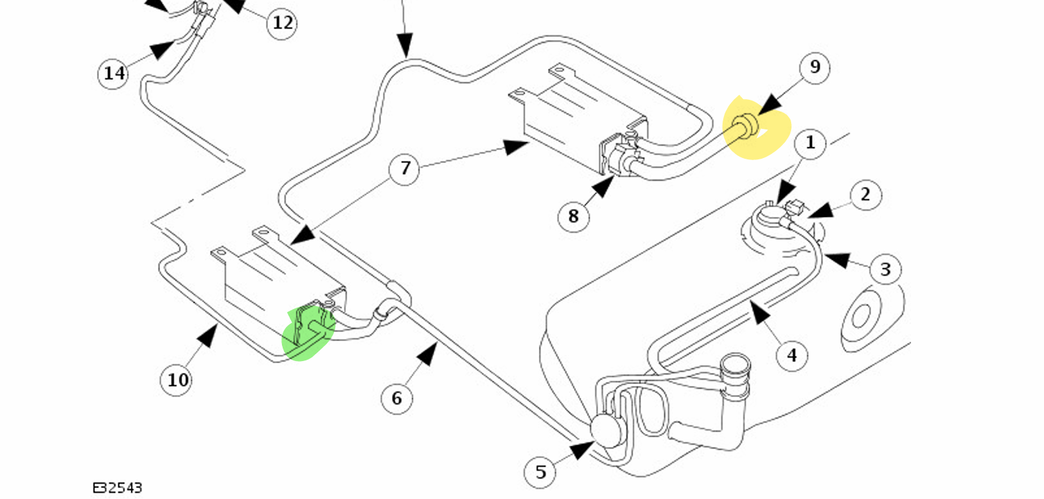

Its difficult to get gas into my 2002 xj8. Gasoline erupts from the filler or the pump clicks off, even at very slow flow. I can fill about a quarter tank at a time.
Research suggests obstruction at the vent at the very end of the system. (mine is rusty and the vent holes appear open) or the ccv valve stuck closed. Both situations will obstruct tank air / vapors exiting the tank.
Evidently this is pretty common as there's A service bulletin about it.
As a diagnostic, I disconnected the down pipe from the tank at the first charcoal canister to allow the tank to vent. I gonna to add gas tomorrow and see how it goes.
Has anyone had this problem? Is my approach sound?
THX jeff xj8

With the down pipe from the tank to first charcoal cannister disconnected gasoline flowed right in.
Which to me suggests a downstream obstruction preventing tank air / vapors from escaping during filling, exacerbated by foamy winter blend gasoline.
I;m going to reattach the down pipe and disconnect at the canisters then at the vent valve , then the end vented cap, in series, then fill up, to track down the obstruction. ?
Maybe push compressed air through. (just occurred to me). 1999 Vanden BTW
THX jeffxj8
I had the other problem, the tank couldn't breathe in. If you follow that hose to the highest point inside the rear wheel there's a black plastic valve that looks a bit like a UFO. In theory it controls the breather somehow but despite seeming ok mine was jamming in one direction. If you carefully unclip the lid you can take the gubbins out of it (it's a diaphragm & spring) then it breathes straight through the valve & the system looks complete for any inspections.

Hoolie, Is the "UFO" looking part you refer to the part I have marked in yellow?
I disconnected the line I have marked in green. I've driven 400 miles or so and easily filled the tank several times.
To my surprise, the check engine light has NOT illuminated (with the hose still disconnected) I don't get that.
I suspect obstructed charcoal filters, the valve #8 in the diagram (ccv)?, or the end of the system vent Hoolie i think is referring to. (exacerbated by foamy winter blend gasoline, as I had no problems in the summer months)
Any additional thoughts? THX. 2002 xj8
