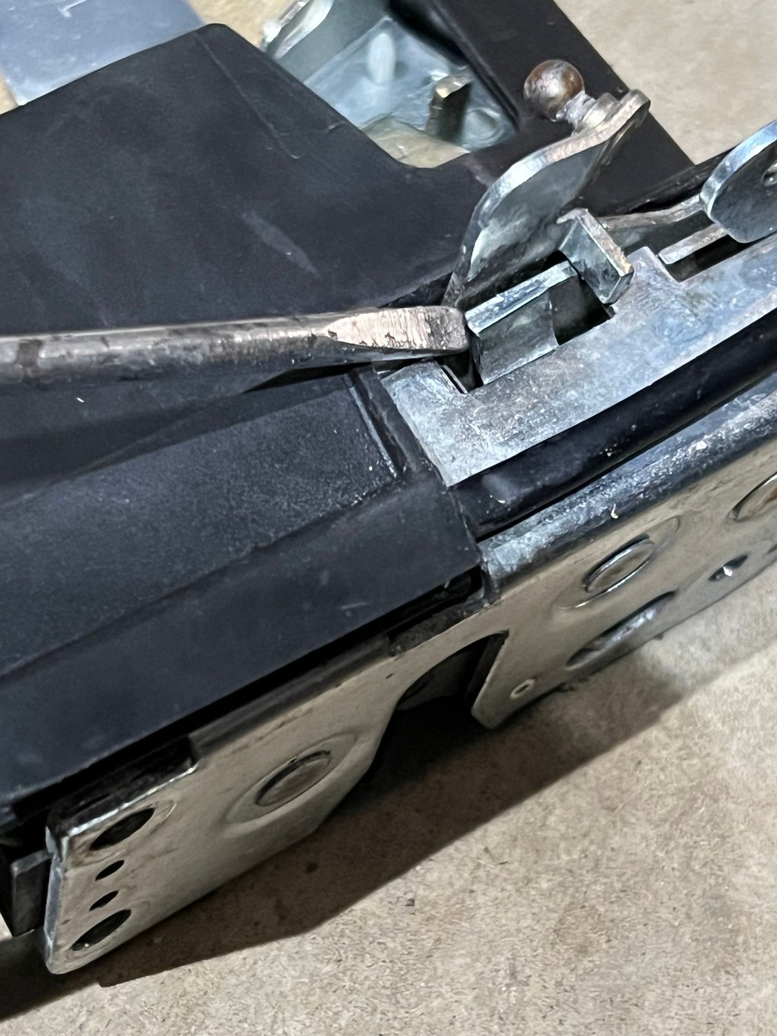

Default Replaced driver door latch actuator
Electric door look worked intermittently. From outside would have to open with key. From inside when acting up couldn’t lift stem and handle does nothing. Had to roll down window and use key. This part had lost it spring.
