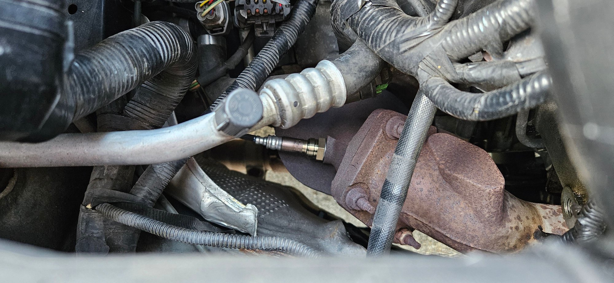

Replaced the A bank upper oxygen sensor. Took a large breaker bar to undo, typically. Check engine light begone, fuel economy improved.

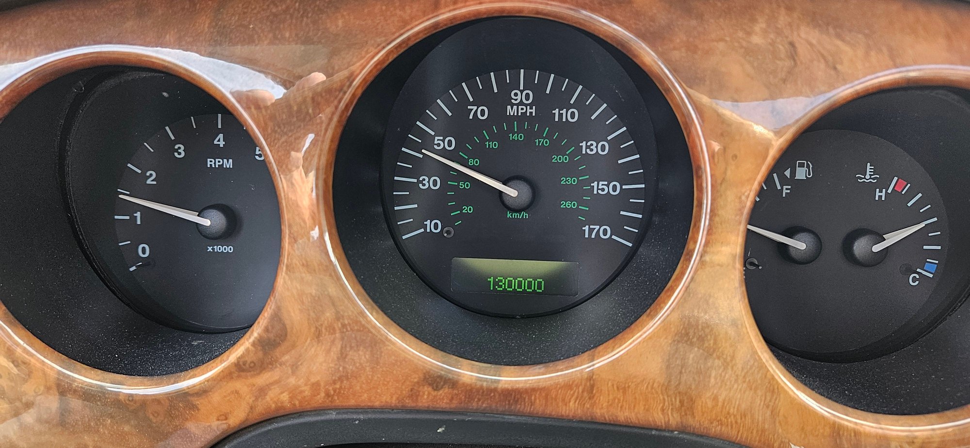

130,000 miles!

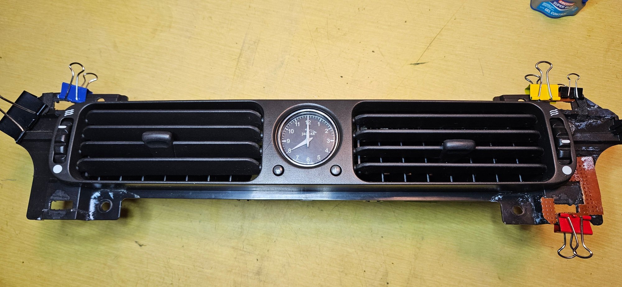

Also, fixed the clock console, the trim clip holes had broken last time I had to take it apart.
Glued the broken boots back on and augmented with some Veroboard.
Good enough.

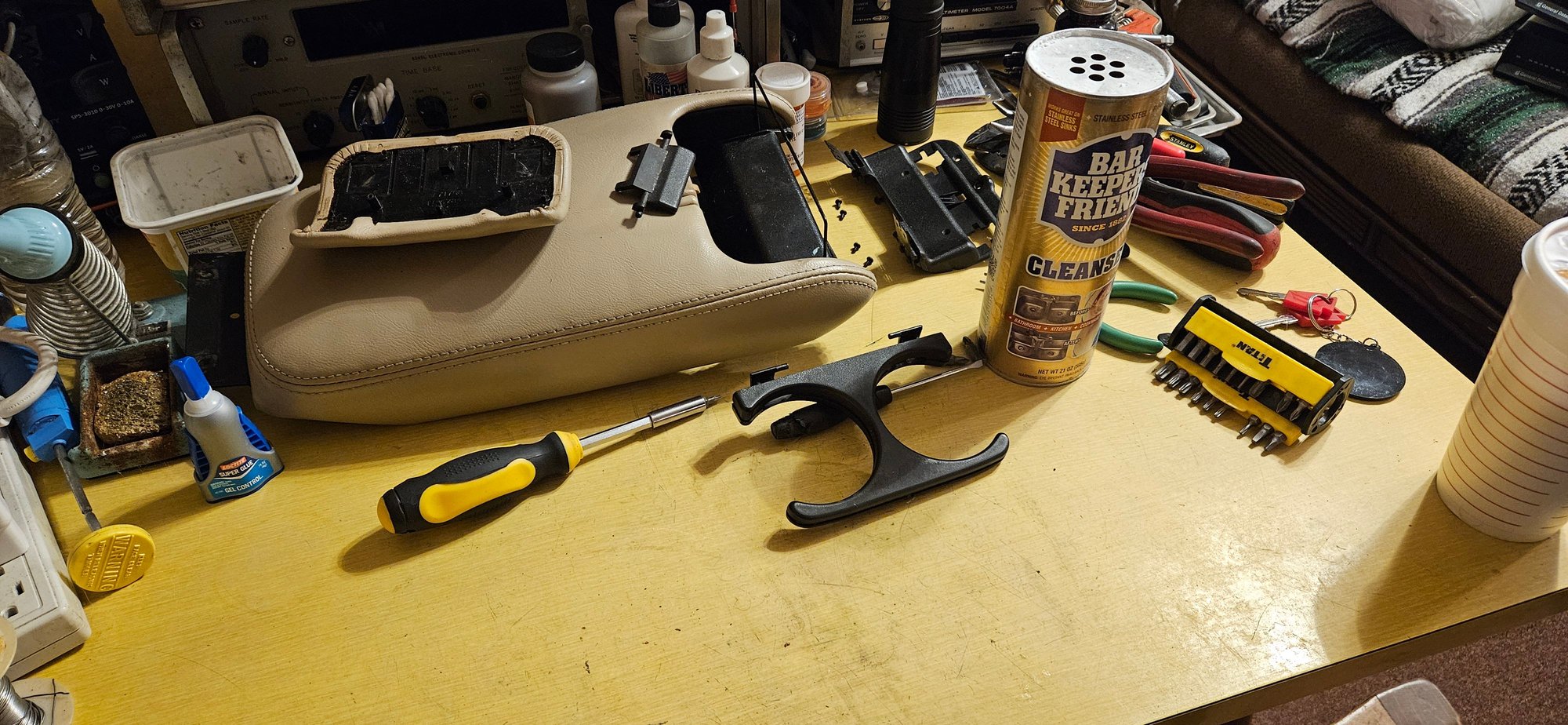

I put a cup in the cup holder yesterday; accelerated and it broke the cup holder through the sheer G forces produced by such a machine.
I glued the broken pieces (stupid design) back together and now it works again.
Also took it completely apart and cleaned it. Yuk. Previous owner liked lattes.

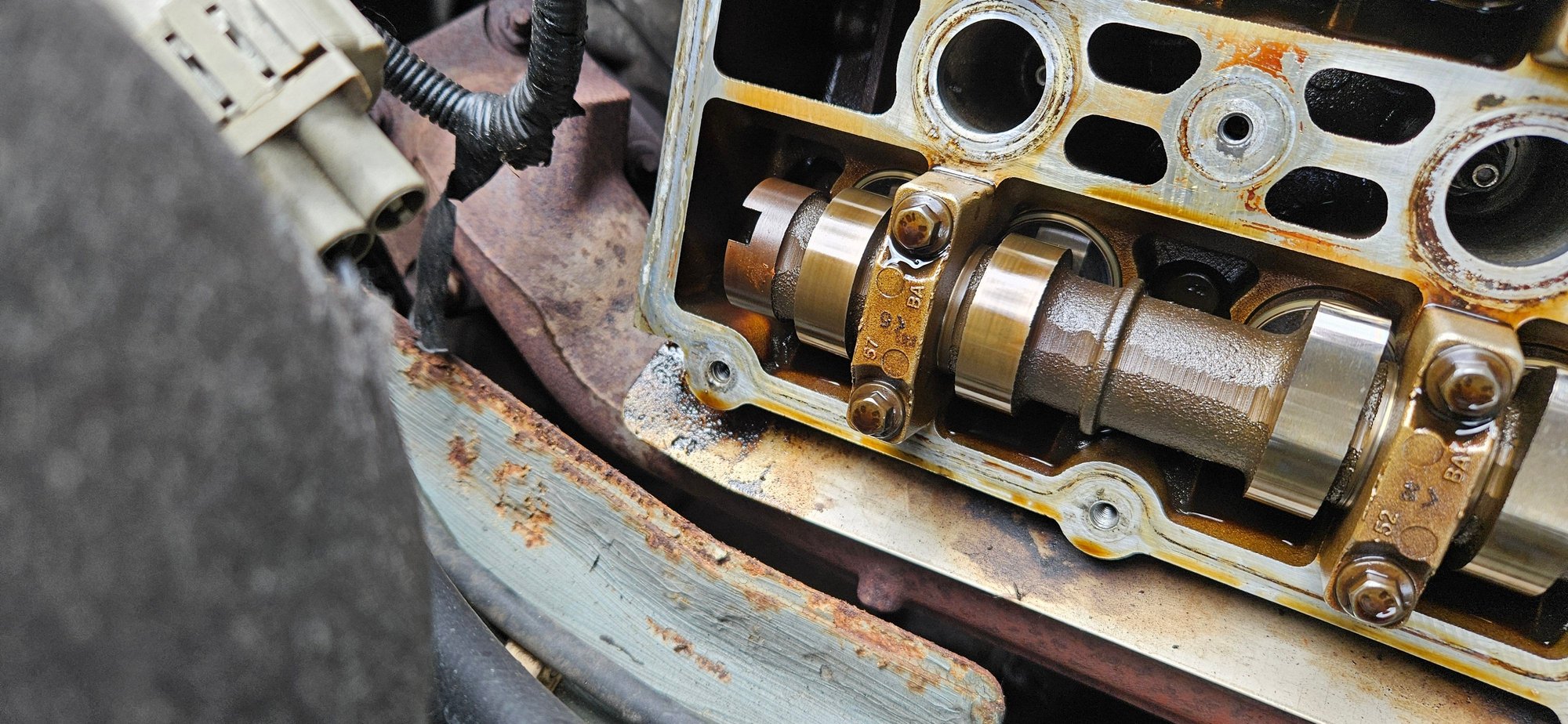

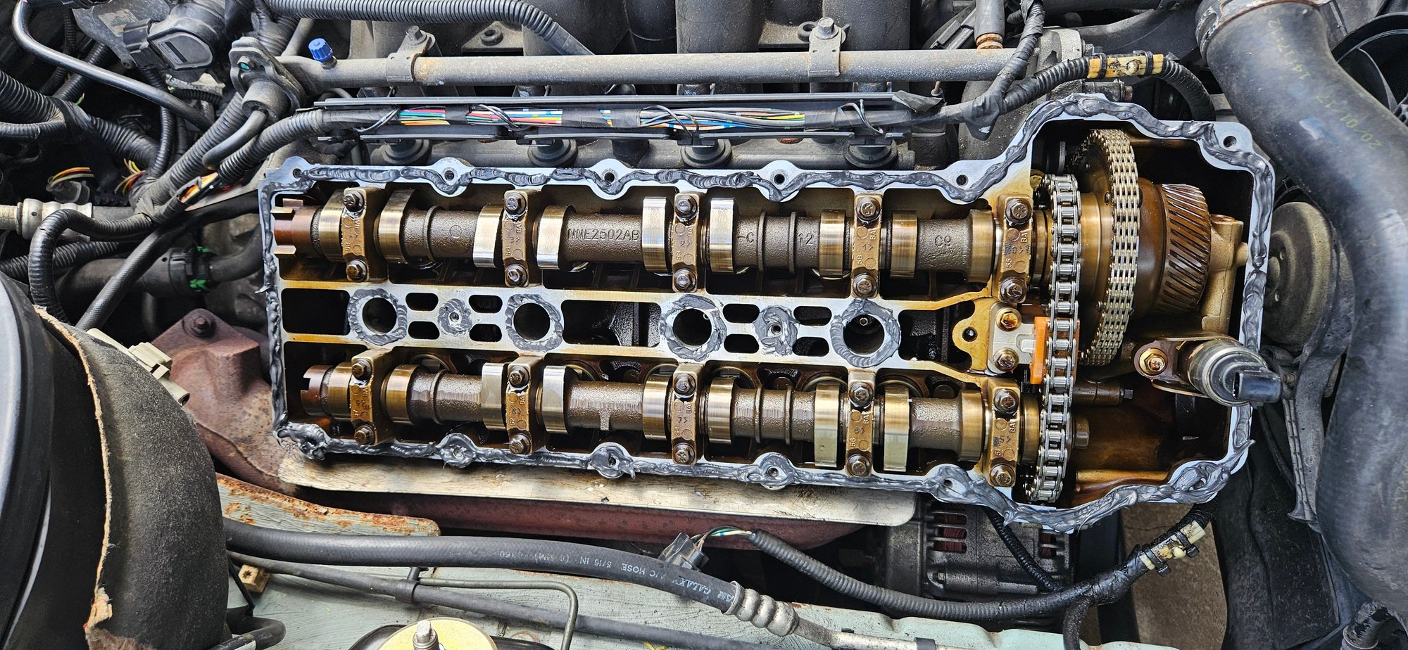

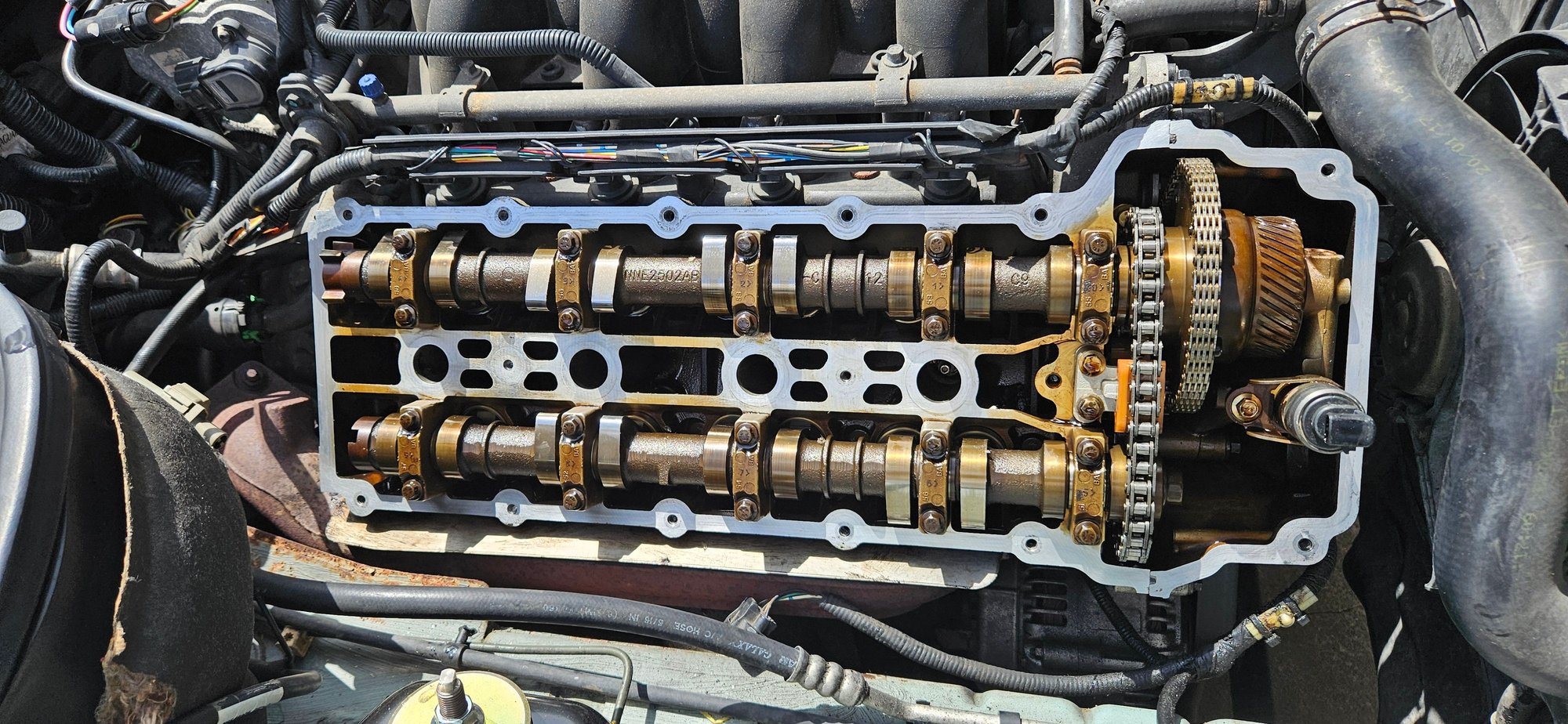

Uuugh, the cam covers are leaking AGAIN.
I can't get them not to leak, this sucks. I guess they have a warp to them. Front lower edge leaks on both. Sealant did nothing.
Sucks because the car stinks of burning oil all the time. Anyone have any hints?
Phil
Old Apr 3, 2026 | 01:48 PM
  #5620
Philip_A's Avatar
Joined: Apr 2024
Posts: 288
Likes: 140
From: Larose, LA
Addressed the valve covers today.
Well, that was leaking. Looks like the corner never sat down right. The old sealant had come up from the surface, which is weird because it is what was specified by Jaguar.
Cleaned all the sealing surfaces up.
A generous helping of Permatex Oil Resistant RTV.
Did that to both sides. That can sit and cure now.
