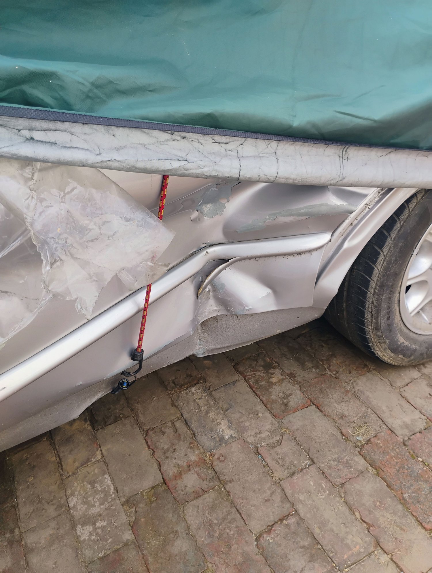

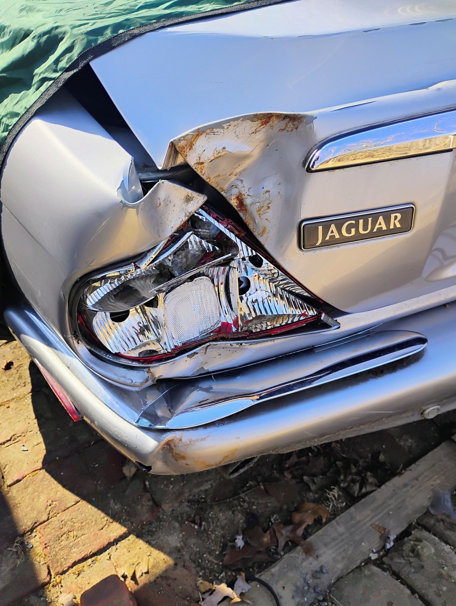

Default crash
drivers side side air bag deployed ( i didnt even know it had one). he spun out , 180 degrees on an exit ramp, wet roads, jumped a curb, struck and broke off a light pole and the pole fell on top of the car striking the top and the hood (directly on the leaper). still runs. im looking for a vanden plas with a bad motor / trans that i can buy and replace with the engine / trans from my wreck. son sustained a concussion, MRI scan shows no damage. They say its wrong to love material things...but... and you guys are right to remind me of the important thing, everyone was able to walk away.

Until you pointed it out, I didn’t even see the light pole on the drivers side. Wow….

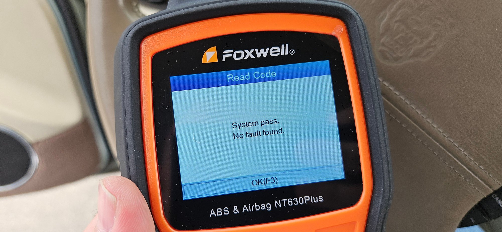

Replaced the SRS module with a junkyard pull.
The always-fun task of removing the radio in this car. Buried down in there, bolted to the transmission tunnel is the SRS module.
New one in place. Connected the battery back up and powered up the diagnostics box:
That'll work.
No SRS light now. Much better

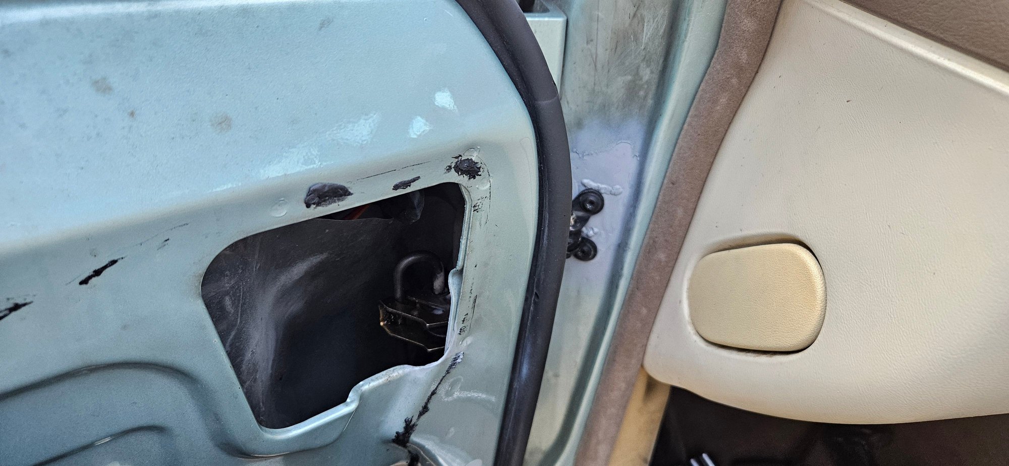

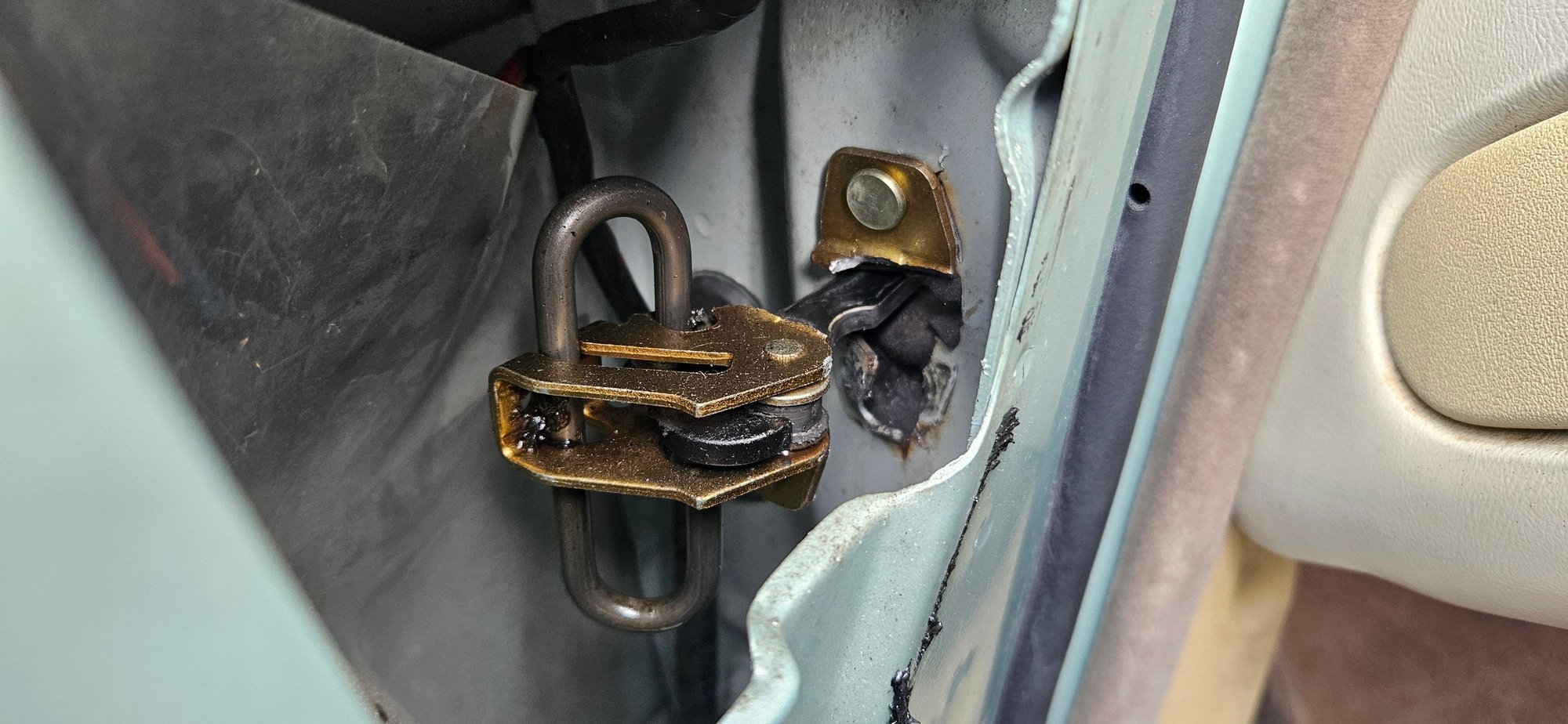

Welp, that ain't right.
Applied the electro-sparkle-stick.
Beat the door back into shape, welded it and the A pillar where it had cracked.
Door now does door things again.
Better.
Old Mar 26, 2025 | 08:20 AM
  #5329
Dude.Day's Avatar
Joined: Jan 2024
Posts: 64
Likes: 16
From: Stoke-on-Trent

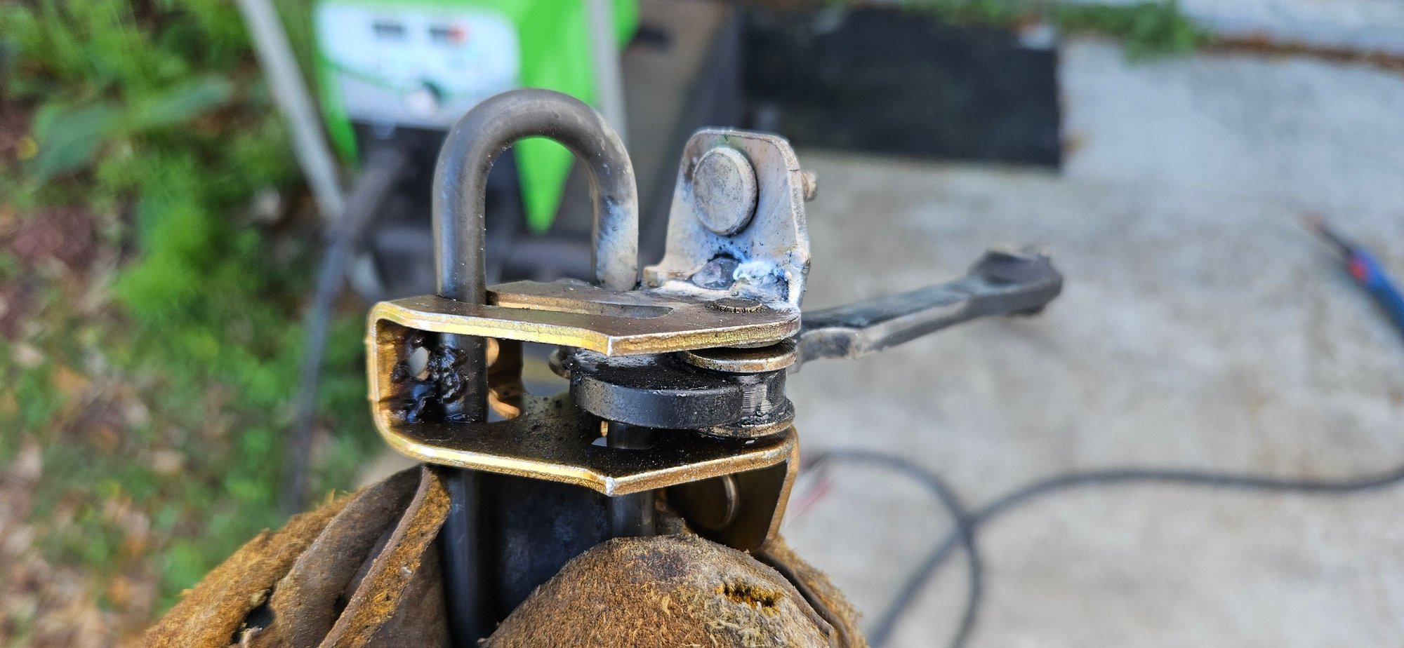

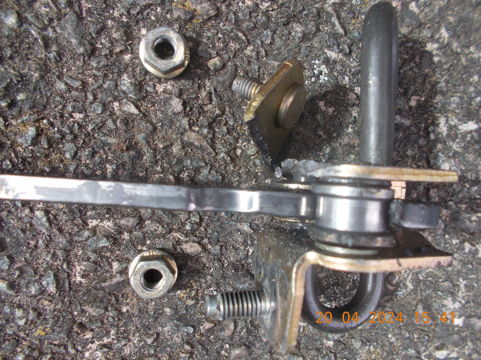

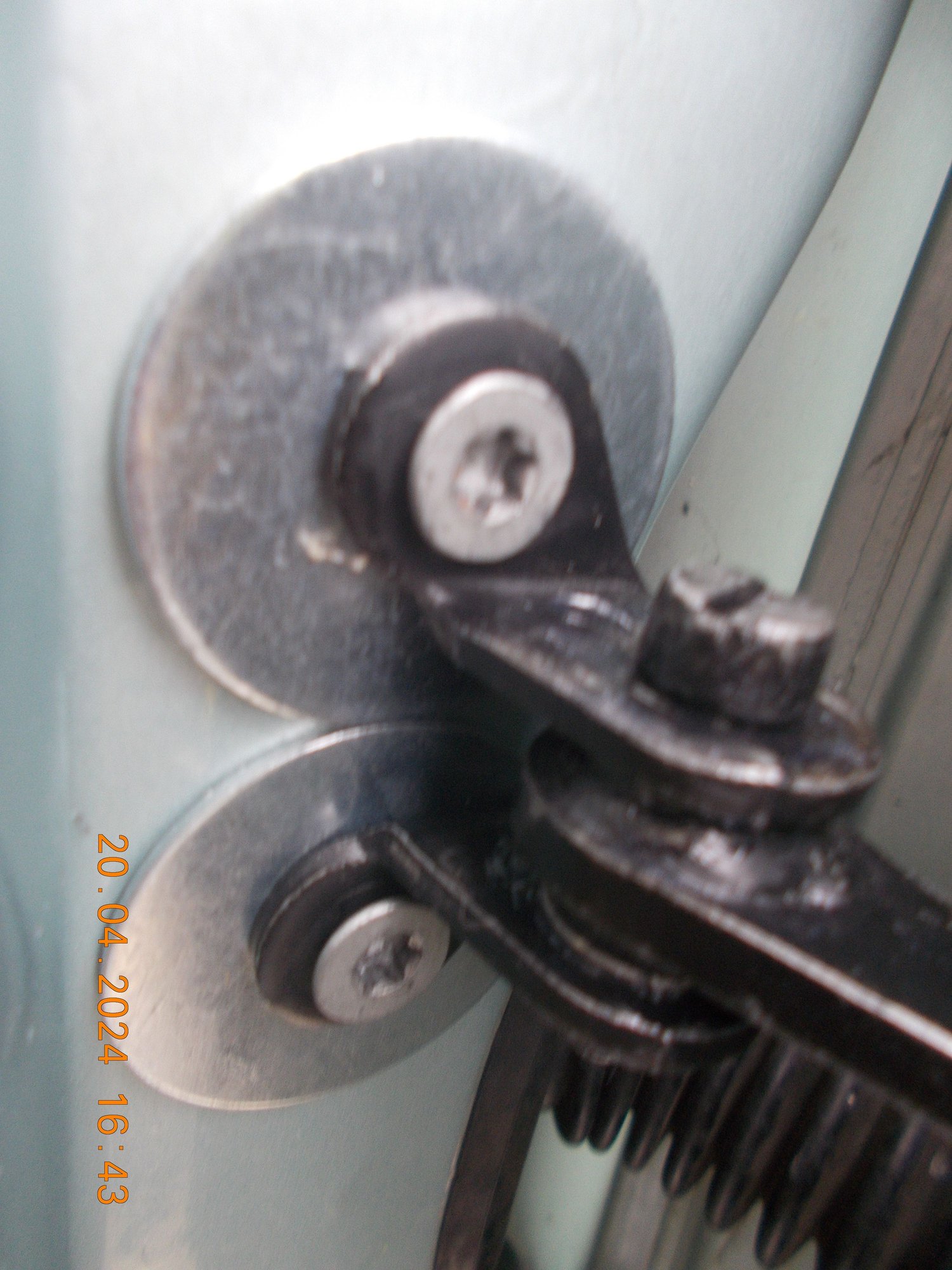

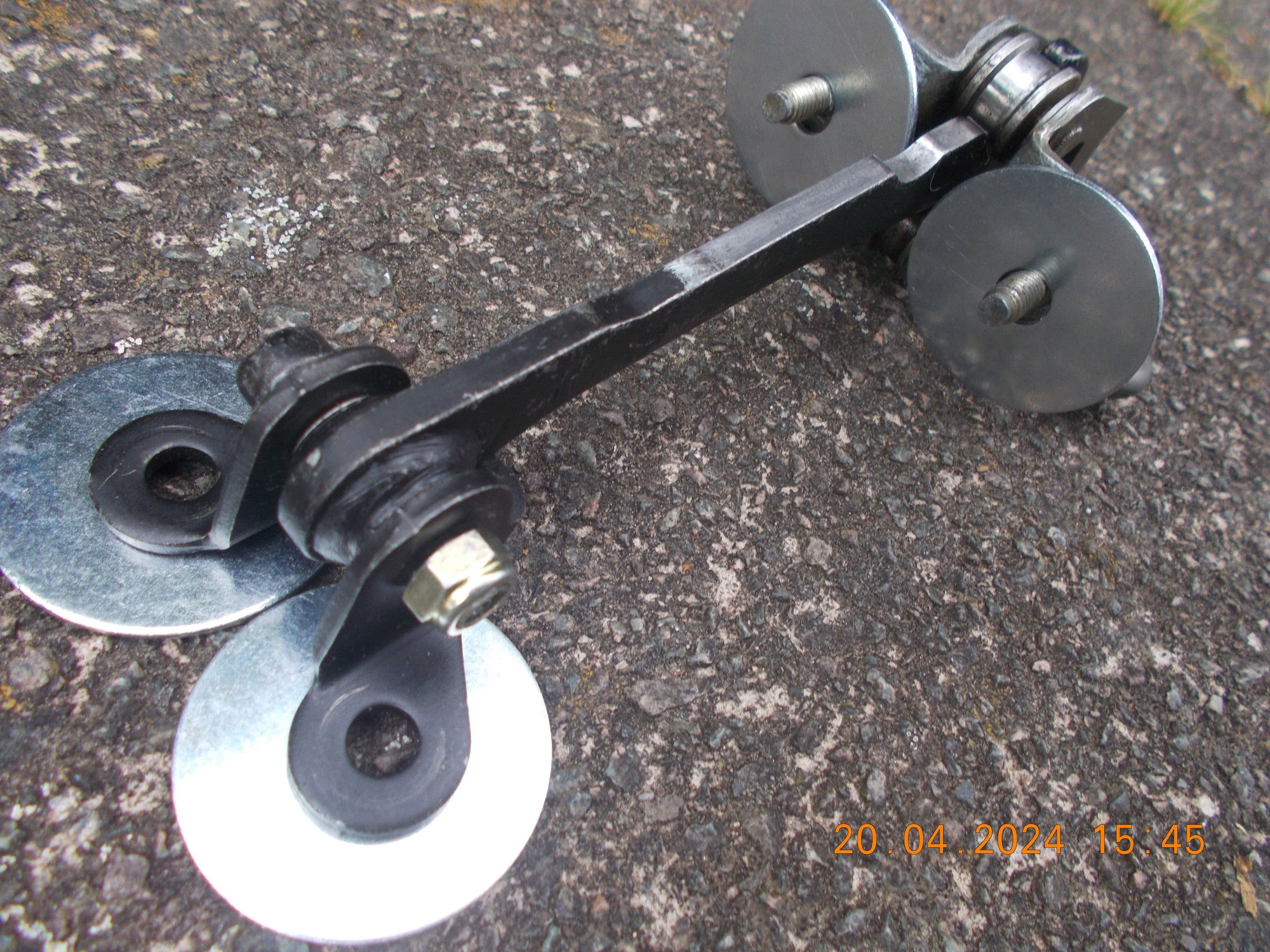

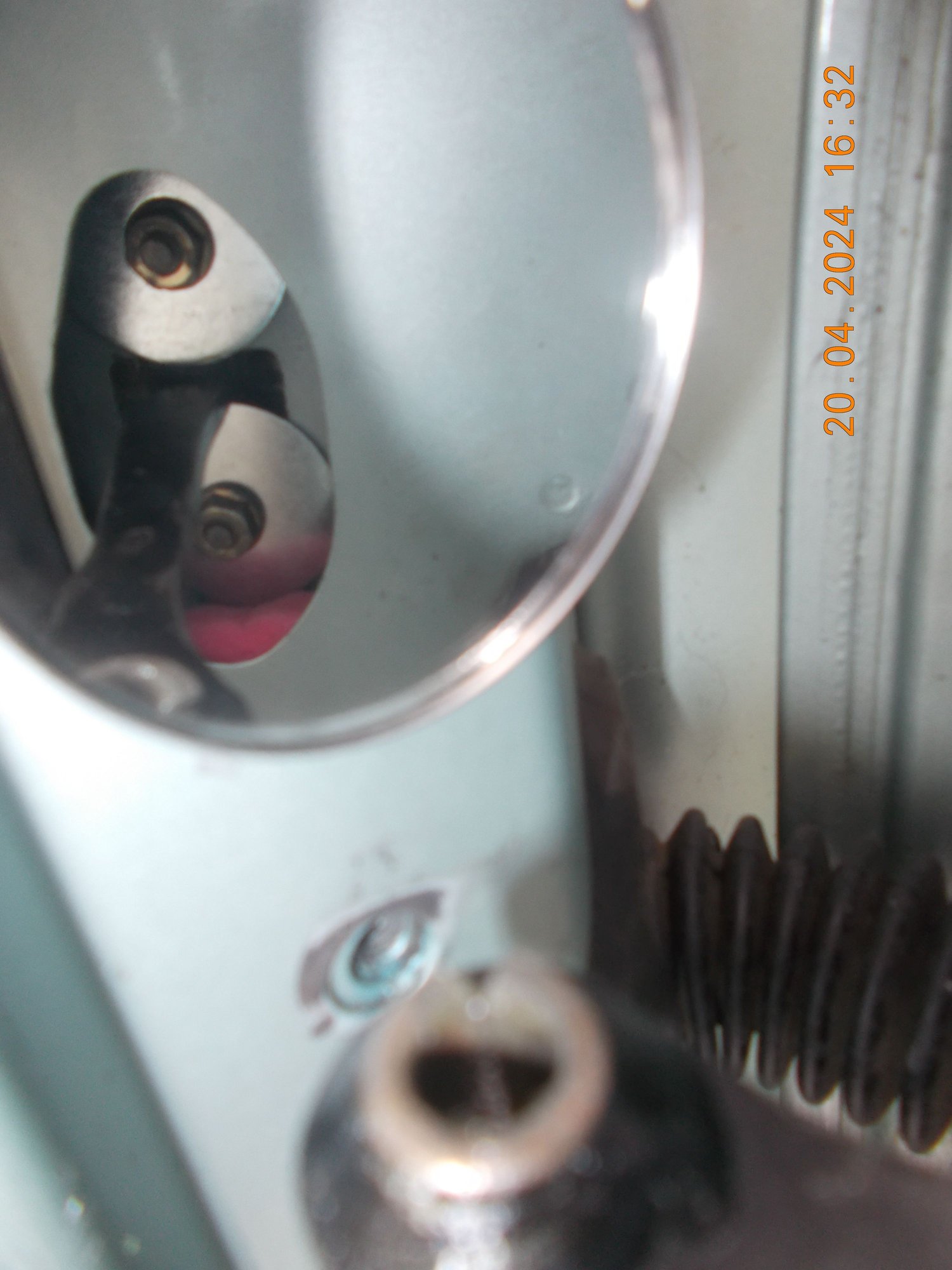

Similar issue, similar outcome . . . different method. I can't do the sparky hot stick thingy. Cheers
Busted stay arm
Busted stay arm
Replacement stay arm with strengthening washers
Looking into the door
A pillar before cowling going on
Fiddly but straightforward enough . . . . and boy . . . . what a difference. No more door cracking on opening or shutting!!!
Ultimately what it needed from the outset. That's too much force on the nuts without some method of spreading the load.

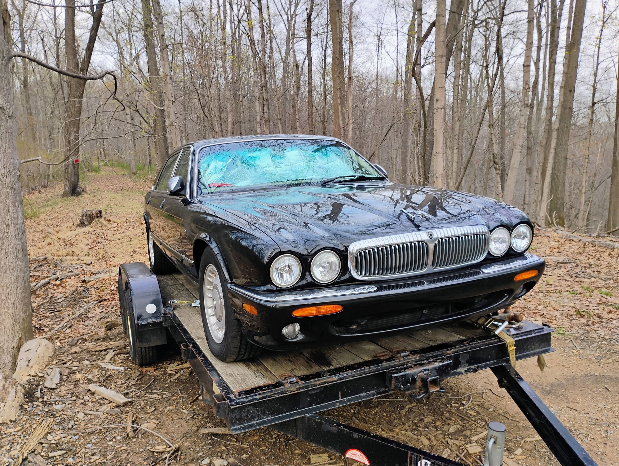

I just purchased this 19999 Vanden, in great cosmetic shape, 114 K miles for 1000 USD. Timing chain broken, engine damaged. The plan is to move engine and trans from the 2001 xj8 my son wrecked into it. I'm in over my head. Question, are the engine and trans interchangeable between vehicles?
Old Apr 9, 2025 | 10:24 AM
  #5335
Philip_A's Avatar
Joined: Apr 2024
Posts: 272
Likes: 130
From: Larose, LA
Engine swap, minus transmission is the easiest by far. With a few choice words and a bit of a stretch you can swap the engine without even having to take the hood off. Aircon will need regas. Suggest doing the oil gallery seal and rear main when you have the engine out.
