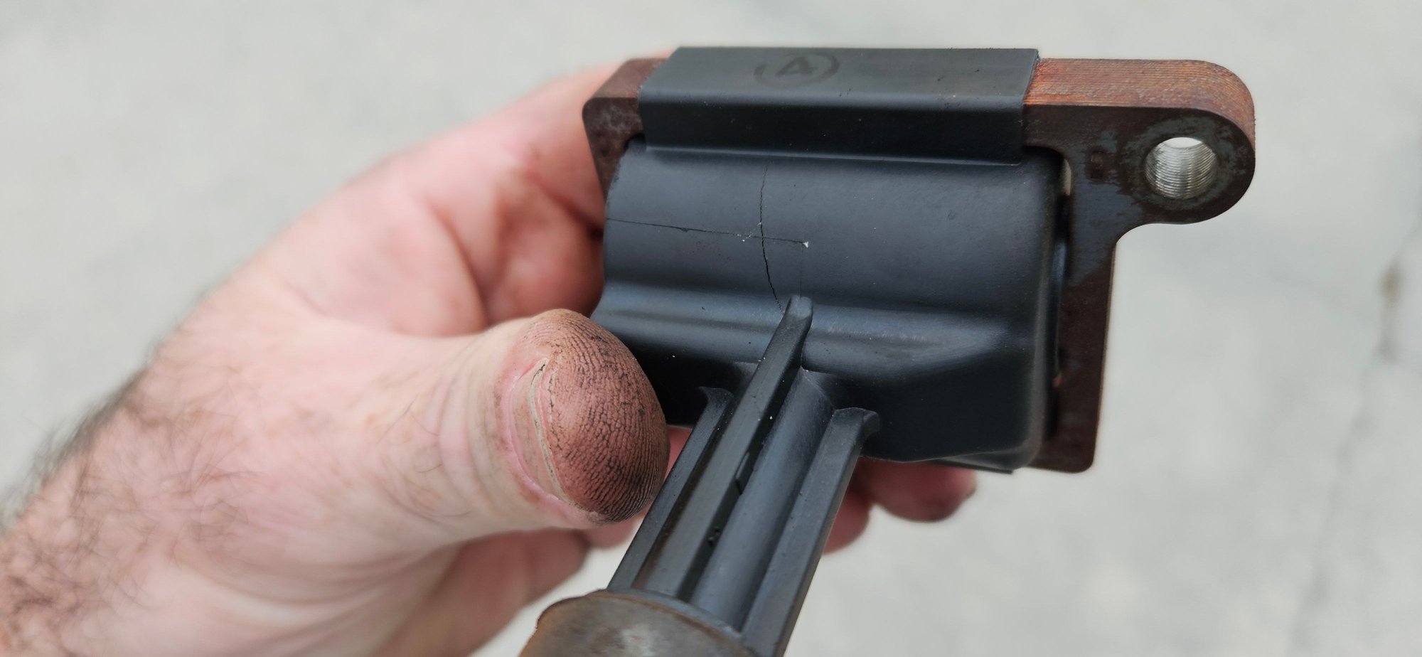

Never a dull moment with this car.
Driving home, after a 20 mile trip I get a real nasty misfire at low RPM.
Pull out the scanner and plug in.
Cyl 6 misfire
Injection system fault
Misfire bad enough to cause damage to calayst
Pulled the lid off the left bank and pulled the plugs. One's a bit darker but mostly looks ok. Swapped plug positions. Misfire #6.
Swapped the coil packs. Misfire #7.
Replaced coil pack. No fault.
Yup. That's cracked. Bin.
Back to smooth motoring again.
Phil

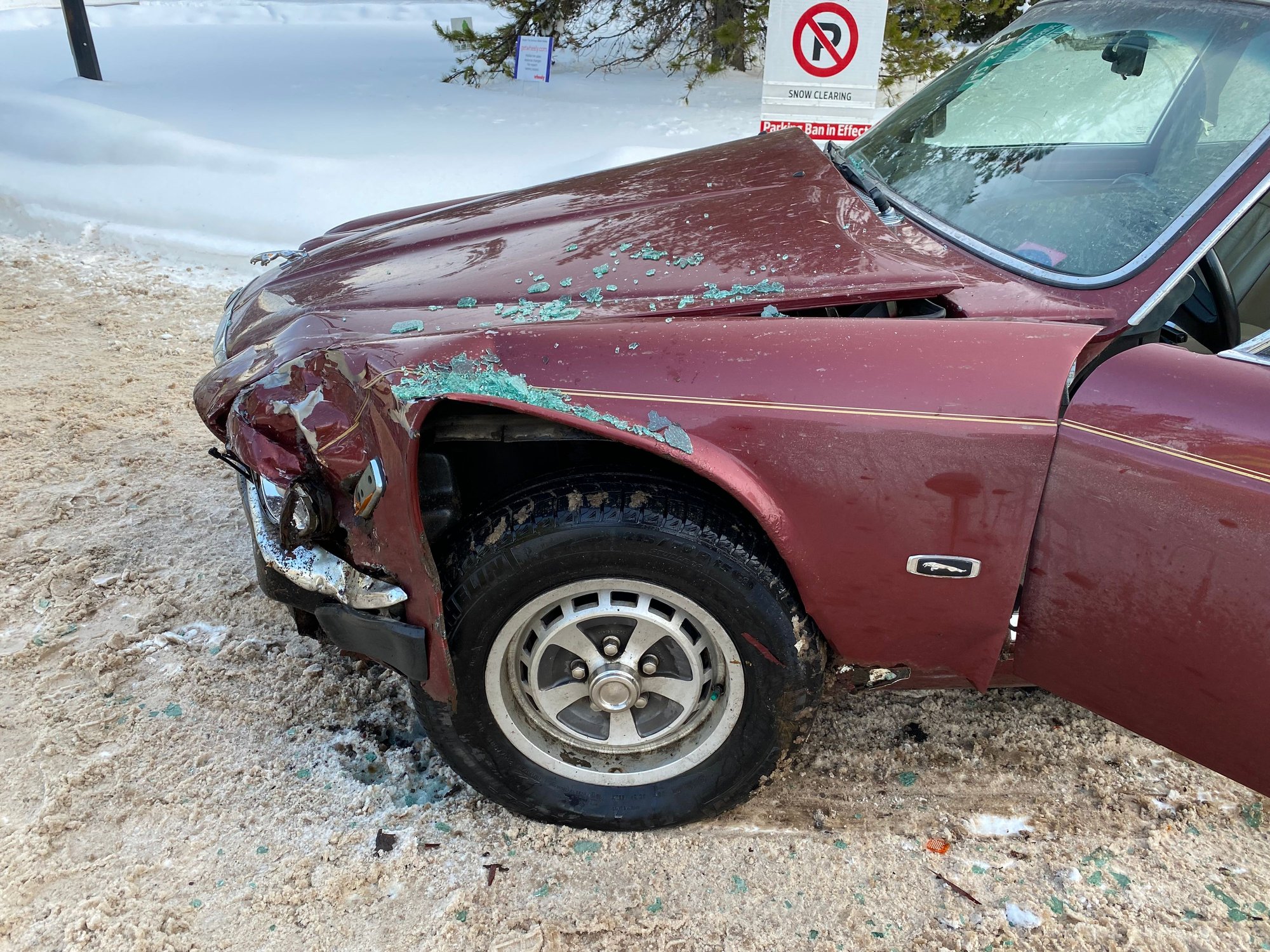

This was the car the XJR replaced. She had been my daily driver for 15 years. I tore a rotator cuff and my wife suffered a fractured sternum - we finally settled with the insurance companies last month after three years.

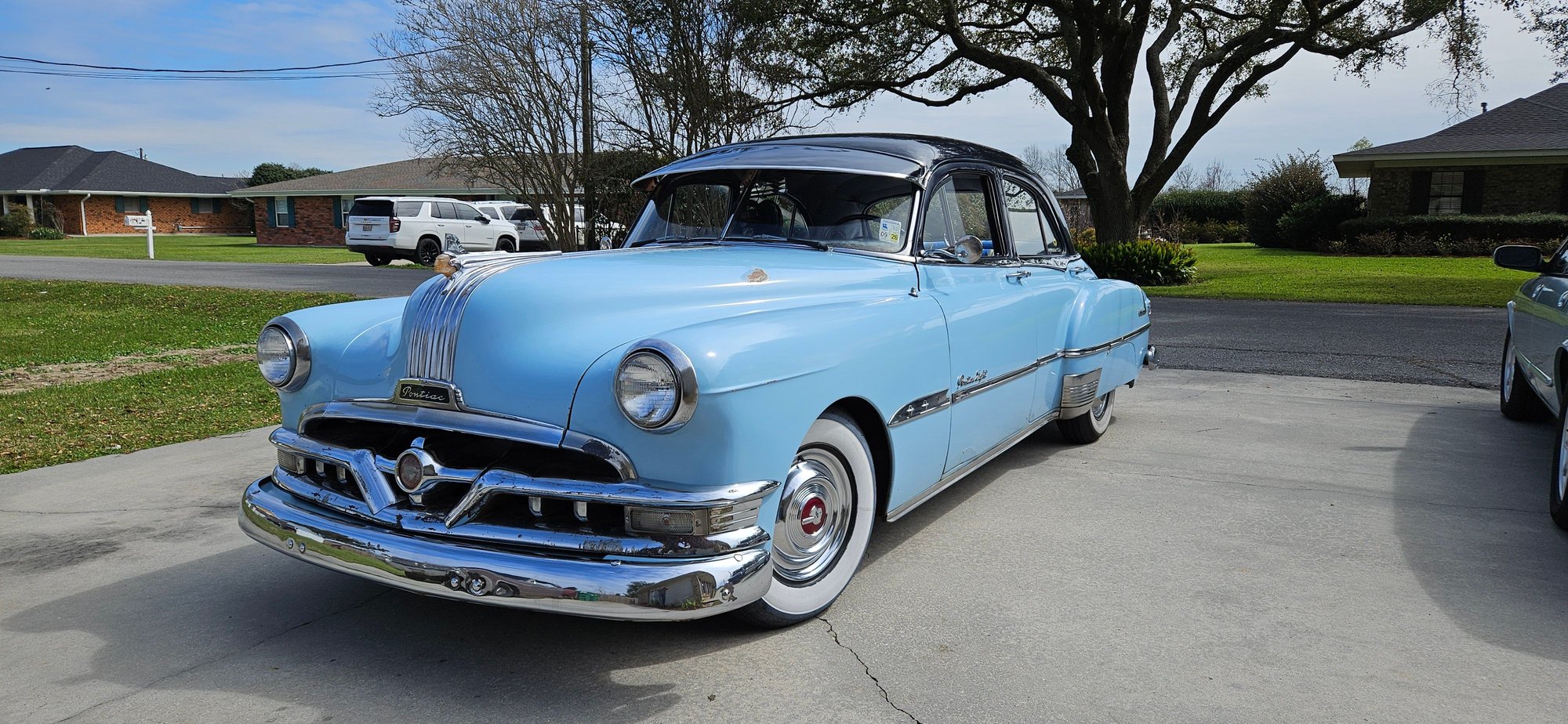

Thanks! While perhaps "off-topic" you'll have to post a photo of the Chieftan - the first car I owned was a '52 Pontiac.
Old Feb 23, 2025 | 02:15 PM
  #5298
Philip_A's Avatar
Joined: Apr 2024
Posts: 288
Likes: 140
From: Larose, LA
It's not a Jag, sorry. By request:
Phil
