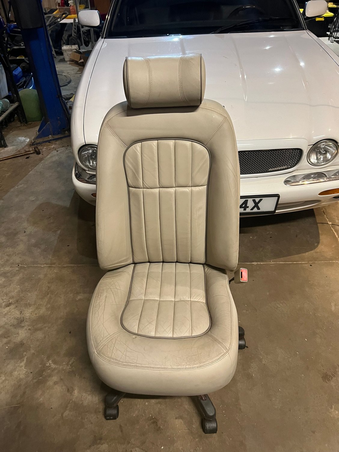

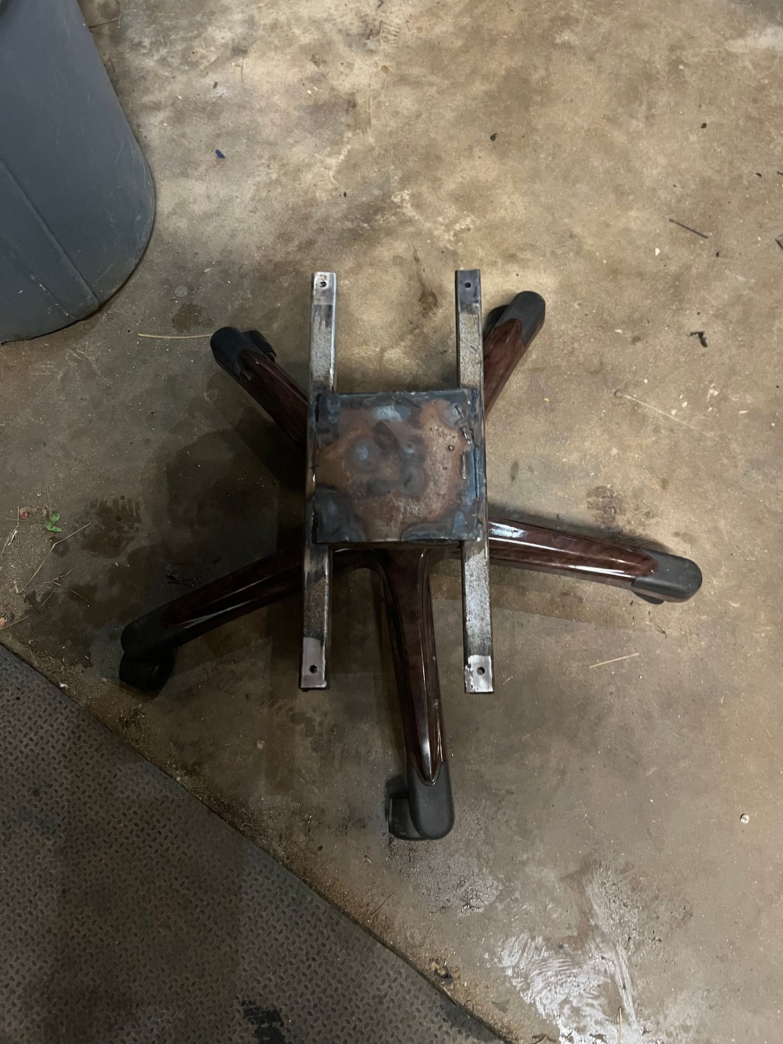

Had a base from a broken office chair and a left over seat.
Nice, now your buddies can properly relax while you suffering under the car
