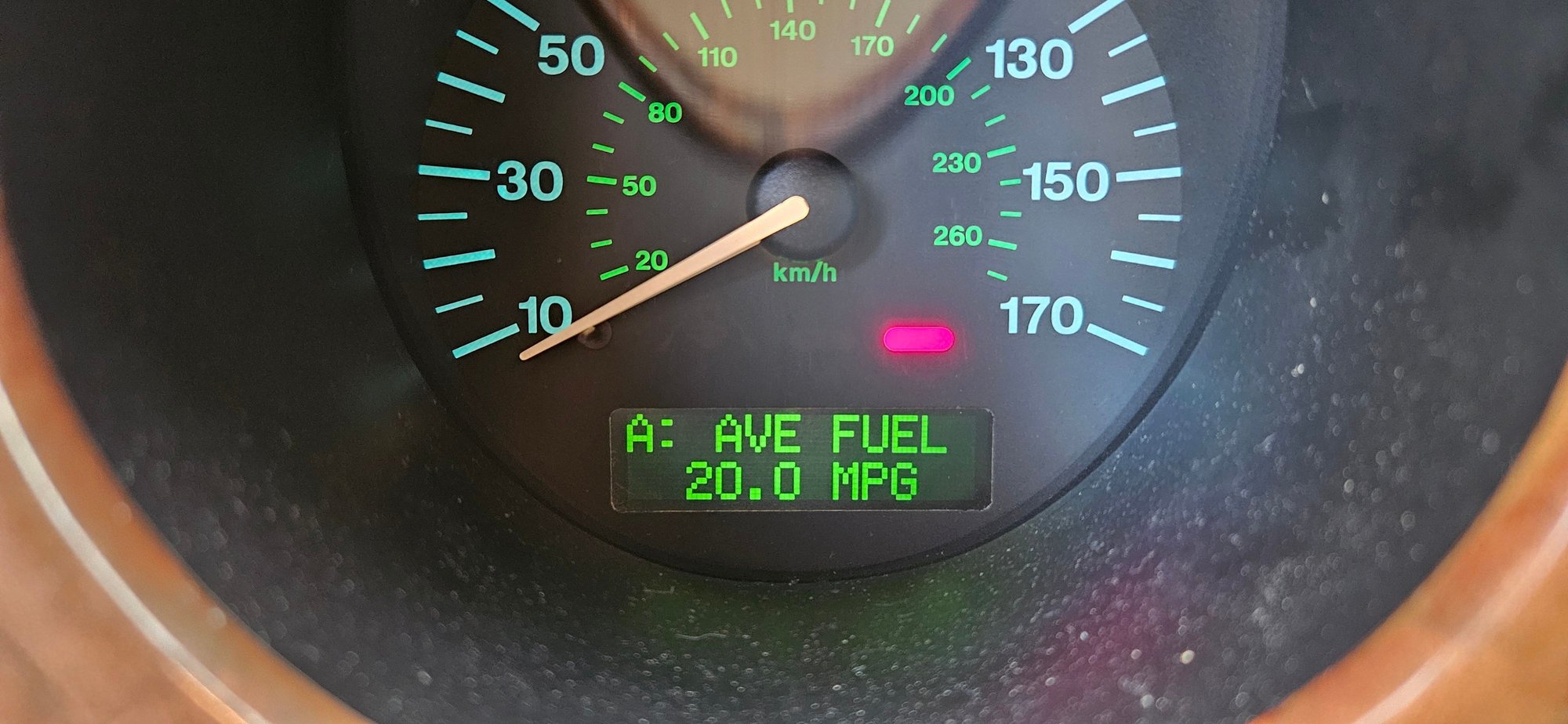

Ordered a set of new rear shocks. New Orleans downtown roads about killed these completely today.
Happy with that as combined mileage though.

I accumulated 100000 miles on my 2002. Happy Day

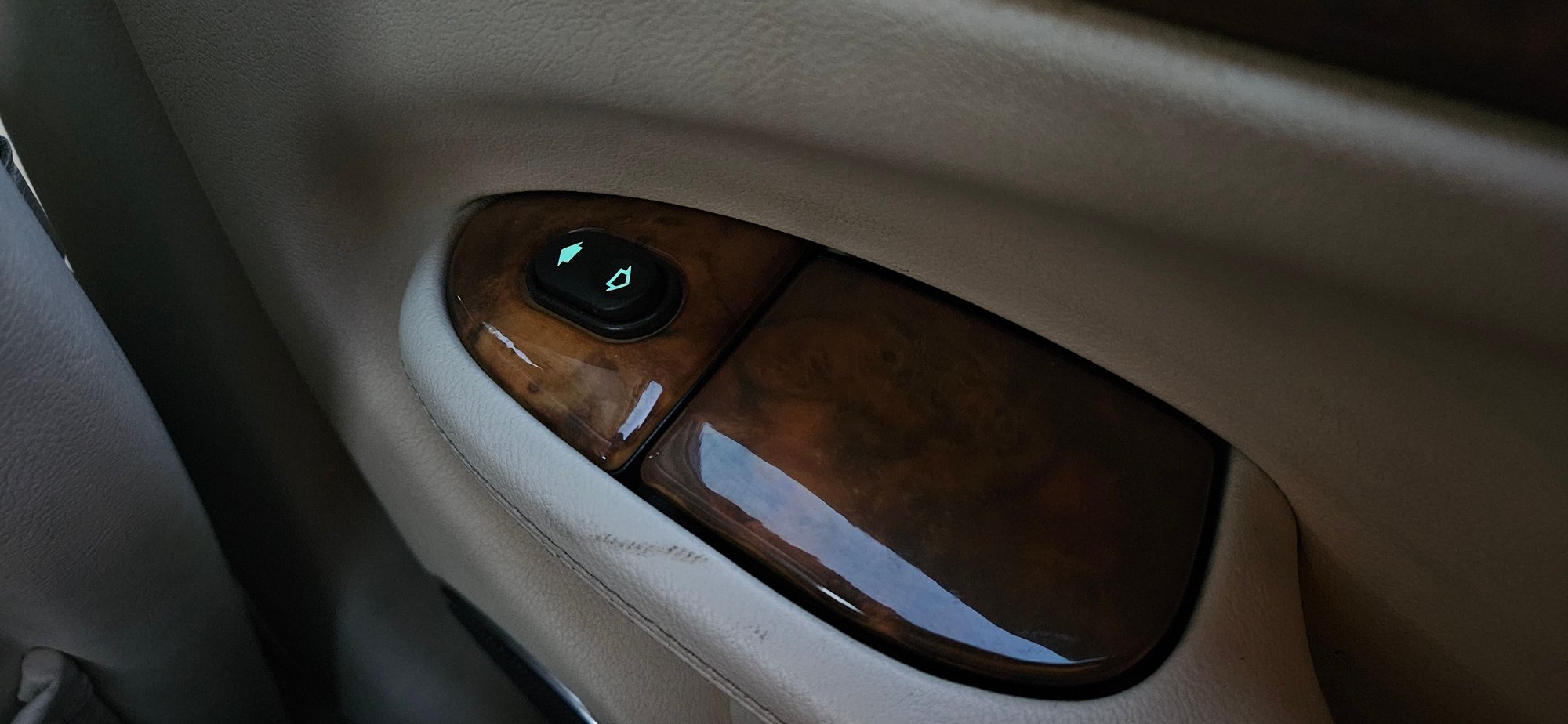

Repaired the rear window switch illumination on both sides.

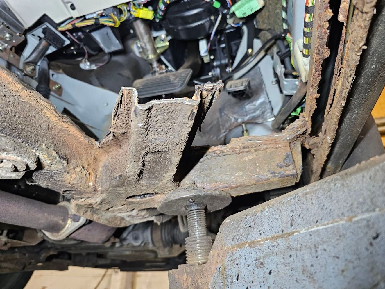

I got sent lots of pics by the bloke running a sparkly stick over my XJR.
"oh 'eck" was the rough phrase I used... as here's one example & the driver's side seemed solid when I'd looked, the passenger side jacking point moved when I jacked the car up & that's why I took it in. I just asked them to check this side in case. So much for thinking the MOT would be cheap this year....

Hooli, we’ve had other past members in the rust zones that had welding performed on their car and then the electrical issues started showing up. This might be too late to mention but, I’d have the battery disconnected along with module’s unplugged. Just a thought.

Cheers for the warning. I believe the battery is disconnected, but not sure on the modules though. He has welded this car before without any electrical issues, so hopefully follows safe enough procedures. I'll find out Tuesday as it's due to be finished then.

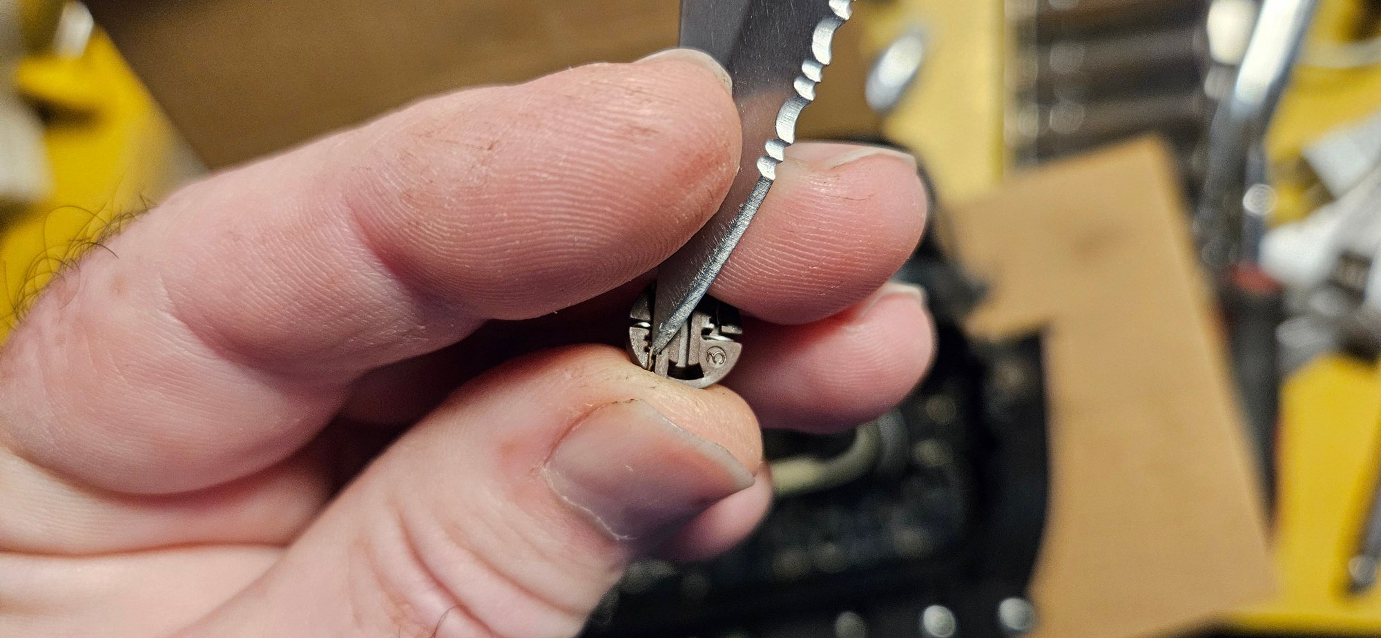

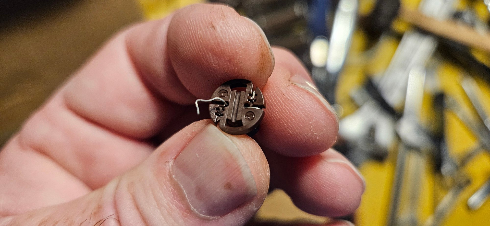

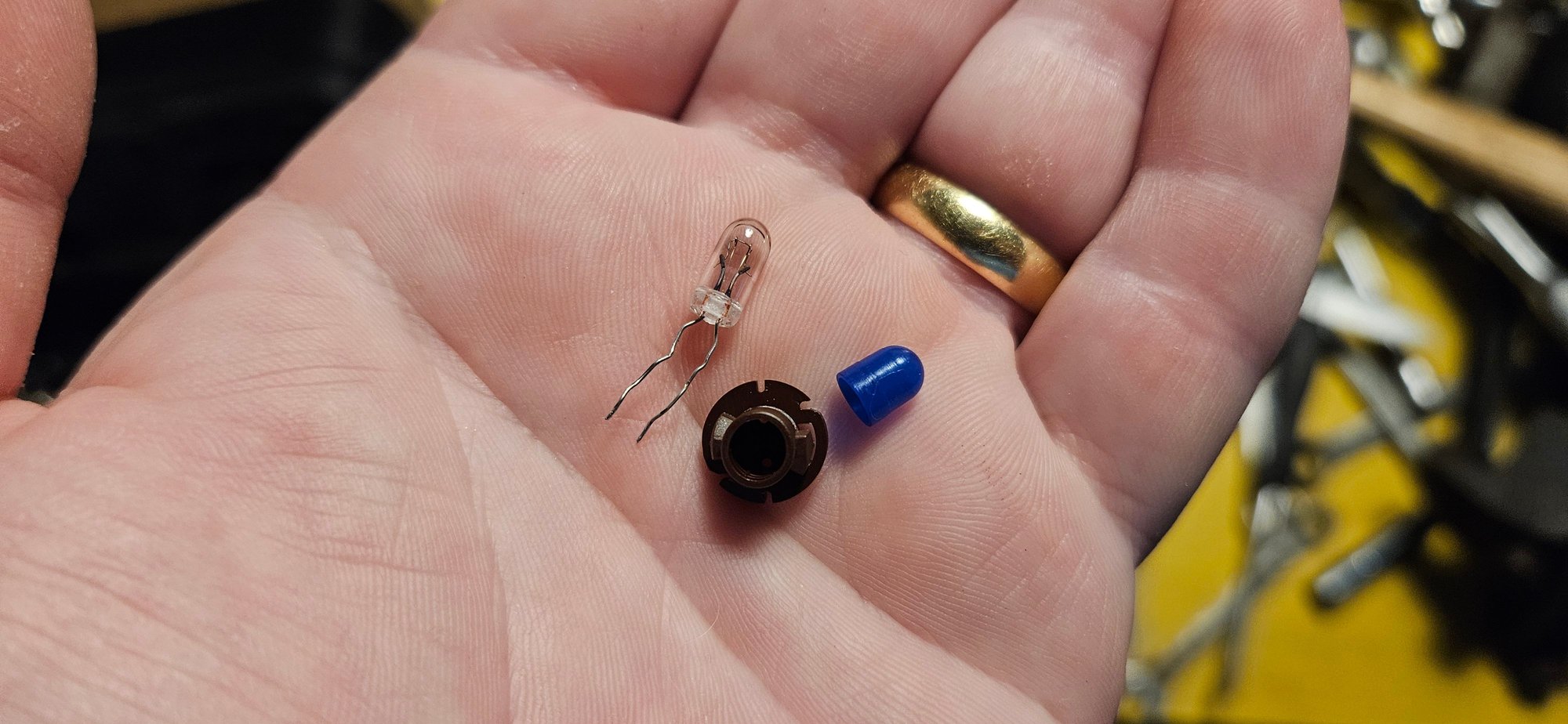

The diaplay panel takes 2 1.6w pea bulbs. I bought the bulbs themselves, you pull the holder out with a flat blade screwdriver, then you can un-thread the legs and feed a new one in the same way.
I ordered a box of them on Amazon. Search T3 grain of wheat bulbs.
T2 0.9w bulbs do work but they are a bit dim (those are for the buttons)
Undo the two screws on each side, squeeze the plastic in and the back pops off. Remove the clear plastic film. The two brown bulb holders are for the screen.
​​​​​​The bulb assemblies twist counterclockwise and then pull out.
There's 2 crimps holding the tail of the lead in. A sharp edge can pick them out (just pressed in)
The leg unfolds.
The blue cover just peels off with care. Replace with a new bulb, legs cut to the same length and reassemble.
