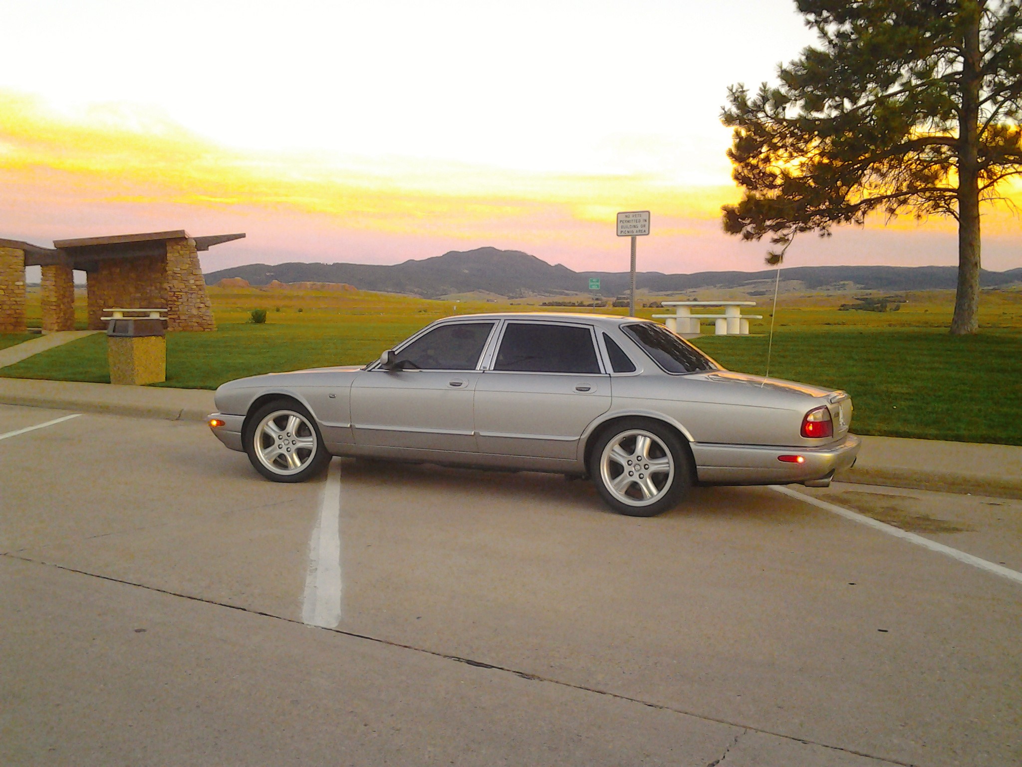

Default finished 12,000 km trip
Just got home from a 12,000 km, 6 weeks trip with the Jag.
Picture from a rest area in Wyoming , gotta love the 80 mph speed limits ...
