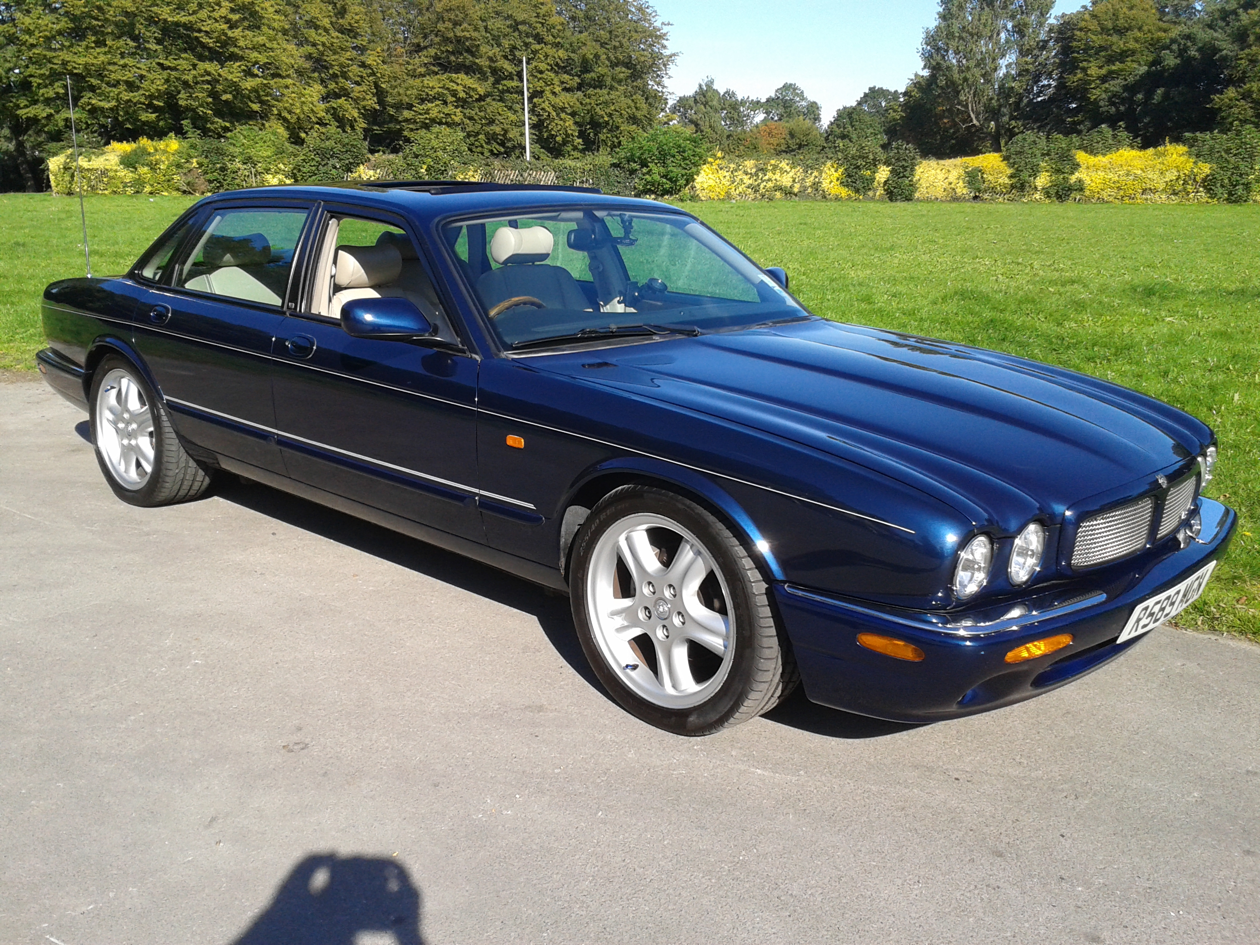

Got the old clay bar kit out, did the paint work and then gave the old girl a coat of Maguires Tech Wax 2.0
