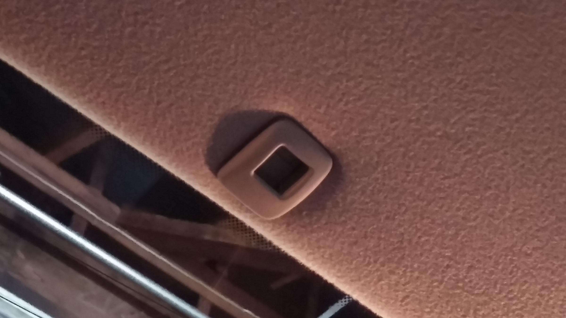

What are these? They're located in the back where the headliner meets the window. Almost directly over the headrest. Is it sensor of some sort?

Aren't they the latching points for the optional manual rear blind?

Here is a jpeg of the sunblind parts - grandell is correct:
Shows the sunblind retaintion bezel assembly also rear support bracket and the backlight glass sunblind single kit
You can view this as a larger image - by right clicking on image and choose open link in new tab, then go to new tab and click on image

My understanding is those were on all the cars, sunblind or no. They also served as a fixing for the headlining to prevent sagging away from the backlight. The front sunvisor clips actually serve to do the same at the front.

Here's a tiny mystery- my 98 XJ8 has a one piece rear blind, but my 98 XJR has two separate blinds.

The JTIS calls them - headliner retaining trim in the headliner removal/install procedure:
Nothing mysterious about it.
The cars with the standard/base sound system have a 1 piece blind and the Premium equipped cars, due to the extra subwoofer on the parcel shelve, have the 2 pieces blind
