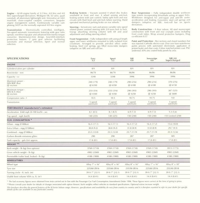

XJR's came with 18x8 wheels with 255 40R18 tyres, so this will be fine. You could always go smaller, but IMHO 18's look great on these cars (although personally I would love some 19's)
the jag-lovers forum has a brochures section that has lots of information too... this page was from the '01 model year, but it's still applicable to your car
